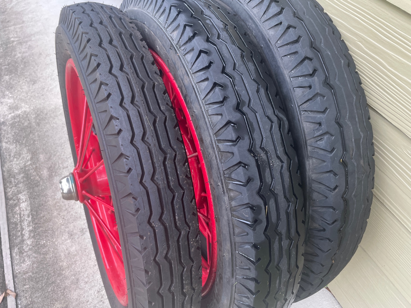

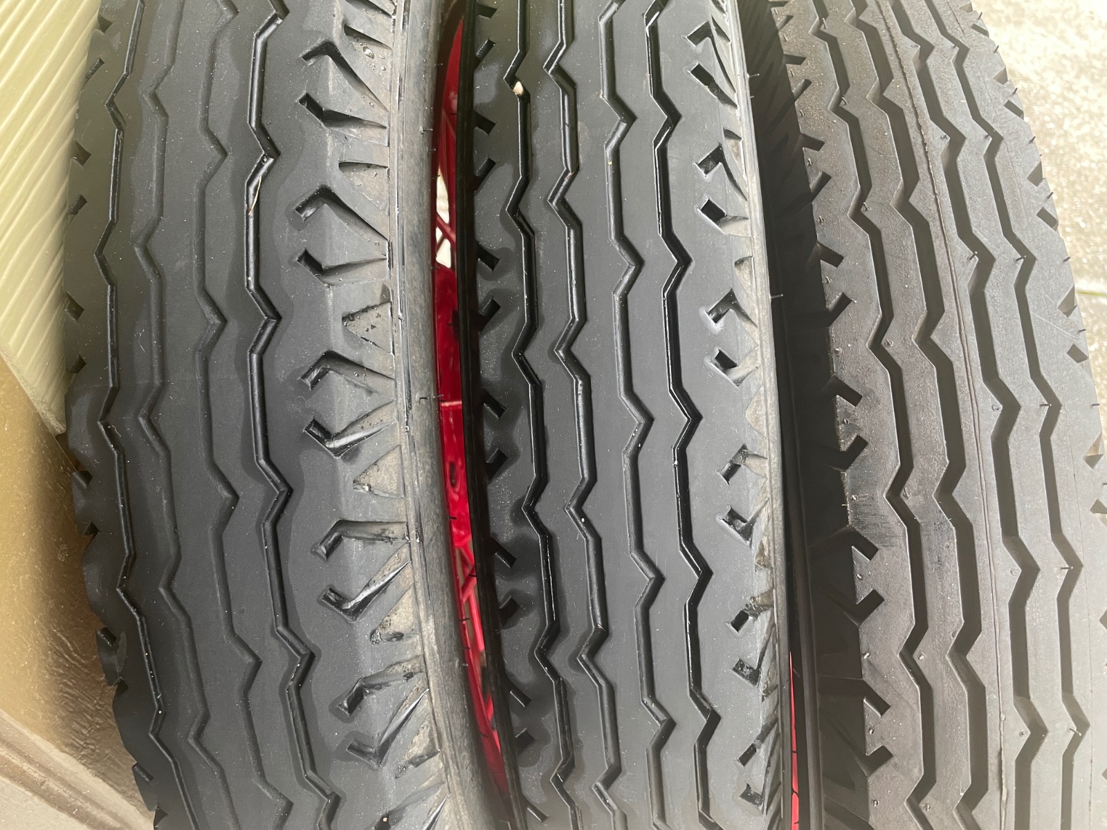

Put these 21" 4.50x4.75 Universal tires on the '27 touring in March 2019.
So, 5 years later a bit of tire wear, lots of tour season miles. The worst one on the left is from the right rear, likely from fast acceleration, or perhaps braking hard ;) The middle is a front tire, and on the right is the spare is as new 2019, hasn't been on the pavement.
Replacing with the same 4-ply, Nylon tires from Universal.

Front tires can wear fast if alignment is off, low pressures, high pressures, or wheel balance if wheel isn't round.
The heavy wear on the one tire, is from rotating, was on the front at first and then a few years ago, was placed on the left rear. That could have hastened my tire wear. Anyway, tires do wear, and better tread is best for safety.

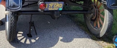

I have 30 x 3.5 inch Universal Clinchers. The right rear shows the most wear of all the tires and will be replaced shortly. All tires have balance beads in their tubes. I'm going to replace both rears which will leave me with a couple of decent spares after I discard the right tire. The fronts should get a couple thousand more miles before needing replacement. I have a little over 11000 miles on the tires at this point.
Maybe you can see what I'm talking about on this photo. the center tread is almost gone on the right tire.

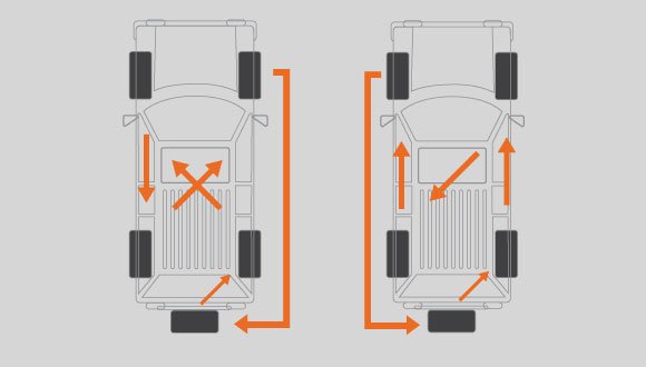

Found this on the web. Jim
