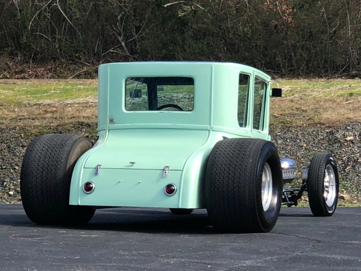

Here’s a 27 T that’s been ‘overtinkered’ to be something that it’s not. The picture tells the story. Thanks Rich for reminding us about tinkering.
