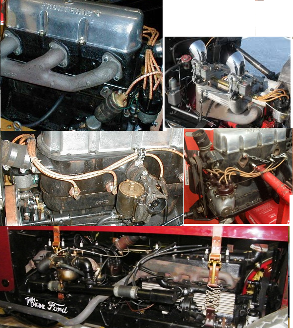

My preferred dizzy set up is a Bosch front plate with an early iron 009 replacing the shaft full length. Self built set up.
The Thomas cam gear is held in place by wrenching tight. Look very closely @ the upper shaft bushing. They are usually very worn & will effect ign. performance. I had one ready to install on my 14 until I figured out how to make a stock system perform.

To answer your original question, a Bosch front plate is the best. Especially if you find one with an original Bosch head, instead of the 009 one. Expensive though. Probably best to leave the ignition as-is, run it off 6V, and include a rebuilt mag coil ring with the sale of the car. I ran my T for several years on coils and 6V. It ran great and did everything I asked of it.

I believe if you want a distributor go for it! Just build it right. If you want a magneto build it! Also do it right.
Do your research, both have been proven and Both can be enjoyed
If the OP would like to press on I am sure whatever route they take the knowledge of the MTFCA will be able to figure it out.

Do what YOU want to do to keep it running and happy. Lots of choices from simple to complex (and potentially expensive).
Early on when I was new to Model T's I struggled with stock coils and timers and got frustrated. I just wanted to be able to drive my car (25 touring). After getting stuck on a tour and getting help from many folks, I opted to go with what I knew. Growing up working on cars from the 50's and early 60's I understood distributors and got a Rader conversion. This was in the mid 80's and that distributor is still working fine on that car. Points and condenser have been changed but it has never failed me or the new owner.
I tried again with rebuilt coils and an Anderson timer on a '26 coupe. It was OK but after a couple years the coils were no longer up to snuff. Replaced the car with a Model A that was more comfortable.
For 30 years, I've been using a Rader style distributor on my speedster. Works fine but I did have a coil fail one time. Quickly replaced at O'Reilly's.
If you plan to tour like I do, carry spares for whatever ignition system you decide on and keep it tuned up. I learned in the '60's to replace points and condenser at about 10K miles. That old lesson still works and means every 3 or 4 years with my cars.
I own a T to drive and enjoy, that works for me. Do what works for you and have a good time.
