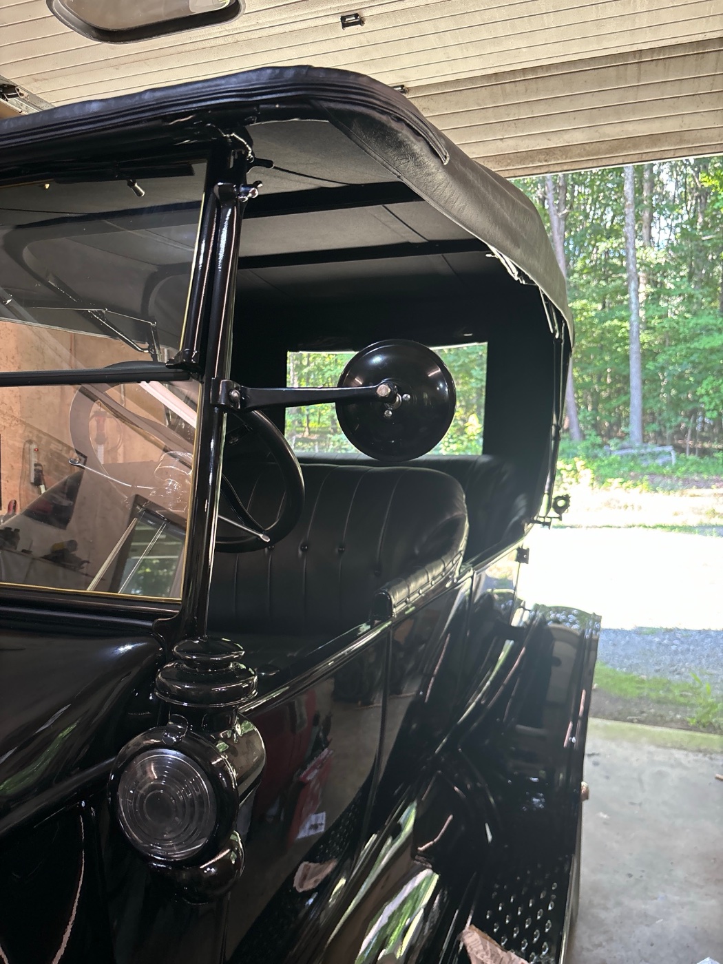

Installed one on my 1918 touring car. After years of frustration with a mirror from Lang's, this one worked fantastic! Stays in position and isn't vibrating so bad you can't see traffic behind you.

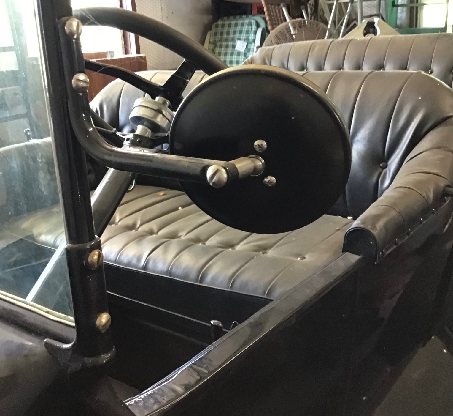

The open windshield mirrow I bought for my 21 Touring is not stamped steel but a piece of 1/2” piece of steel rod that attaches to the windshield hinge bolts and does not clamp on. It’s rock solid and a really stable mirrow. It bolts on like the one pictured. If I remember I bought some longer slot head bolts to attach it. Snyder’s website says they are temporary out of stock on some models of their rear view mirrows

Don, I have two of the mirrors in question - Like you I've tried the clamp-on type and been unhappy with them. What I can say is that these shake the least of any mirror I've seen. I am very happy with them.

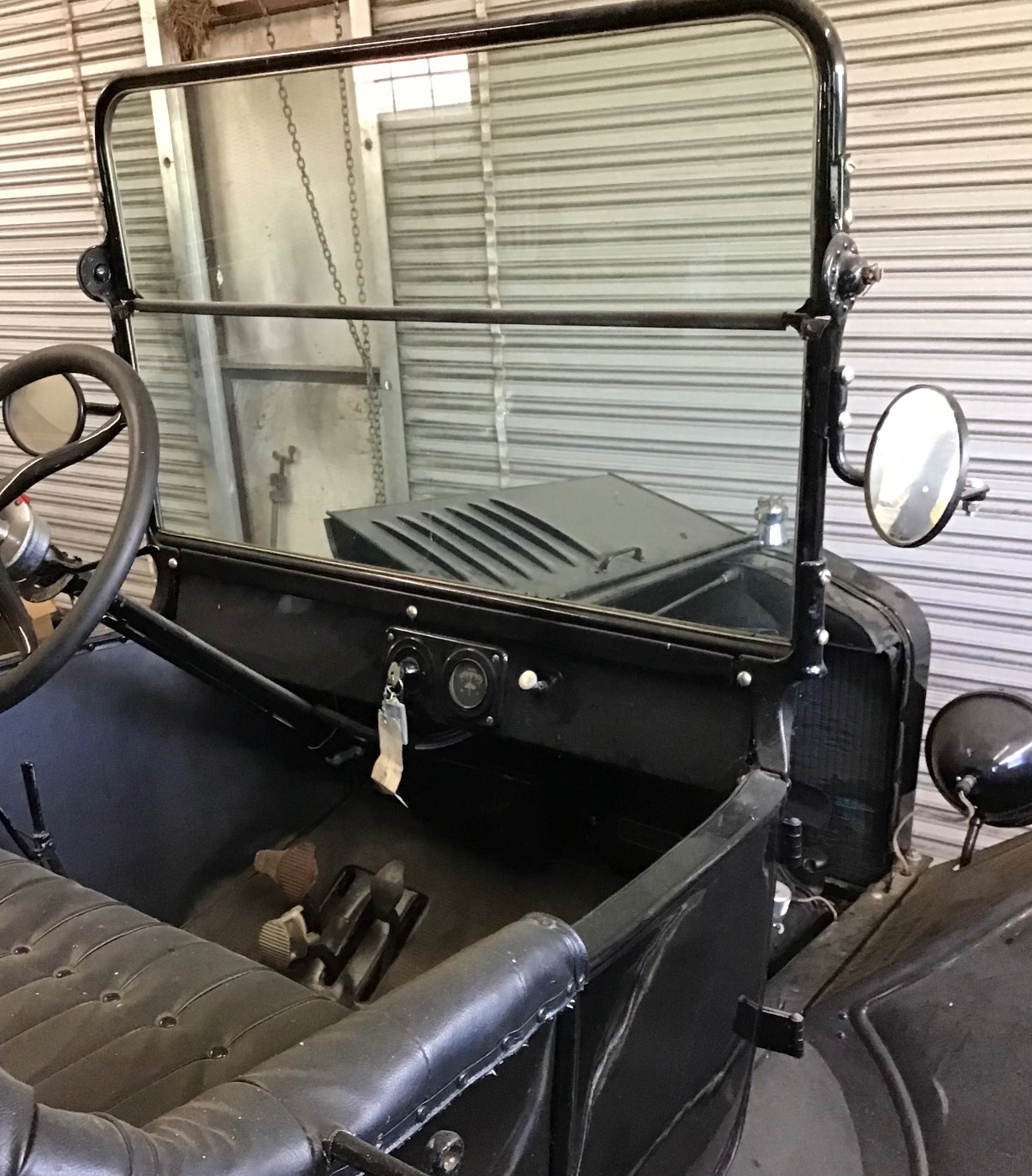

Get pair of those mirrors, they fit great on '26-'27 stanchions, two of them work well on the touring, after adding just a tad more length to the arm with a strap of steel, for clearing the windwings. ;)

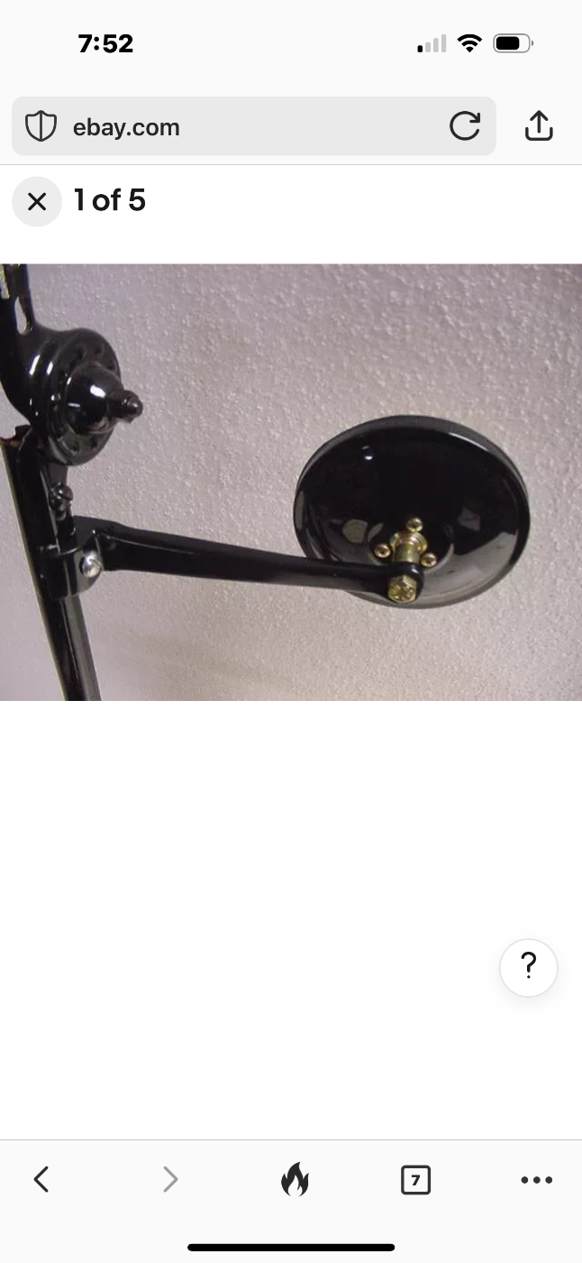

I've emailed the guy who makes the mirrors in question and will report back if he replies. One listing I found says "Permanently Closed" so we may be out of luck. I also found this listing for an ebay store - worth a try. <https://www.ebay.com/str/antique-t-motor-sports-llc> If he did quit business perhaps an opportunity for another entrepreneur.

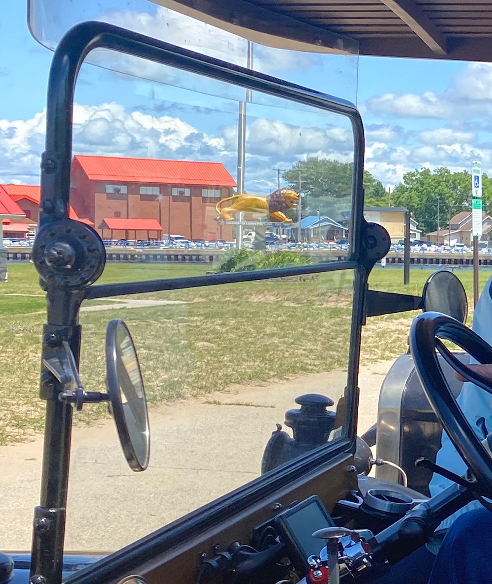

FWIW, a friend of mine made his own mirror mounts by splitting a piece of tubing that had an ID that conformed with the windshield, welding a piece of tapered piece of flat stock and a gusset to it and voila! A nice, firm, mirror mount. He's building a Depot Hack body so he made them a little longer.
If I were to build such mounts from scratch, I'd make the arms a little longer too. When I have the top up on my touring I don't have as clear a view using them as when the top is down. Of course, it was worse with the clamp-on types. They had even shorter arms. I compensate by having a Model A type mirror strapped to the spare tire which rides on the left hand running board.
I've attached a photo of my friend's home-made solution. They certainly were a lot cheaper than the ones under discussion.

Here’s the stable mirror mount I got from Snyder’s for my 21 Touring. These you buy the mirror separate. Snyder’s has mirrors also. I got their 5” mirror to match the one I already had. The one I had was the one that was in my Grandfathers Coupe I inherited. I’m glad I saved it when I did. I think of him when I see it on the car. I got the correct mirror for the 24 Coupe when I restored it several years ago. https://www.snydersantiqueauto.com/sear ... cht=Mirror
