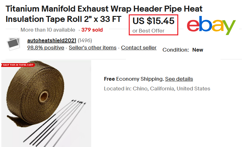

There’s a very pliable exhaust wrap found at any auto parts store. I’d try to wrap several times around the juncture of the pipe and cast muffler inlet. Maybe secure it with hose clamps. I also think the wrap will somewhat solidify with heat…

I do have a floor mat in the back. I got it from Home Depot for about $10 and it fits well and looks almost like the original. I also have a tailpipe that extends from the back of the muffler. I did think about the header wrap. I think that option would allow the car to flex and the pipe to move in and out and twist as I drive.

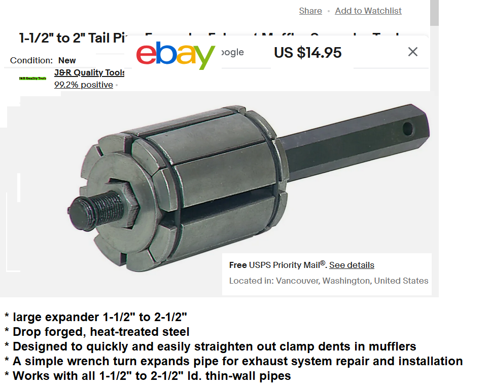

Another alternative to exhaust wrap, to to expand the end of the pipe going into the muffler, just slightly enough to provide a snug fit in the muffler inlet. Pipe expanders that expand by turning a bolt in the middle of the tool are available, but it you don't want to buy something that you may use only one time, take the exhaust pipe and the muffler to a muffler shop. Their pipe expander can expand your outer pipe diameter, just enough to be a snug fit in the muffler inlet.

Exhaust wrap needs heat to cause it to cure & since your on the muffler end yoy could heat up the tailpipe with a propane torch.
https://exhaustwrap.online/blogs/news/s ... erformance
Step 8: Finishing Touches
Once the exhaust wrap is securely in place, you can use heat-resistant adhesive spray to further seal the wrap if desired. This step is optional but can provide added protection against fraying and moisture.
Step 9: Drying and Curing
Allow the exhaust wrap to dry and cure. Start the vehicle and let it idle for a few minutes to help the wrap adhere and set in place. During this process, some smoke and odor may be emitted as the wrap adjusts to the heat.
https://www.ebay.com/itm/284584282708?_ ... BMoqeOwapk --
Pipe expand-er https://www.ebay.com/itm/303761291335?_ ... R66rzsCqZA --
