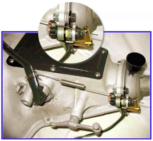

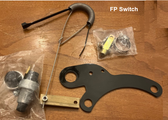

NO seems to be the consensus. Discussed before with alternatives & pictures of solutions
viewtopic.php?t=28117
viewtopic.php?t=41419
https://www.cool386.com/brake/brake.html
FP switch parts

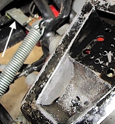

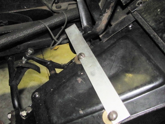

Bill
If the strap over the tranny cover is cumbersome for you, try the other style of push-button switch at Lang's, no holes, and attaches to the frame rail. I use both and think these styles are even better than the Fun Projects that has the return spring to the brake pedal and the bolt on u-joint bracket.
Lang's Strap type:
IMG_7133 (550x413).jpg (123.57 KiB) Viewed 2320 times
Lang's Frame mount type:
IMG_2337 (600x450) (580x435) (570x428) copy.jpeg (92.03 KiB) Viewed 2320 times
Many parts to mount with that Fun Projects, the spring always gets stretched too much, or slips at the wire clamp screw, operates intermittently in my use.

That kit was worth the price for the bracket alone.
