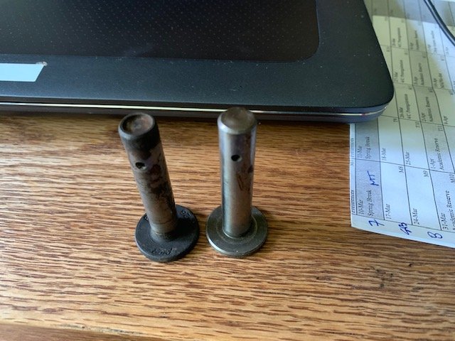

Were some lifters made with a dip on top that makes it more difficult to set the valve clearance?

Lifters with the dip on top are candidates for the million mile club. That dip is wear. Beaten down by the valve stem. They need replaced.

They need replacing.
