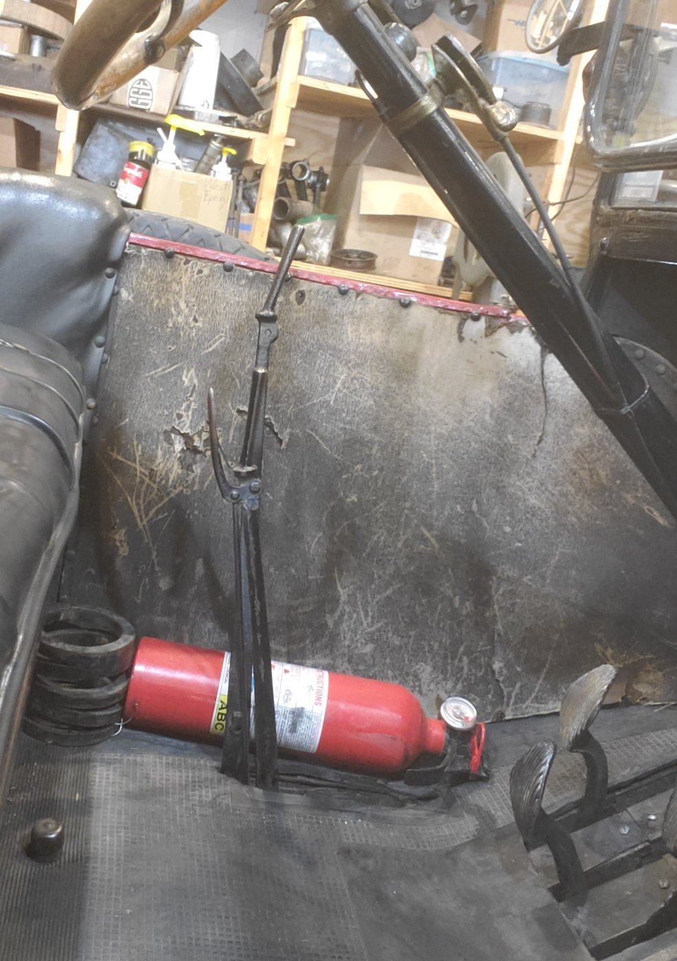

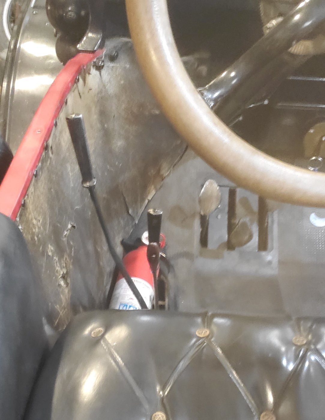

Advice on Shifting a Ruckstell
I'm shifting my newly rebuilt Ruckstell pretty well. But looking for experienced methods of shifting from Ruckstell High to Ford High. Advice?

I've had 3:1 in a '26 Ruxtell and Rockys in my '15 Touring for 25 years. Its my daily driver 8 months of the year. Yes, its a Mid-West Flatland T because thats where I live. Every day I lift the crank. That Ruxtell makes it such a joy to live with.
I made a left shifter from a p-brake lever with pillow blocks on top of the frame so the lever comes up thru the very rear of p-brake slot, and extends above the "door". Its very comfortable to get to without reaching too far.
I start off in Ruxtell low every stop. Get to Ford hi and wound out, I blip the throttle closed and open at same moment I push lever to Ruxtell hi, No Clutch. It just slips in.
Coming to a sharp turn, or up hill, or to a stop, I tap the clutch as I pull back to low. Thats it. I shift up and down same as manual trans, every curve and every rise. Makes life a joy.
And I truly cant imagine why anyone would run a Ruxtell with the early non-sprung shifter assembly. Those assemblies are interchangeable. Ruxtell changed the design for a reason. So many people have got hurt. That spring keeps it in gear! Even then Ive down shifted a few times on a hill pulling and it slipped in between for a moment. All the early assemblies should have been destroyed.

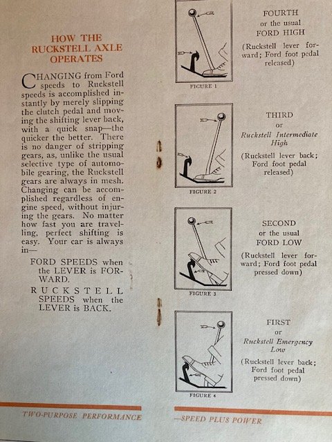

The ruckstell instruction book refers to the 4 speeds you have with a ruckstell equipped car as follows
1 being the lowest and 4 being the highest
1. Ruckstell low (Ruckstell shift lever pulled back and transmisson in low)
2. Ford low (Ruckstell shifter forward and transmission in low)
3. Ruckstell high (Ruckstell shifter pulled back and transmission in high)
4. Ford High (Ruckstell shifter forward and transmission in high)
Using the terminology from the Ruckstell book, the terms Ruckstell and Ford refer to the position the Ruckstell shifter is in. Ruckstell means the Ruckstell shifter is back and the planetary reduction gears are in operation.Ford means the shift lever is forward and the planetary reduction gears are not in operation. The terms low and high refer to what speed the transmission is in. Low the pedal is depressed and high means the pedal is released.
Using a combination of these words, the four speeds can be described. It's a little confusing but makes sense after a while.

From a Ruckstell pamphlet.
- Posts: 7287
Re: Advice on Shifting a Ruckstell
So, we have two standard Ford gears. Then we have two lower speeds courtesy of the Ruckstell. When the Ruckstell is engaged, it is in low.

From the brochure:
"Fourth Gear" = "Standard Ford High"
How do you get it? - Ruckstell 'high' (lever forward which is a 'direct' gear) + Ford high (pedal OUT)
Used? Normal road driving
Used most of the time
"Third Gear" = "Ruckstell Intermediate High"
How do you get it? - Ruckstell 'low' (lever back which is an 'under drive' gear) + Ford high (pedal OUT)
Used? Dirt roads, rougher tracks, maybe slight uphills on paved roads, whenever you feel if works best for you.
Used often
"Second Gear" = "Standard Ford Low"
How do you get it? - Ruckstell 'high' (lever forward which is a 'direct' gear) + Ford low (pedal IN)
Used? Starting off, heading up (steep) hills
Used 'normally'
"First Gear" = "Ruckstell Emergency Low"
How do you get it? - Ruckstell 'low' (lever back which is an 'under drive' gear) + Ford low (pedal IN)
Used? Really heavy loads up hill, up a long and/or steep hill, whenever you feel the need for extra pull but this is SLOW
Not used much
BONUS
"Second Reverse Gear" = "Standard Ford Reverse"
How do you get it? - Ruckstell 'high' (lever forward which is a 'direct' gear) + Ford REVERSE (reverse pedal IN)
Used? Normal reversing
Used most of the time when going backwards (I hope!)
"First Reverse Gear" = "Ruckstell Emergency Reverse"
How do you get it? - Ruckstell 'low' (lever back which is an 'under drive' gear) + Ford REVERSE (reverse pedal IN)
Used? Reversing up hill, with a load on or when you just want to go slowly (into a garage for example)
Whenever you need that extra low down power
Now for some real fun - with the overdrive in my TT I get 8 gears forward and 4 reverse:
Oh never mind it got a bit complicated to explain them all .......

This is my understanding---Leaver pulled back = You are IN Ruckstell. Leaver pushed FORWARD = You are OUT of ruckstell. You are either IN Ruckstell or you are OUT of Ruckstell Then, HIGH speed and LOW speed are controled by the pedal.

You might as well just call it hi or low as Ruckstell is not a ratio but a brand name.
- Posts: 7287
Forgive me Stephen. I did not realise that Ruckstell high was when the axle was in low!

Thanks for everyone's input, though I think it got kind of silly.
From the explanations and opinions I determined that I was being a bit too shy with the shifter. I have settled in on running up to about 28 mph in Ruckstell with the pedal up in high gear...then reducing the spark, moving to neutral(ish) and popping quickly into Ford gears.
This is working well, sometimes very smooth, sometimes a little noise, but not having problems with the shift anymore.
