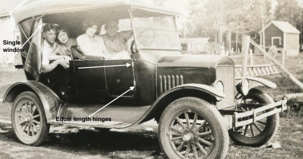

Here is simple way to i.d. the 1925 model year Ford. Single pane rear window. Equal length hinges on the front door., '24 and earlier have longer length lower door hinge.

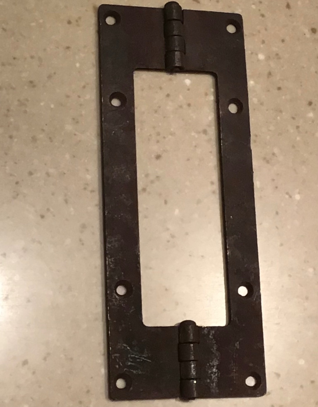

Here’s a 25 door hinge to look at closer opened up. You can see that it’s straight as Dan says.
