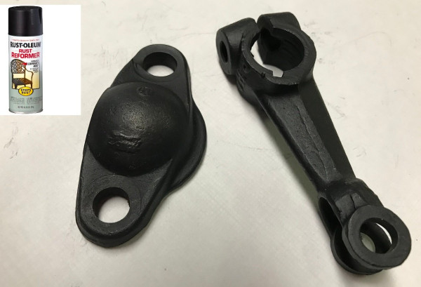

From a discussion in the Ford Barn
It looked similar to black oxide finish common on today's tools, but was not as durable.
Brattons says this about it:
The so called “Raven Finish”is a dark dye mixed with oil. This is a temporary finish and will begin to rust within a few months after installing, unless it is sealed by spraying with a clear coat or painting black.
Eastwood sells a kit that makes a similar finish. Some guys dip a red hot part in dirty crankcase oil to get a similar finish. Some use flat black paint.
pat in Santa Cruz is offline
I used this and seems to match the description above. After it dries the surface has a powdery coating that wipes off to a black oxide like finish
