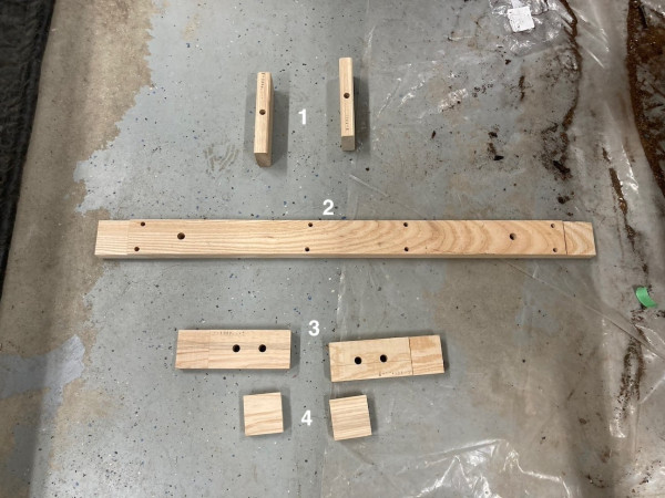

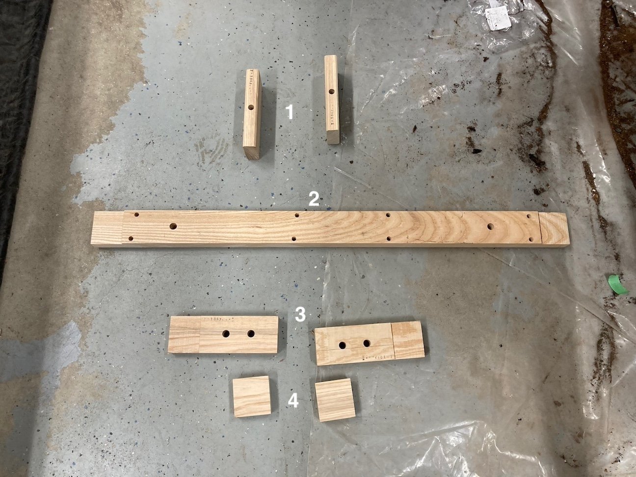

Good day,
I have an excellent wood block set to install on the 1927 Tudor but have some confusion with the pieces of this puzzle. No picture on the box so I don't know where all the pieces have a home.
Blocks #1 are fitted to the rear body mount location.
Long block #2 fits under the front seat mounts and has drilled holes that match the seat bracket bolt locations.
#3 blocks seem to want to be installed under the cross rail just behind the front seat rail.
#4 blocks are tiny things of mystery just begging for proper homes.
Does anyone have experience with locating these or perhaps is a real good guesser?
Many thanks,
Joe

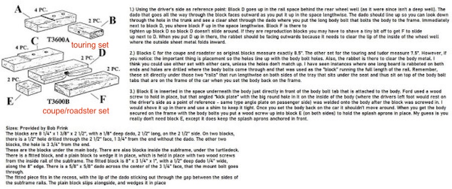

Post by DanTreace » Sun Aug 25, 2024 12:53 pm
This description of the wood for these body styles should help.
click image to enlarge

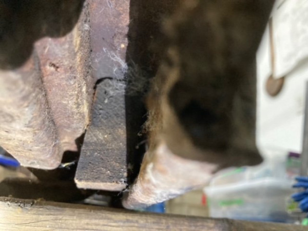

This little article seems to direct the tiniest block to somewhere near the front body mount. Interesting that the tiny blocks are anchor points for the splash aprons so that should locate the little blocks.
Here's one of the little blocks forward of the front body mount.

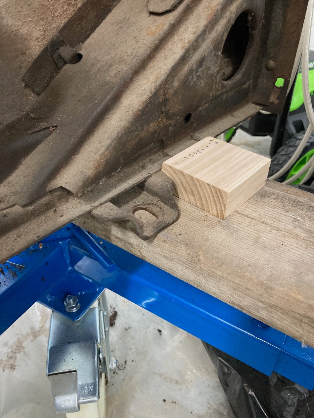

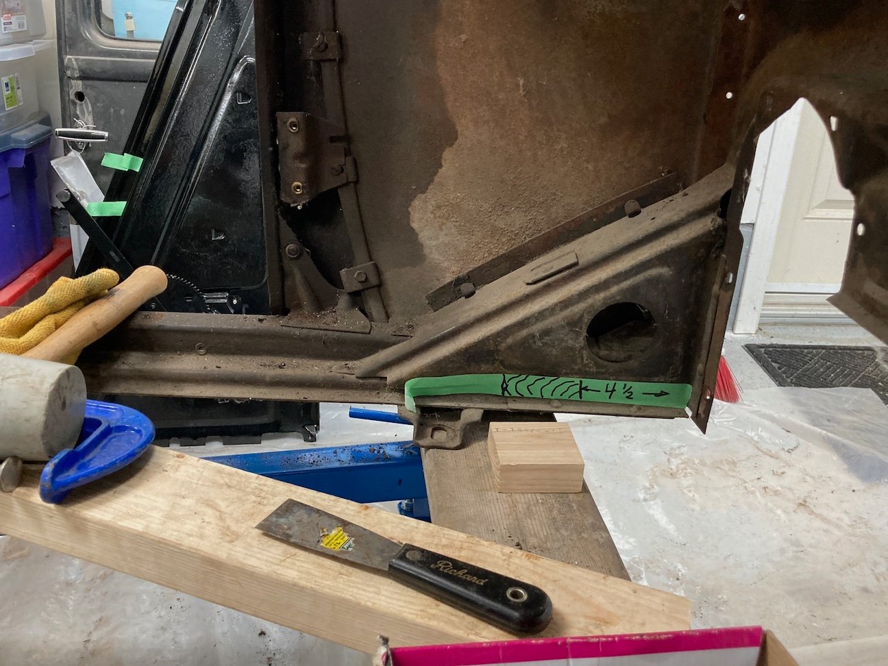

Post by Banjoe » Mon Aug 26, 2024 3:17 pm
The pictures didn't get added to my previous post - sorry about that.
Here's the original block and the measured location ..
