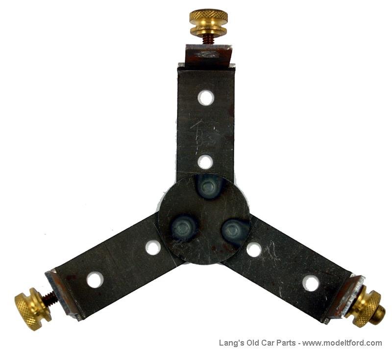

When mounting a Jno Brown carbide generator to the running board (on a 1912), is there a bracket that is used (like the E&J bracket shown in the Lang's picture) or does the carbide generator bolt directly to the running board? If no bracket, is there a pad or something underneath the carbide generator or just bolt straight to the running board?

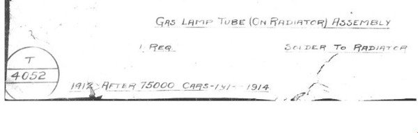

Re: 1912 Jno Brown Carbide Generator Mounting
You may want to check what you have first.....
1) Does your carbide generator have a 3 or 4-hole mounting base?
2) Does your radiator have a cross-over gas tube?
3) Are your running boards and splash shield already punched?
If so.....
The hole pattern is 5" x 5-1/4" on the 4-hole to leave the gas supply
out of the generator facing the splash shield.
If a late 1912 car, after about June 1912, your running boards may
already be punched for the generator with the 4-hole mounting base.
The 5" spacing on the generator fits the front running board support bolts.
About May/June 1912 (#132,000 +/-) Ford began punching the radiator,
splash shield and running boards for the acetylene gas "plumbing".
Makes the gas lamps much easier to set up.
Note on the Ford drawing below: "1912 > AFTER 75000 CARS - 1913 - 1914"
If so.....

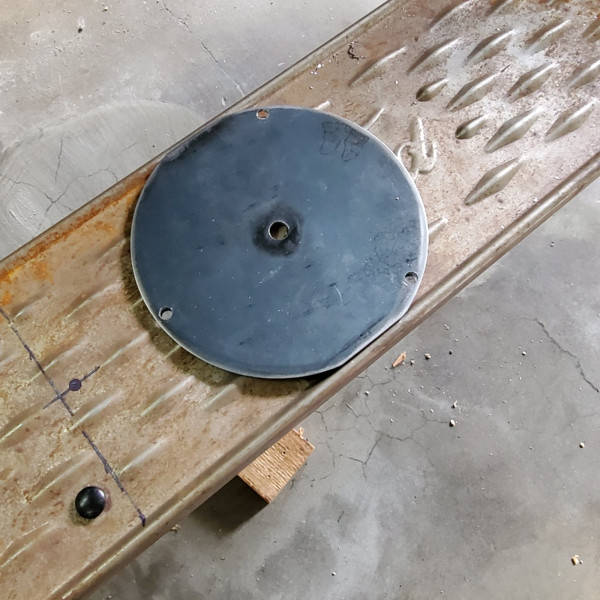

My repro 3 bolt generator was two wide to sit inside the raised rails running lengthwise so I had to make a spacer to raise the generator above the height of the rails. I glued a leather pad beneath the spacer to avoid scratching the paint applied later on.
[attachmentjp=0]20220505_120255.jpg[/attachment]
- Posts: 7176
Richard, the leather will hold water, and that may lead to rust.I would space your mounting plate on some nylon/plastic/brass washers to keep it off the running board. This will allow water to drain away also.
I do the same with any number plate fitted to modern cars. Dealers screw the plates directly onto the panel. I space them off on rubber grommets.
