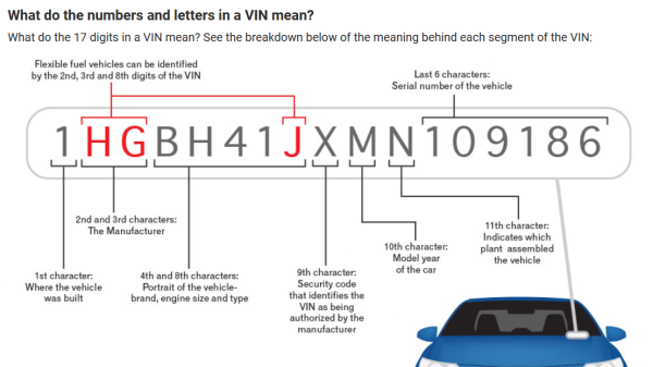

I agree with the above except for defaulting to using the engine number. If you would sell your car the VIN number on it needs to match a number on the car somewhere.. The Title indicates who owns the car described. Back in the day, Make, Model and serial number (engine number or body number) were used by various manufactures. State filing systems used all three attributes.
Today the VIN serves as the car's fingerprint, as no two vehicles in operation have the same VIN. A VIN is composed of 17 characters (digits and capital letters) that act as a unique identifier for the vehicle. Now if you look at your Title the values in the VIN field likely begin with just numbers.
But now A VIN displays the car's unique features, specifications and manufacturer (except for pre 1954 cars). So there's the rub, if owners of pre 1954 vehicles use just the serial number (engine or body) there is a chance of a conflict where some Chevy was already registered with the same number 8077073.

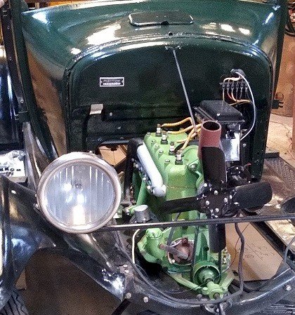

Re: If you were going to add a vin plate?
Post by varmint » Fri Aug 30, 2024 6:25 pm
Adding a separate tag, on the firewall in front of the passenger will do.
I did what Steve suggested. It faces the front, not the passenger.
The Patent tag, I put back where the old one was above the toe board.
Post by varmint » Fri Aug 30, 2024 6:40 pm
Found a picture of where I mounted it.

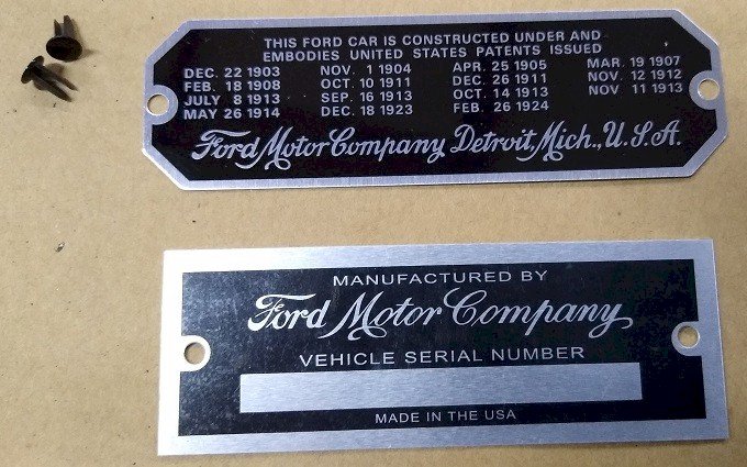

Lang's has them - Part # 1865D. They are listed as being for 1913-1916, but who cares? it's not original anyway. There is room to stamp one number - presumably the chassis number. They also sell the rivets that are brass. You also could use pop rivets or drive aircraft rivets. If you are mounting the rivets on the firewall, anything other then pop rivets would be a two-person job.
