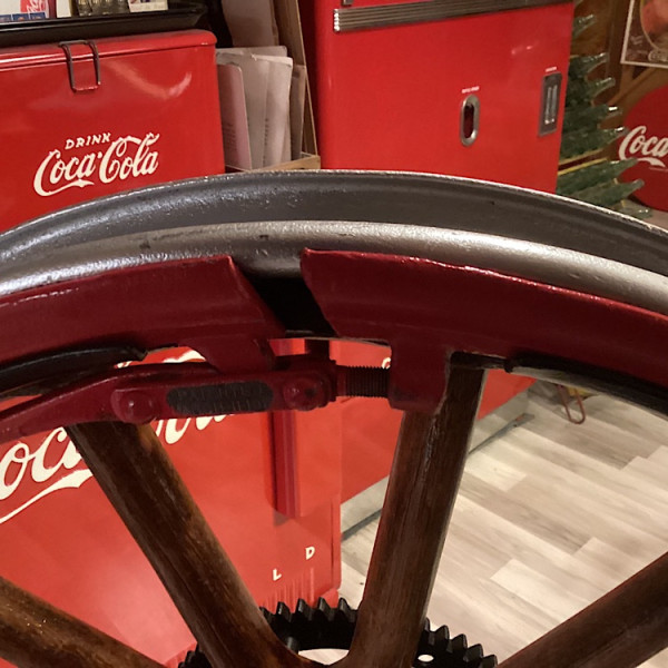

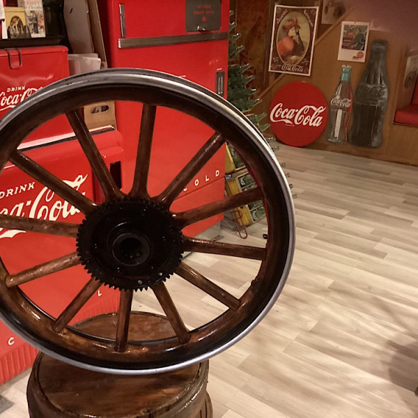

After Market Wheel Converter ?

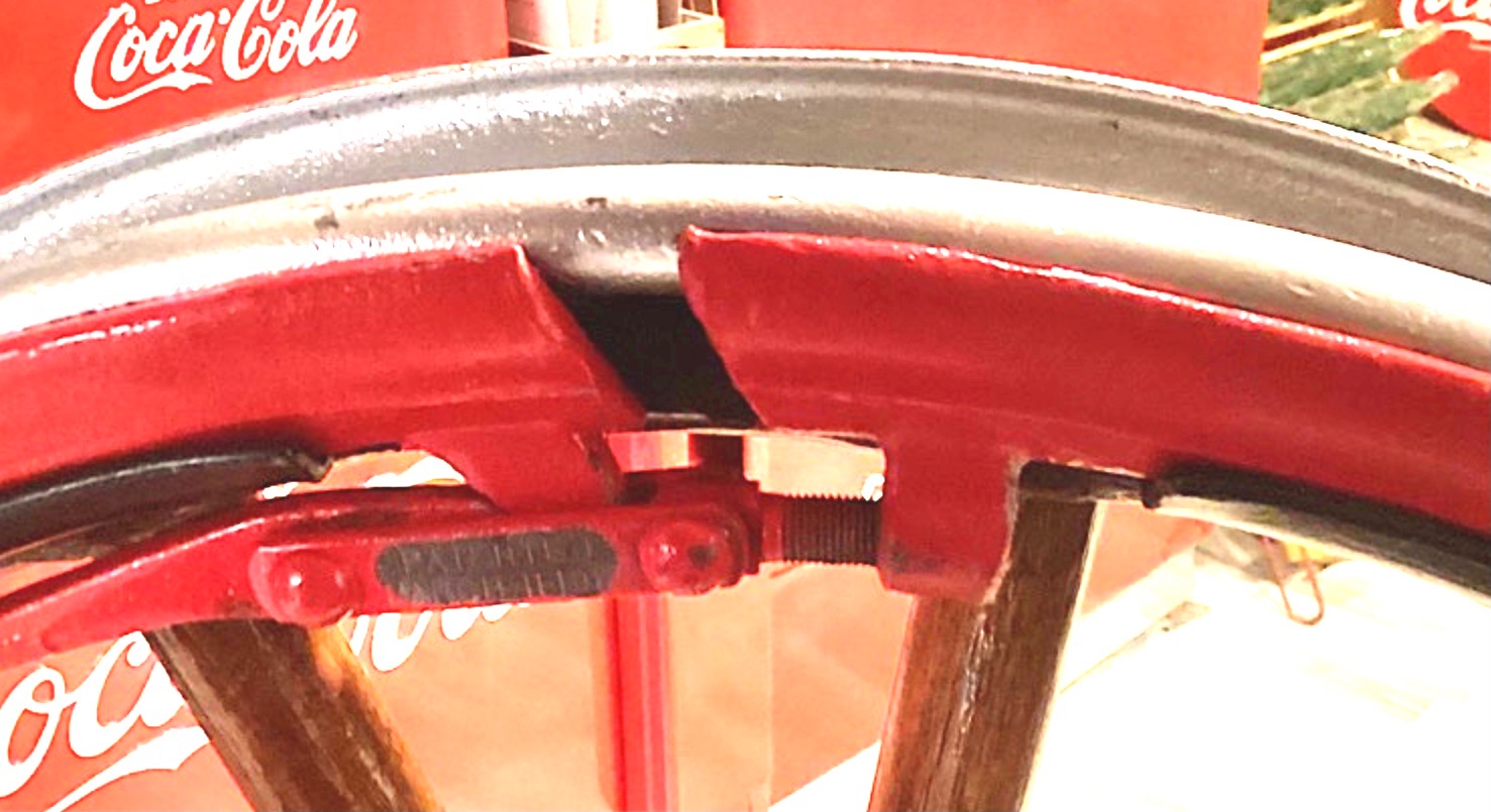

These photos were sent to me by a relative asking if I knew what the heck it was. I said I’d ask here. It looks like it converts a non demountable to a demountable rim. We were speculating that it might be used for a quick change for a flat but that’s just a wild guess. Anyone got any info on it?

Re: After Market Wheel Converter ?
I never saw anything like it. It might be to fit 30X3 1/2 rims to fit 21" wheels. Anyway, I wouldn't drive on a wheel like that. It is a roll over accident waiting to happen. especially on a front wheel which that looks like it is with a speedometer gear on it..
What happens to the rim when the device is unclamped & removed? I see it has a patent plate on it. Any more information besides the word "patented"?

There is a date of the patent, can’t read the year, with full date, day, month and year that patent can be researched on line.
Can read March 11, 19__
Do you suppose it was made to convert a 30X3 wheel to fit 30X3 1/2 tire? You would need to make the diameter of the rim a bit smaller.
- Posts: 4963
Norm may be on to something, kinda.
It could be used to use a 30x3 tire on a 30x3 1/2 rim.
Possibly allowing the owner to carry only one spare tire 30x3 & the adapter for the 2 sized pre-demountable wheels.
- Posts: 6923
That makes good sense John, but, it would only apply to demountable wheels. Our Canadian Cars came with 30 x 3.5" tyres all round. Were there 3" demountable rims on wheels in the USA?
- Posts: 4963
There were no 3" demountables in the US, at least common knowledge wise.
My SWAG is a 30x3 tire on a bare rim (24") could be placed on a 30x3.5" rim sans tire.(23") All non-demountable.
This clamp device would hold it all together. If the driver had a front flat, the tire could be transferred from the device rim, thus not needing 2 different sized tires.
Remember that there was a huge accessory market looking for suckers, uh, customers.
An accessory's functionality was secondary to making the sale.
I am a big fan of accessory collecting.
Anyway, it's an educated? guess.

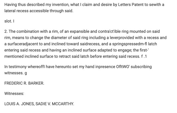

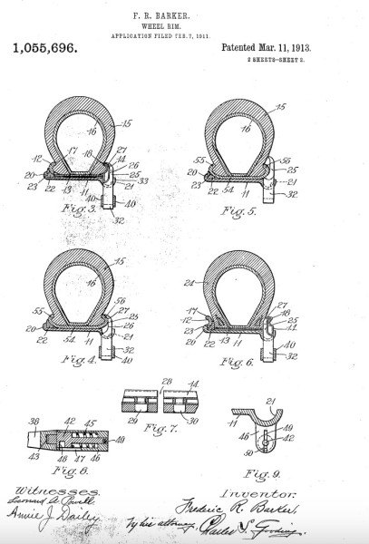

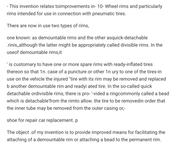

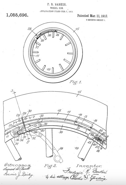

- Posts: 3953

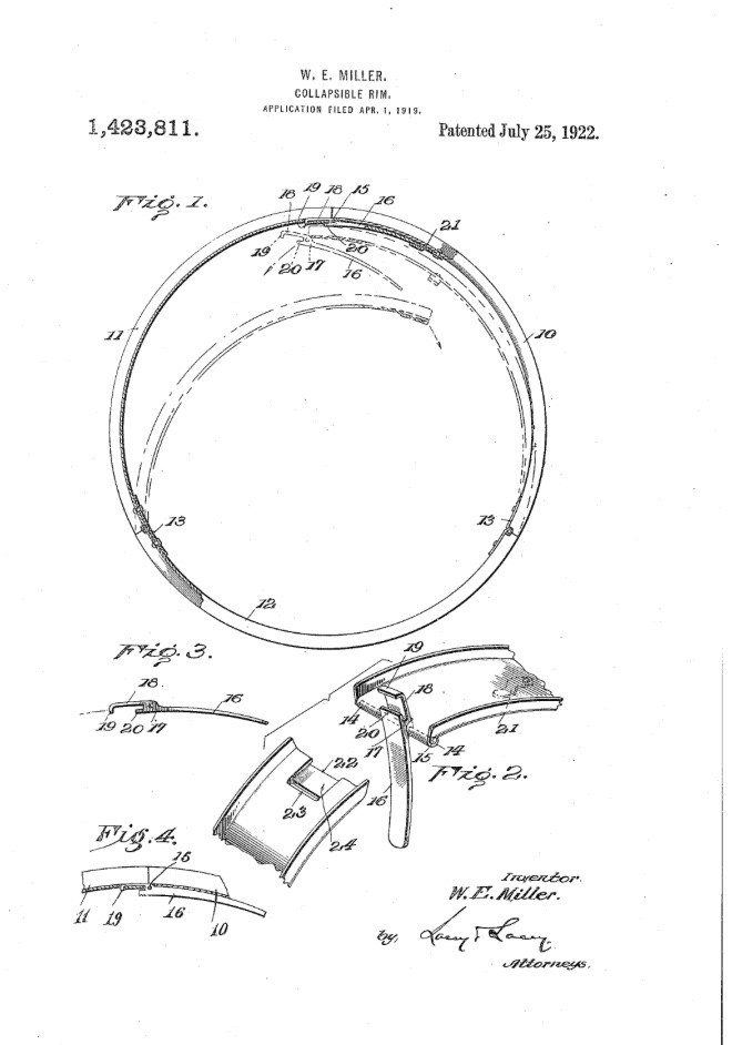

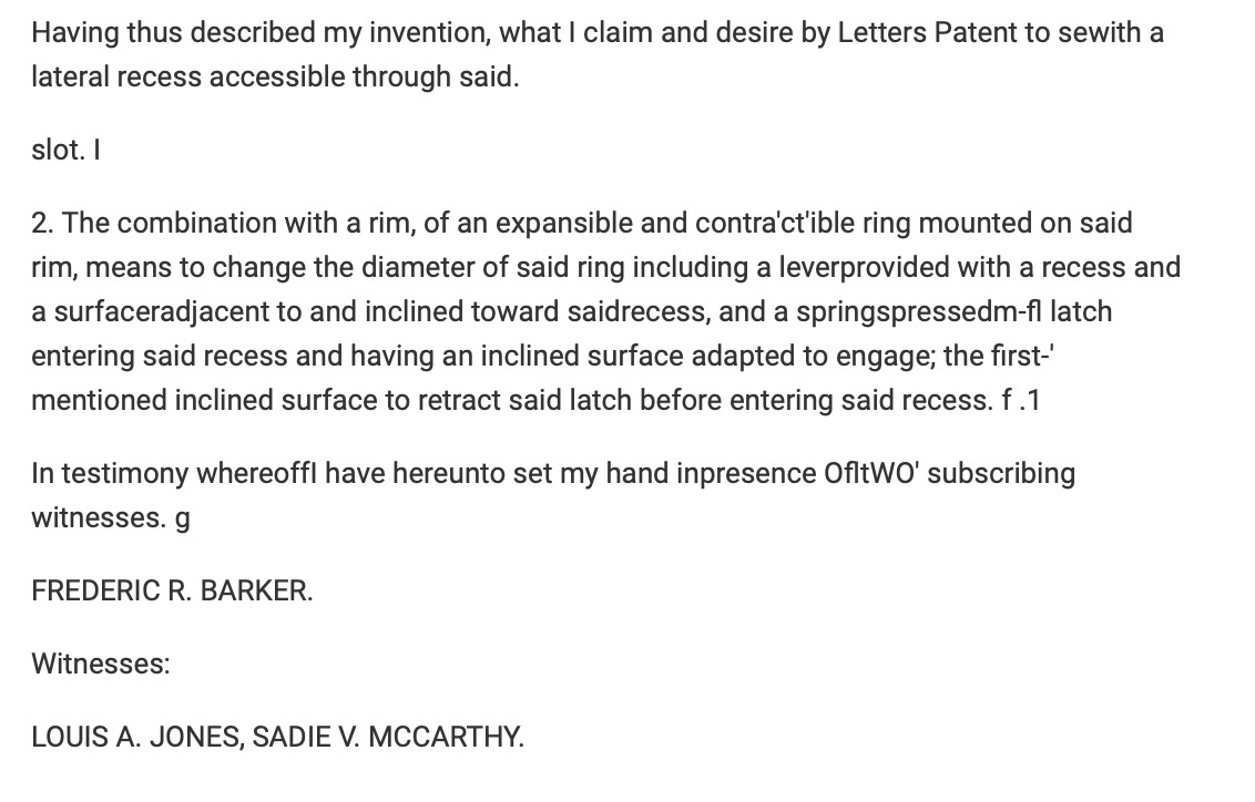

Well, after a couple of tries on Google Patent search, about 40 pages in of 360 hits for the time span around that patent date .
Finally found it. The invention is for quick release and install of a spare rim with mounted tire.
click on images to enlarge
Topic author - Posts: 771
- First Name: CHARLIE
- Last Name: BRANCA
- Location: Brick N.J.
- Board Member Since: 2010
Good Lord Dan thanks a million! We’d given up on ever getting a definitive answer. Thanks again. Man that's a hard read. Took a few rereads to get it.
- Posts: 1119
- First Name: Susanne
- Last Name: Rohner
I was trying to think of where I'd seen that lever arrangement, and it hit me - when I was doing hazmat, there is the split ring for 55 gallon drums that holds the lid and drum together (with a soft rubber gasket involved). That ring is usually anchored with an eye welded to each end and a bolt cinched down to complete the connector. But then, I ran across a cool device that, instead of being secured with eyes and a bolt, had a very similar lever device for holding the ring tight that was easily re-openable, that still held the ring and seal im place to temporarily attach the drum lid.
The lever arrangement - is almost IDENTICAL to the car rim pictured!
I am assuming that it would be great for straight sided tires, maybe not so much for Clinchers, but man, that WAS a revolutionary improvement at the time.
