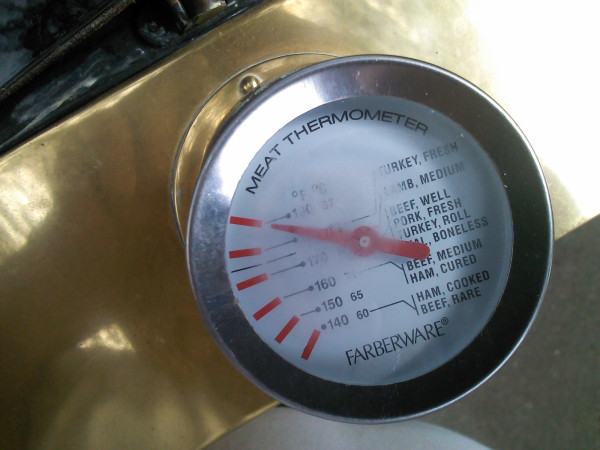

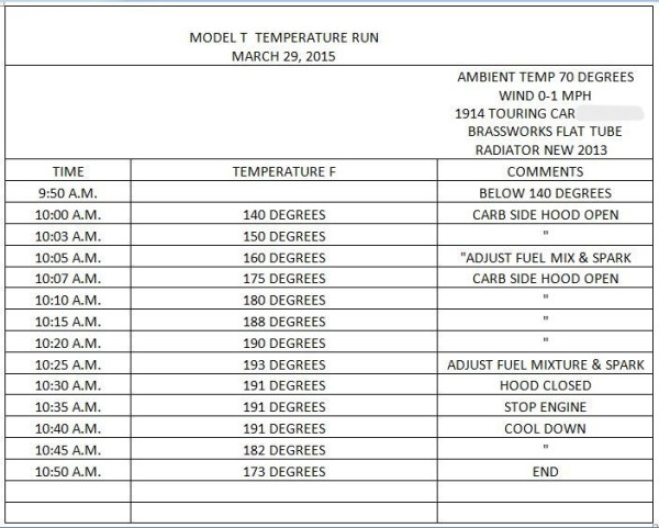

Post by Drkbp » Mon Aug 26, 2024 11:18 am
Easy check on your radiator, timing and fuel settings......
See what the temperature of your coolant really is. You can do that running at idle in your driveway.
Never had a Motormeter but you're probably fine. The car is designed to run near 200 degrees.
I run 50/50 antifreeze in my July 1913 engine and used a kitchen thermometer that I have checked on the
stove. A "boiling water" on the stove point showed well beyond my "in radiator" temps.
Ran it, starting from cool, sitting in my driveway for an hour. Just don't set it up with a "tailwind" because
the radiator/engine needs the fan at "idle" and very slow speed. As others have said, fan not needed at speed.
Ran a little cooler with the hood closed.
This was done years ago at 70 degrees ambient but the car just doesn't boil, even today at 90+ in Houston.
It will "glurk" once or twice when I come back from a drive but that's it. No loss of coolant.
