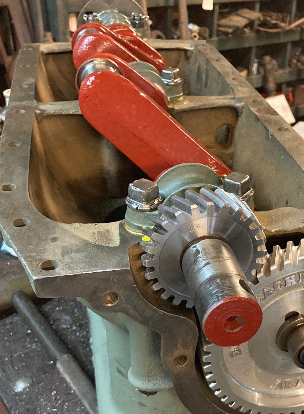

I love how it performs inside of the block of my '12 engine. When you drain the oil or open the inspection covers all the painted areas are spic n span clean of oil residue. I think it has something to do with surface tension. There is a reason that high performance racers use it? YMMV

A Gyptal painted crank spins faster, more speed
Oh...and Gyptal has been painted inside engine blocks for a very long time.
