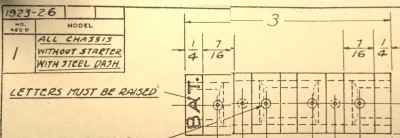

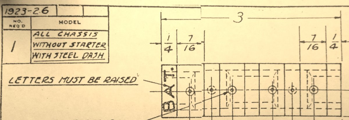

An oil tail lamp would be supplied with non-starter open T's, as there is no storage battery. But in the later years, when the T was around a while, many owners installed storage batteries, so even Ford knew that. The terminal block shown is the 4 lug, and the left side was reserved for BAT, in case an owner installed a battery. This terminal block is for the steel dash, '23-'27 open car non-starter.

Open car / bare chassis, non-starter terminal block for steel firewall
