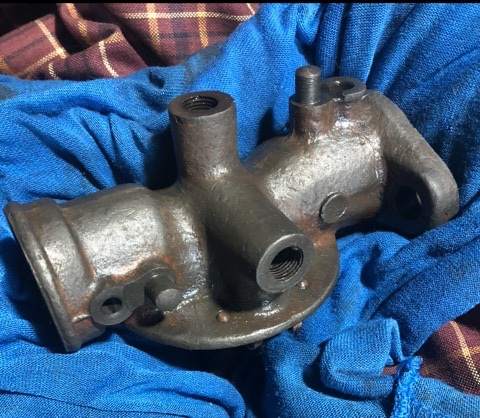

Thanks for all the help guys. I think i have it figured out and yes its an NH and one more thing i need to address is the rust in the bowl and the part that goes in the bowl. I see there are lots of antirust products what do you guys recommend for taking off the rust.

Soak the bowl in white vinegar for a day. Clean the residue off with soapy water. Works well for gas tanks also.

You can soak it overnight in citric acid then let it dry and lightly wire brush it and it will come clean.

Apple cider vinegar I feel is better than just vinegar. Works really well on rust. Soak for a day and wire brush it off, then a very light coat of oil to prevent flash rust. I've been using it for years. Also try electrolysis. There are lots of videos online on how to do that. I've also used it for a long time on larger parts. Removes all rust down to bare metal. You just have to wire brush off the black residue of former rust, dry it and prime it to prevent flash rust.
