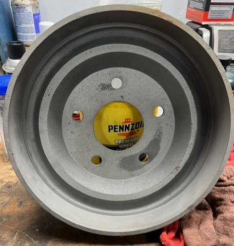

I bought a set of new Rocky Mountain brakes with cast iron drums and didn’t have instructions to explain on how to set up the drum with the hub. They are for large drum brakes with wire wheels. I’m having an issue with figuring out how to set up drum with the hub. There is about a 1 inch spacer that came with the kit that I’m not 100 % where is goes. I can post pictures if it will help.

The holes line up perfectly for a t wire wheel. I had it mocked up last night. This set is very old, one of the first productions of Rocky Mountain brakes.

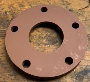

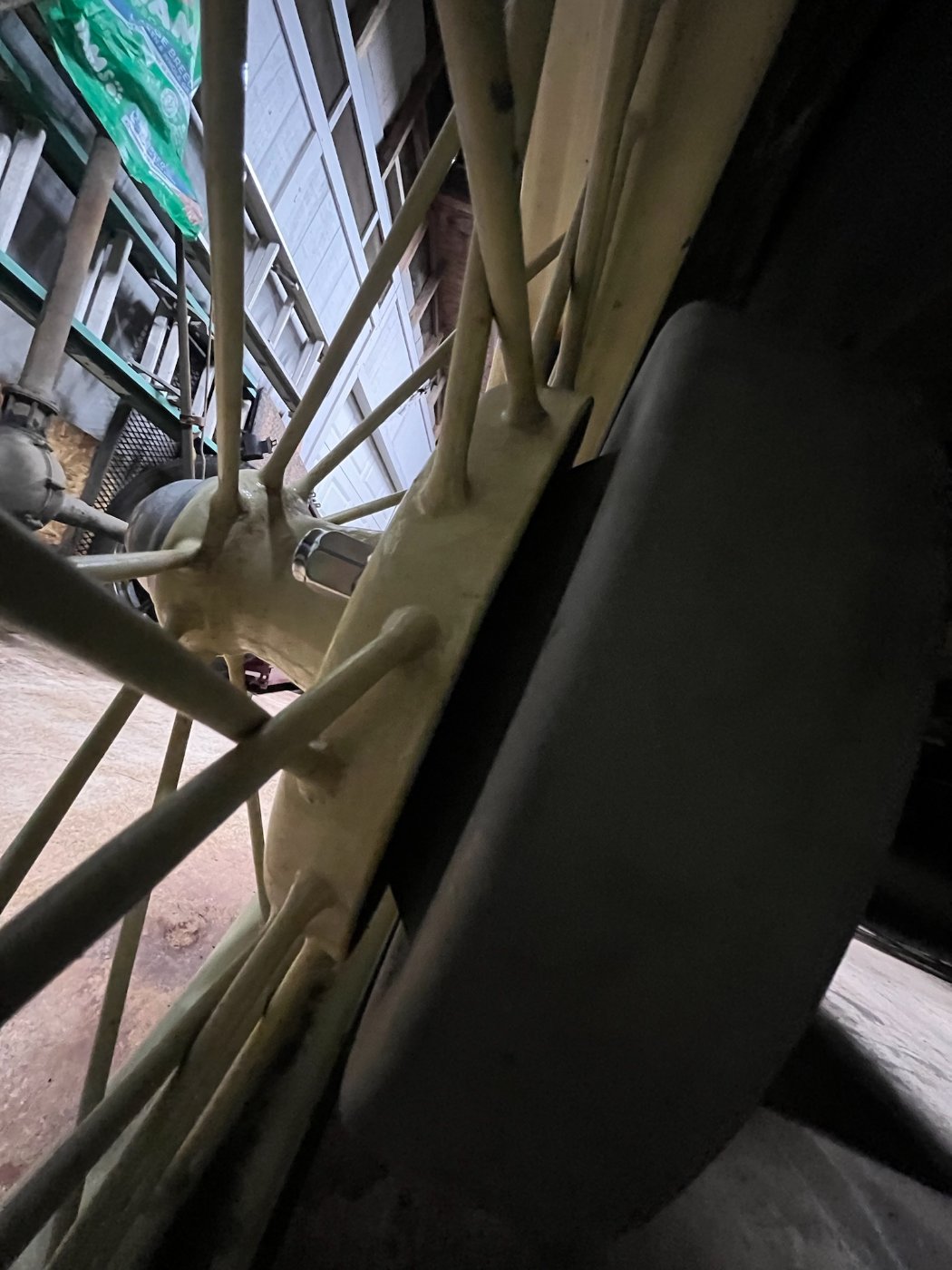

Tstroker89's Pictures attached

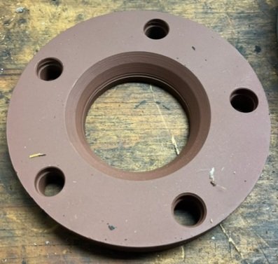

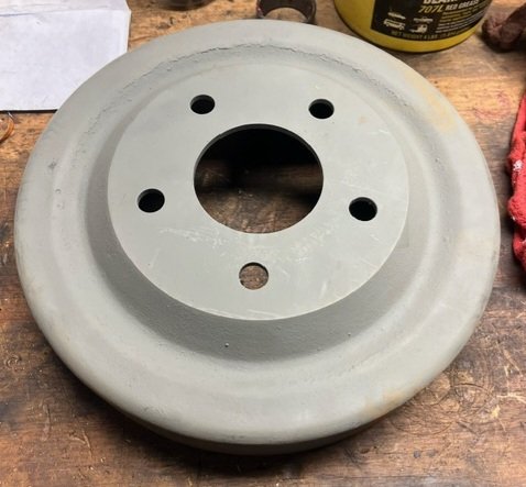

Those new pictures show cast iron brake drums that are quite different from the 1970’s Rocky Mt Brake cast iron drums that I had. Perhaps if you post a picture of the brake bands or brake shoes that came with the drums it would help to identify them.

I've seen a lot of accessory brake types & drums but that's a new one on me ! I have a couple sets of Sunderman repros that included a cast iron double drum.

What is the bolt pattern on these drums? Looks larger than 5X5. Was the outside finished as well?

The bolt pattern is the same for a t wire wheel. There will be a picture of the wheel bolted on with the spacer.

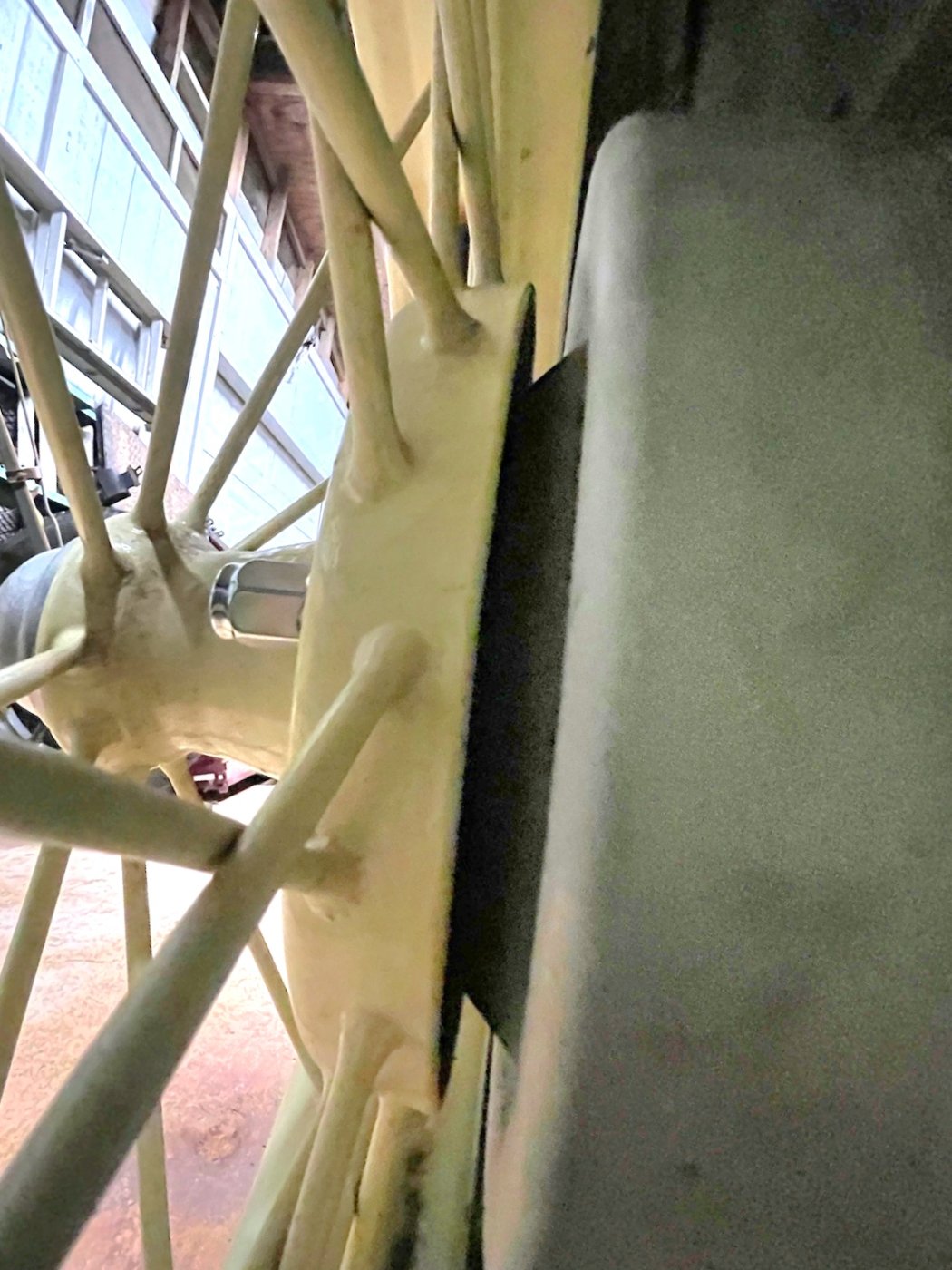

Another Pic

Post by RVA23T » Sat Sep 07, 2024 6:05 pm
Just like a 26 T, an "improved" picture

Think I would pass on using that setup. The 26/27 wire wheel needs to be supported by the machined area on the hub at the outer end (the lip that is also used by the hub puller) and press up to the drum not just held on by the lug bolts/nuts. From the photos, looks like the wheels are now moved outboard of where they should be.

I plan to still use this setup if I can figure out if the spacer is needed or not. I believe floating rear hubs for wire wheels have a similar setup. I mainly made this post to see if someone else ever used or seen this set up before.

OK I think I know how your system is supposed to work, but with out any dimensions I can’t be sure. The red primered adaptor goes inside the cast iron drum with the flat side in contact with the drum fitting against the inner cast drum. Your 1926-27 wire wheel rear hub, sans stock pressed steel drum and wheel studs, goes into the adaptor centering on the adaptors’s machined taper. New wheel studs of unknown length go through everything in this order from the inside, T wire wheel hub, cast iron brake drum adapter, cast iron brake drum. The Model T wire mounts so that the tapered part on the out side of the cast iron drum contacts the inside of the T wire wheel. If I am correct on how this goes together I don’t think you gain anything, if you use the stock 26-27 brake bans. Are you sure that you are not missing some sort of aftermarket brake backing plates for hydraulic brakes ? I have used stock 26-27 wire wheel rear hubs with the AC type external contracting brakes and the stock internal expanding emergency brakes with out any problems.

OK I think I know how your system is supposed to work, but with out any dimensions I can’t be sure. The red primered adaptor goes inside the cast iron drum with the flat side in contact with the drum fitting against the inner cast drum. Your 1926-27 wire wheel rear hub, sans stock pressed steel drum and wheel studs, goes into the adaptor centering on the adaptors’s machined taper. New wheel studs of unknown length go through everything in this order from the inside, T wire wheel hub, cast iron brake drum adapter, cast iron brake drum. The Model T wire wheel mounts so that the tapered part on the out side of the cast iron drum contacts the inside of the T wire wheel. If I am correct on how this goes together I don’t think you gain anything, if you use the stock 26-27 brake bans. Are you sure that you are not missing some sort of aftermarket brake backing plates for hydraulic brakes ? I have used stock 26-27 wire wheel rear hubs with the AC type external contracting brakes and the stock internal expanding emergency brakes with out any problems.

Has the outside surface of the drums been machined? If not, they are likely for a different purpose. As mentioned, T wire wheels need to be supported on the inside edge. Even with this, they were still prone to flexing and cracking between the stud holes. This was cured in the A model wheels by pressing a ridge between the stud holes to stiffen up the hub.

I was there when the first series Rocky Mountain Brakes were made by Jack Sunderlin. I have a couple of sets of those drums. They work fine, but were not machined to my liking. There was no radius on the top surface as original, and the area between the inside of the top surface should have been machined too to get rid of the casting marks.
The problem with Jack was he wasn't a gear head! He wrongly assumed that all equalizers are the same, and hence, that is why they have rods instead of cables. When Bud took over the business, I don't understand why he didn't correct the problem, but he didn't. I have done the research, and know exactly what Rocky Mountain used. Too bad someone with a machinist background hasn't come to the rescue!

This is great information. What sequence does the drum, hub and spacer go?
