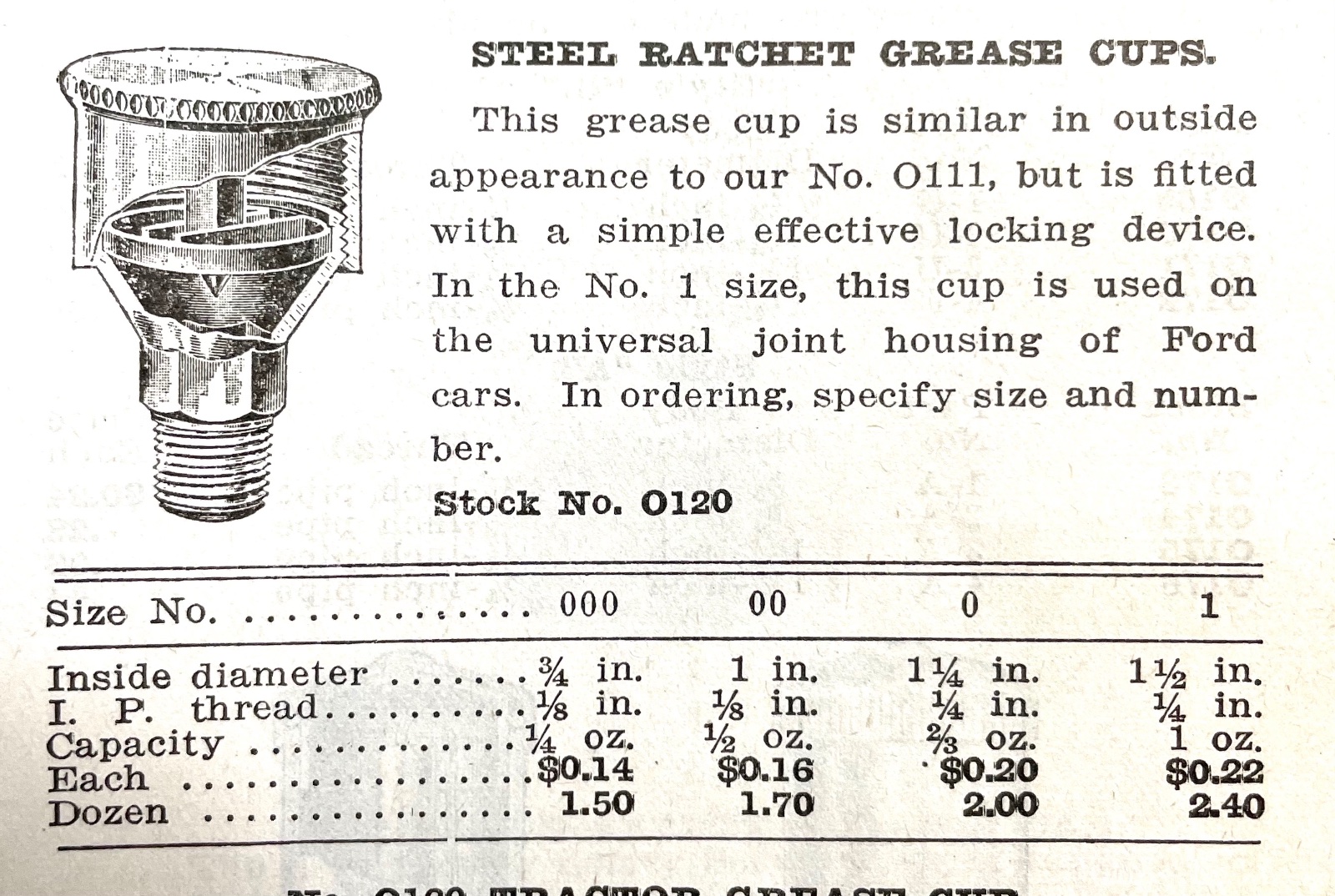

Grease Cup (rear axle and D.S.bushing) p/n 2545B (Fac # 76) is noted by Bruce's C-D to be used likely '09-'27
The other Grease Cup, p/n 2545 (Fac # T-76A2) was noted to be used '24-'27
Think the difference is the brand with the ratchet, to prevent the cap from vibrating off, you see these styles on the '24 and later original Ts.

The early style I have on my 1913's is a more decorative knurl than the later design.
