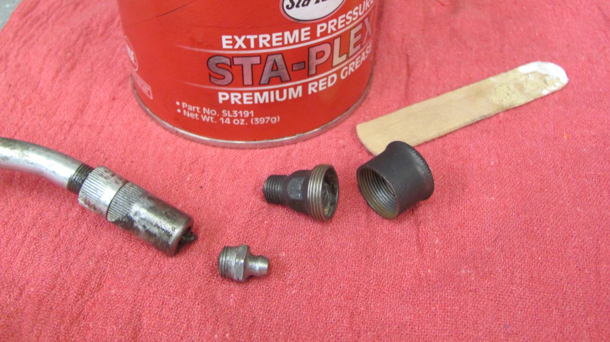

If you do use a grease gun, and a Zerk, pay attention to the amount of pumps you use for sufficient grease. The biggest grease cup on the T is for the Universal Joint, that one is easy to gage as you fill and turn and fill and turn until grease oozes out around the ball cap. For the upper drive shaft bushing, always do two or three fills. Any extra goes into the torque tube, can't hurt! The rear axle Hyatt's can use that too, those bearings are doing heavy work.

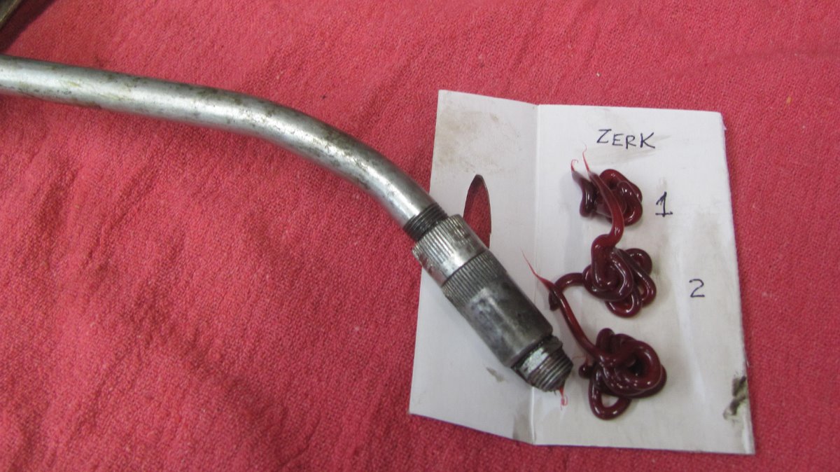

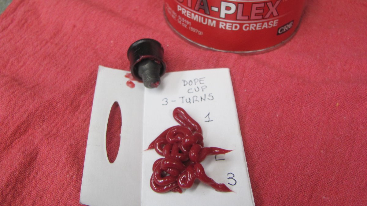

For a side-by-side of Dope Cup fills and complete twists until empty......to individual pumps of the grease gun out a Zerk, you can see my photos.
Gives you some insight on how many pumps you need with a Zerk to meet the volume of grease the Ford dope cup gives

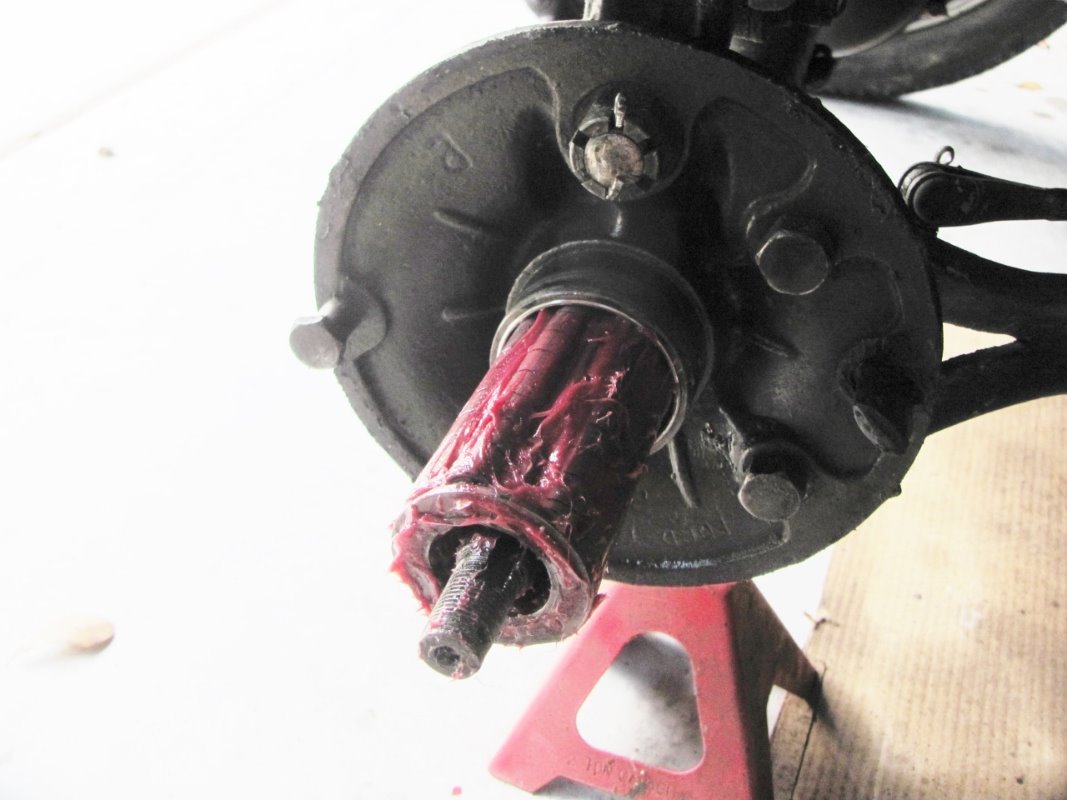

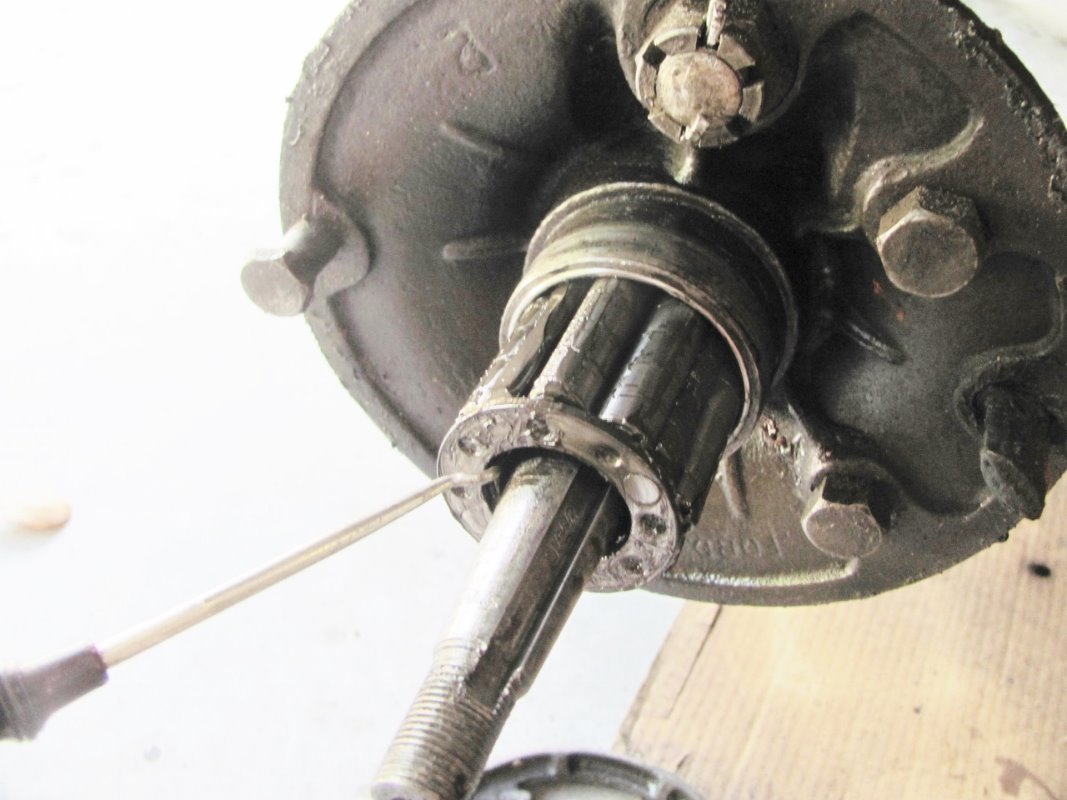

Experience for me, and with modern inner and outer seals, is the red grease that you pack there when removing, cleaning, and inspection of those outer Hyatt roller bearings........after running for 3000-5000 miles...... it just liquefies and turns runny and dark with age and who knows what, but isn't doing its thing.
Here is my rear Hyatt, with the normal every 500 miles of filling and turning the dope cup several times.....still was looking lube poor
So, pulled and cleaned, inspected rollers and sleeve and then added fresh red grease, just like before. Re-install. The Ford likes grease and oil

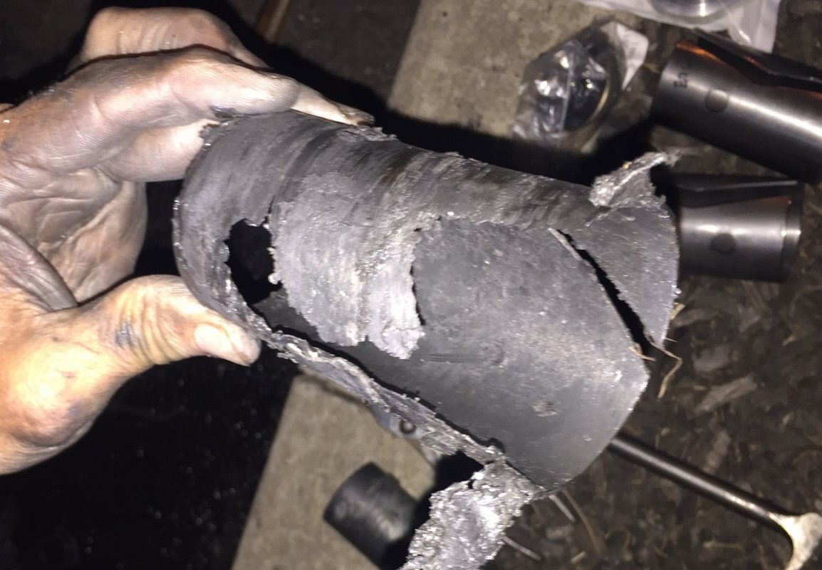

As for the outers, they need care and tending. The car weight and axle is supported out there, lots of load on those rollers and sleeves. So, yes, I do check them every 2-3 years, pulling the wheels, helps to know all is well.

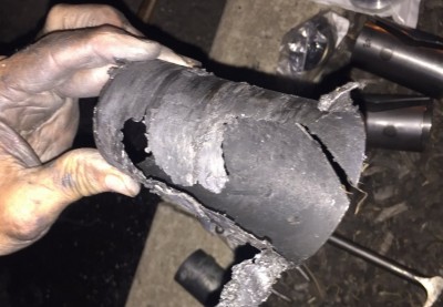

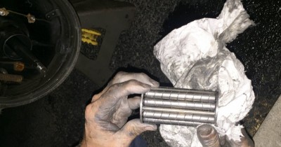

Have reports of others, who didn't check over time, perhaps a lapse of turning in the dope cups. In this example, on tour, the dope cup was gone, so unknown how long the outer ran without proper lube. Was detected on tour, noise coming from rear end, pulled the wheel in the motel parking lot.
The outer Hyatt, it was still good to use, but the sleeve was worn to smithereens...and was replaced
