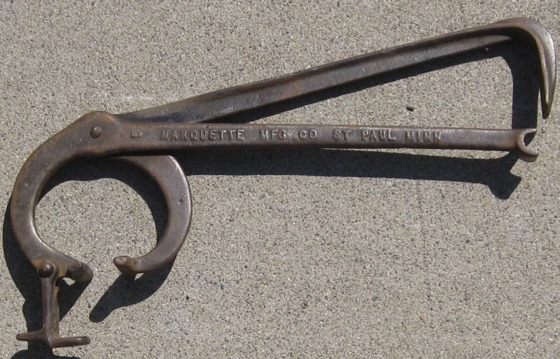

I just bought a Marquette tool to attempt to change my tires (since I ticked off ever tire place in town because of these clinchers). I wanted to ask if anyone has any literature or just pictures or a video of exactly how it is supposed to be used. Also, I saw a video once of a man mounting clincher tires on some English car. He placed a thin trashbag across the rim and then laid the tire on top of the trash bag covered rim. He proceeded to simply push the tire on without any tools. He said the bag reduced friction and allowed the tire to go right on. It looks so easy but I don't think that it would work, at least on a T. Anyone tried it?

Simple explanation. Grab the tire at the bead with the jaws of the 'Giant Hand'. Do this at several spots near each other to break the bead loose. Once the bead is loose, close the jaws by gripping the handle, then push down. If you are near the top of the tire, the swivel thing should swing down and now touch the top edge of the rim. Still holding the jaws shut, with the swivel thing against the rim, pull up on the 'Giant Hand'. The jaws are holding the beads together, and the swivel thing acts as a fulcurum so as you raise the outer end of the 'Hand' it pulls the bead out of the clincher as slick as can be. Makes disassembling a clincher on the car a lot easier.

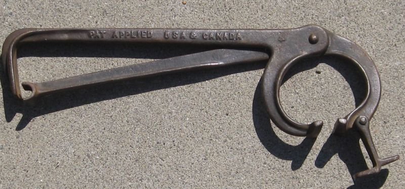

Found the tool. Additional instructions would be helpful. Those posted by earlier poster are appreciated and helpful but extra info would be nice.

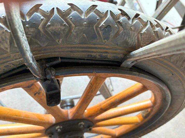

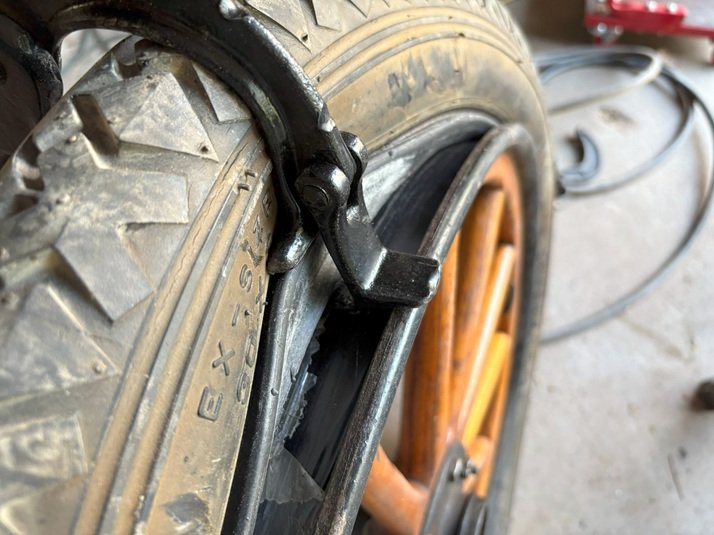

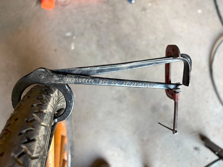

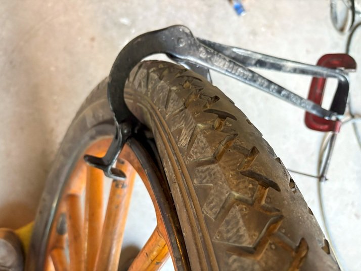

I recently had a chance to try out my Marquette tire tool. The biggest issue I had was holding the arms together while manipulating the tire. This was a problem when both removing and installing the tire. I found an old C-clamp that worked, thinking about better methods for future use.
I first attempted the rear 30 x 3 1/5 tires which had been on for 30 years. The tool must be opened wider for the larger tire which reduces one hand leverage. I did consider making some extension handles for more leverage, again maybe a future project. No amount of squeezing (or pounding) would break the beads and I ended up removing the wheels and using other means. The tires were both very hard and difficult to remove, the tool was not useful and I set it aside.
When I took the valve stem out of a front 30 x 3 tire, the beads released easily so I gave the tool another try. Using the C-clamp I was able to squeeze the bead, flip down the fulcrum and pry the tire over the edge of the rim. I was then able to give one good pry with the irons and the tire came off easily, pictures below. I had the wheels off for other work, it might be even easier with the wheel on the car.
I then used the other end of the tool for mounting the new tires. The tire bead wants to slide off the tool when prying, you must hold the handles together TIGHTLY to keep the bead on the tool hook. My hand grip is not string enough to hold and manipulate the tire, so again clumsily used the C-clamp. The tool would get about 6 inches of bead started and I used tire irons in my "other hands" to get the tire onto the rim. I think it was easier than tire irons alone. Sorry no pictures of the mounting, not enough hands to hold the camera.
The Marquette tool is a keeper and it's going under the seat with the tire irons. It made quick work of tire removal and I will try it again if/when I need to remove a 30 x 3 1/2 tire. A few people in my club are thinking about the "clamp issue", I will update if we have any workable ideas.
Old C-clamp on handles Squeezing bead Helping bead separate with tire iron Fulcrum in place Tire removed enough to finish with tire iron

Much appreciated tutorial, Jay ! I have the same tool but wasn't clear on the operation - your photo in the "leverage" position make good sense ! I noticed on your last photo, when I've gotten a tire that far over the rim, it can usually be pulled right off over itself by hand. I have a manual tire machine but next tire I have to work on, I might give the Marquette a try !

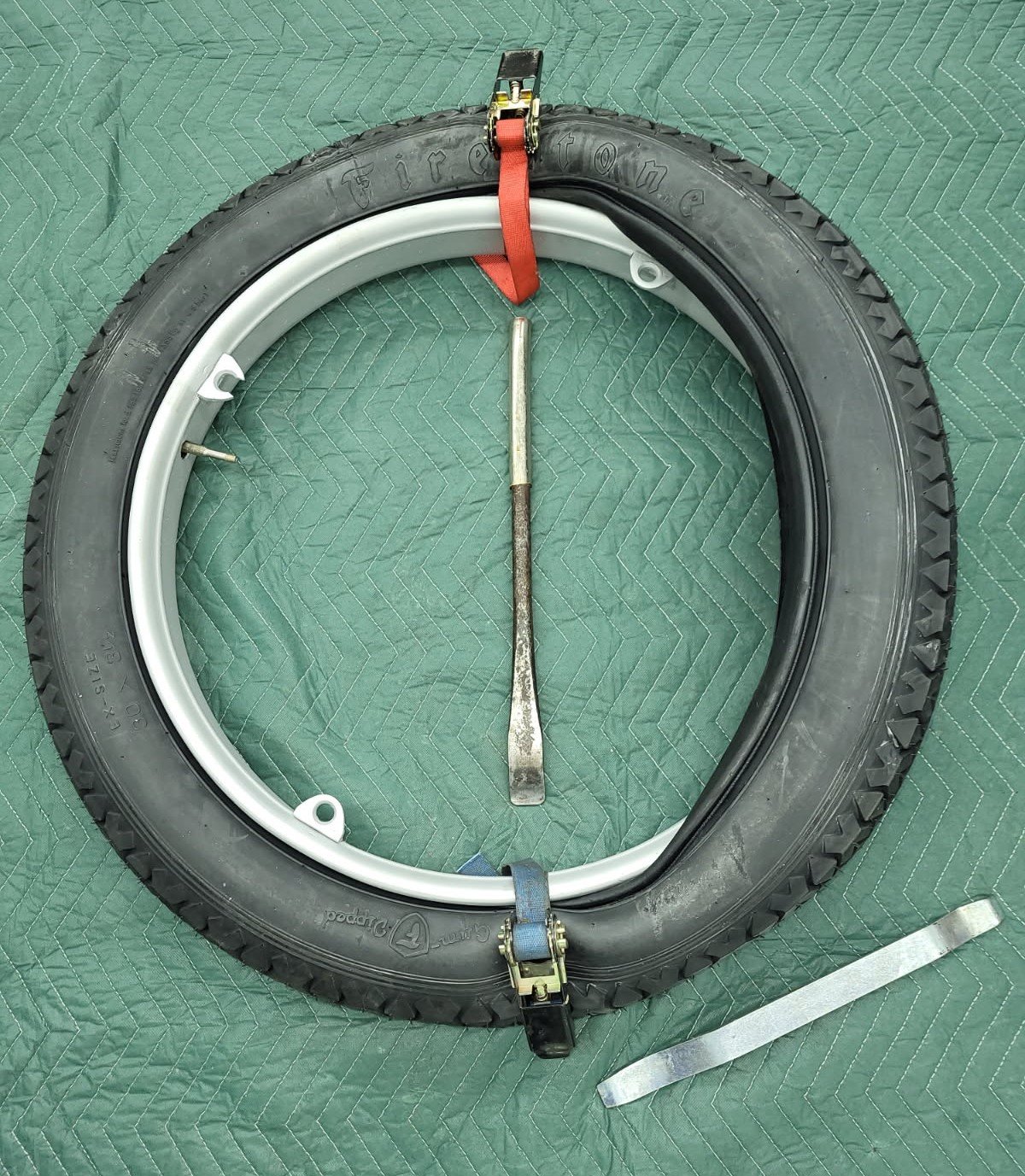

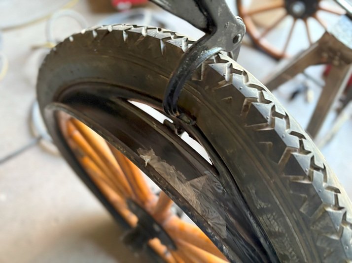

I love my Marquette tire tool! I keep it in my flat tire bag of tricks and recently used it while teaching a Chebby guy how to mount 30x3-1/2 clinchers.
He watched in amazement and asked, "where did you find that tool?"
After mounting three tires with four hands, he mounted the last one by himself using my ratchet strap trick:
I use the "off" end more than the "on" end.
- Posts: 7125
Re: How to use Marquette tool
Keith, I can't tell if both beads are still to be fitted over your rim. Your ratchet straps serve the same purpose as the clamps i use do. When levering both beads on at the same time, in the last little bit one bead goes on first, and I need to be careful levering the last little bit of the second bead on to avoid possible damage to the tube.
What sort of wheel is your Chev rim mounted on? I once had a Hayes wire wheel with TWO valve stem holes in the felloe so a Chev rim could be fitted as well as the Hayes rims that fit Ford wheels.

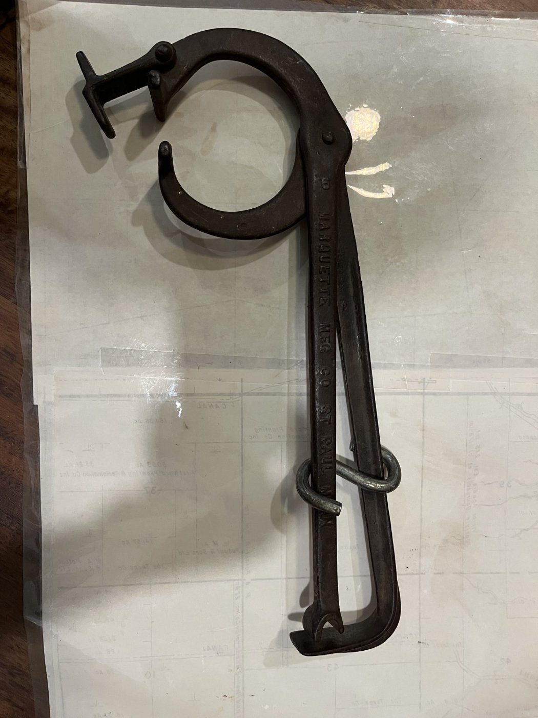

Just tried using an "S" hook. Had to open one leg of the "S" a bit, but here's a picture. Haven't tried it under battlefield conditions, tho...
Just food for thought...
jpcouture
- Posts: 27
- Joined: Wed Jan 09, 2019 11:03 am
- First Name: Jay
- Last Name: Couture
- Location: Mahtomedi, MN
The S hook is a good idea. I have a temporary tube in one of my rear tires, I will give it a try when I put the “real” tube back in.
