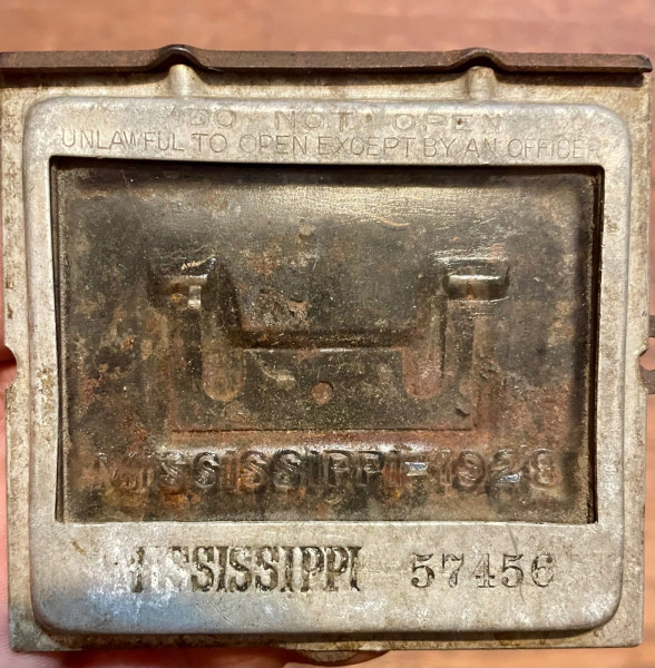

In Mississippi we had a metal registration holder that was supposed to be displayed inside the car. I can’t find the 1916 holder but I did find the 1928 holder. It has 2 tabs in the middle of each side for mounting. The neat thing is the ominous warning stamped on the top edge. Tab holes are 4 3/4” center to center. Best John

Russ, thanks, that explains it. Took a look around, found a lot of cars so-equipped, including a few with the Stewart instrument panel. From ads, "less speedometer" shows up from August 1915 on, so supply issues plus an August price reduction following the earlier rebate offer?
Wayne, if you get a chance to photograph the mounting holes on your car, would be interesting to see if the dimensions match up.
John, those metal registration holders sound very ominous.

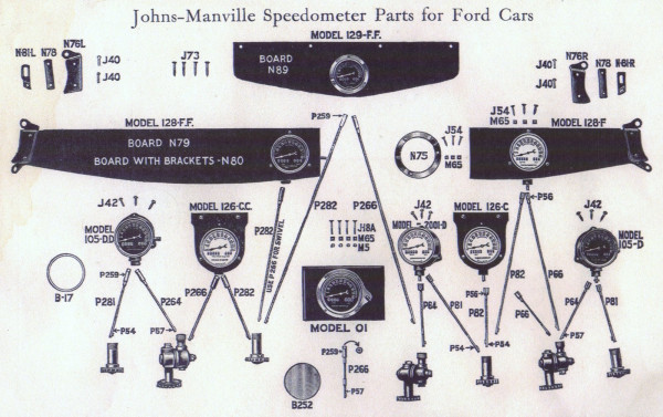

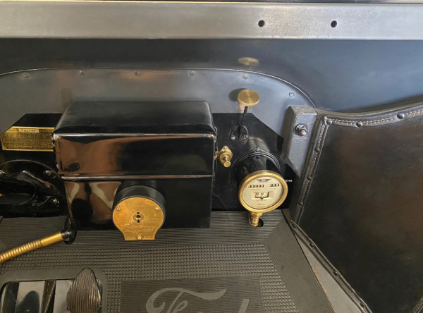

Here is just one example of a speedometer that was mounted to the cowl.. This one is a Sears-Cross. Following July 1915, Ford did not install speedometers in thier cars. Consequently, the same manufacturers that provided the "Ford Special" speedometer continued to sell speedometers to the Ford owner. Attaching the speedometer to the cowl is just one option available to the Ford owner. I have seen examples from Stewart (Model 150-D), Sears-Cross, Johns-Manville (Model 126 as seen in the parts photo) and Standard Thermometer. I hope this helps. Russ Furstnow

Russ, thanks, it helps a lot. Something like the Model 126 would fit very neatly.
The engine was missing from the car when Ken found it, but the stamped body numbers seem to read June 1915. Not much of a stretch past July, makes a lot of sense. The earliest "less speedometer" comment I found in Ford ads was from July 31, 1915. There was a brief mention of something similar in March 1915, not sure what that was about.
