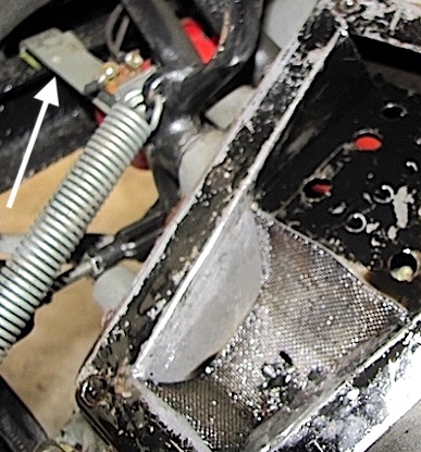

Can someone provide a picture or instructions on mounting this switch I just purchased from Langs. I can’t seem to place it correctly. [image]
[/image]
This on a 26 coupe.

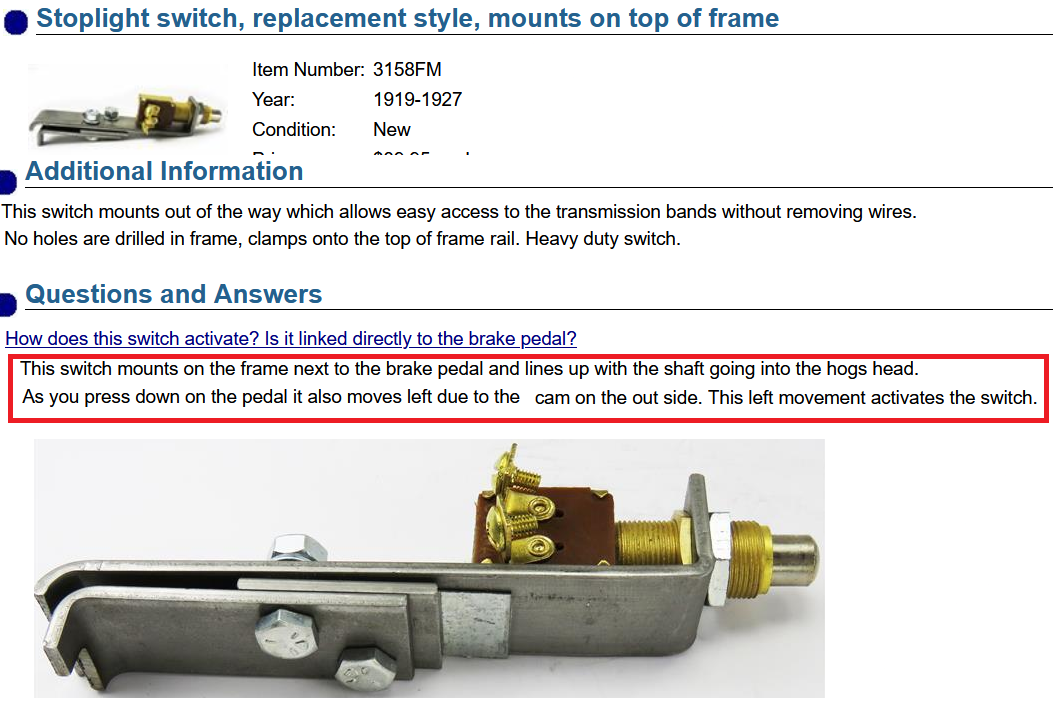

Dan is correct. From Lang's website listing on the item: " This switch mounts on the frame next to the brake pedal and lines up with the shaft going into the hogs head. As you press down on the pedal it also moves left due to the cam on the out side. This left movement activates the switch."
https://www.modeltford.com/item/3158FM.aspx

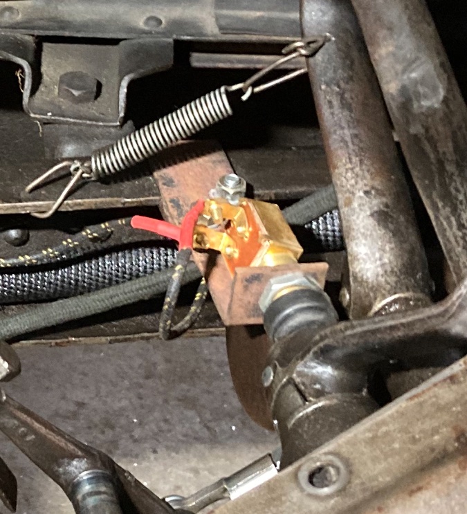

This is my install on that type brake light switch, works swell too.
IMG_2337 (600x450) (580x435) (570x428) copy.jpeg (92.03 KiB) Viewed 2817 times

Here what the say. Looks like a bit of trial & error to get it to depress
