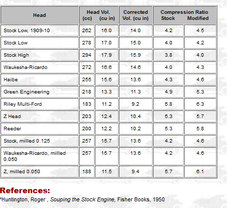

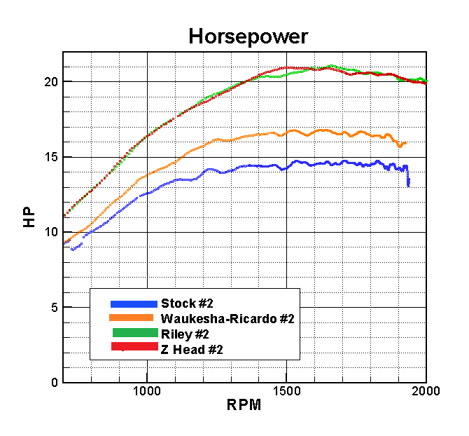

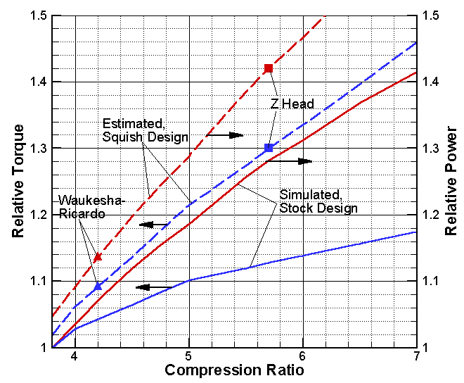

Head Compression how high is "High Compression" vs "Low Compressions"
Torque measures the turning force produced by a vehicle's engine and the engine's ability to perform work, horsepower measures how fast the engine can perform the work. Therefore, high torque makes an engine accelerate faster from a stop, and high horsepower makes for higher top speed.
compression ratios.png (104.74 KiB) Viewed 4947 times
