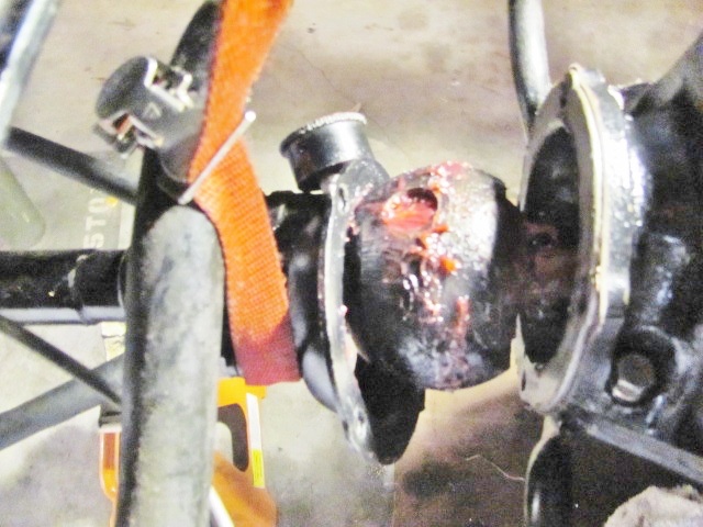

I have an oil leak that lets oil out of the driveshaft ball cap. Its hard to see the oil on the cap but it is coming from there and leaking down onto the flange. Otherwise the engine is pretty much leak free. What would be the cause? Can I repair with engine in place?
I know the safety wire is missing but I did check the bolt tightness.

Situation normal. Keep the ball cap pumped full of grease to reduce the rate of oil seepage.

I gave it about 10 pumps but none came out, should I pump until it starts to come out?

Yes, more pumps, 10 aint gonna do it.
There is a lot going on at the U-Joint ball. The front of the ball socket is the 4th main bearing. There is no seal between the transmission tail shaft and the 4th main, so it will leak, and it will leak into the U-joint ball and leak out at the ball flange where you are seeing it, and also down your driveshaft into your rear axle. There is no cure, but you can slow it down with a lot of grease in the ball.

A correct fitting 4th main (1.5-2thou) doesnt leak much. The u-joint needs to be packed full. Grease will ooze out when its close to full.
Leak multipliers include no output shaft plug & a transmission screen. The screen concentrates the left over, filtered oil right on the ball cap. One solution is to turn the ball cap either 90 or 180 degrees. (that only works if the ball cap was perfectly machined on center.)

I can see displaced sealant between the 4th main flange and hogshead but I cant tell if a gasket is present. It drips there when parked but the cap leakage is only while running. No gasket behind the ball cap. Can the 4th main be pulled out enough to reseal? If so, I could cut a gasket and ultrablack it in with the slit facing up and ultrablack the ball cap flange. I'd like to get rid of any leaks if possible, I did conquer the oil pan and bolts, valve cover, trans cover and top oil tube flange leaks.

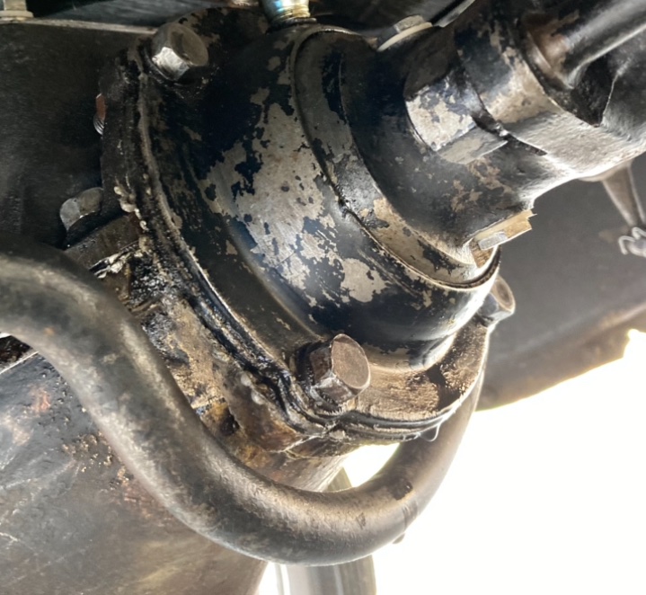

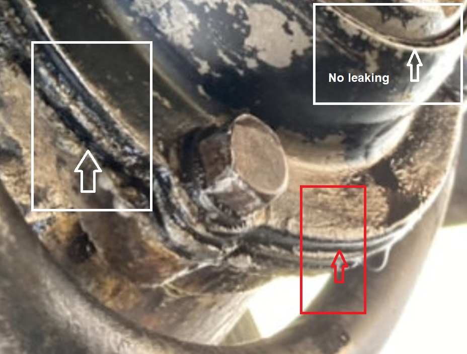

Post by TRDxB2 » Sun Sep 29, 2024 12:08 am
past discussion
https://www.mtfca.com/discus/messages/3 ... 1375394665
See other's comments about this Where there is no leaking may mean .....

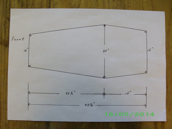

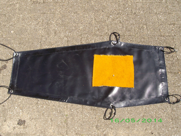

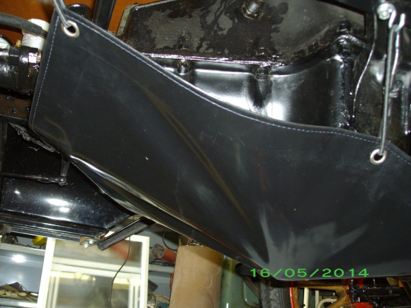

For that oil leak , I use a ]DIAPER ] see pictures .
Toon
past discussion
Its hard to see in the photo but oil is poaring out at the white arrow.

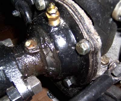

Post by DanTreace » Sun Sep 29, 2024 9:43 am
As others replied, the way to subdue oil leaking is to keep the U-Joint ball smack full of grease. Ford put the largest grease cup there for that reason.
Noticed in your photo no grease oozing from the ball cap, that would IMO mean your ball joint is lacking grease.
On assembly the U-joint ball should be completely full of grease.
And when greasing the joint, fill or pump until grease flows from the gap between the cap and ball housing, that shows it's full up.
Grease at uninv joint copy.jpg (54.06 KiB) Viewed 3216 times

I did add some but I'll keep pumping until it comes out.
