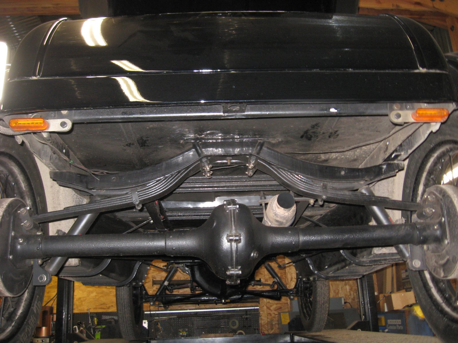

Pat what you have on your car is a cherry bomb glass pack,you can turn it around and it changes the noise.

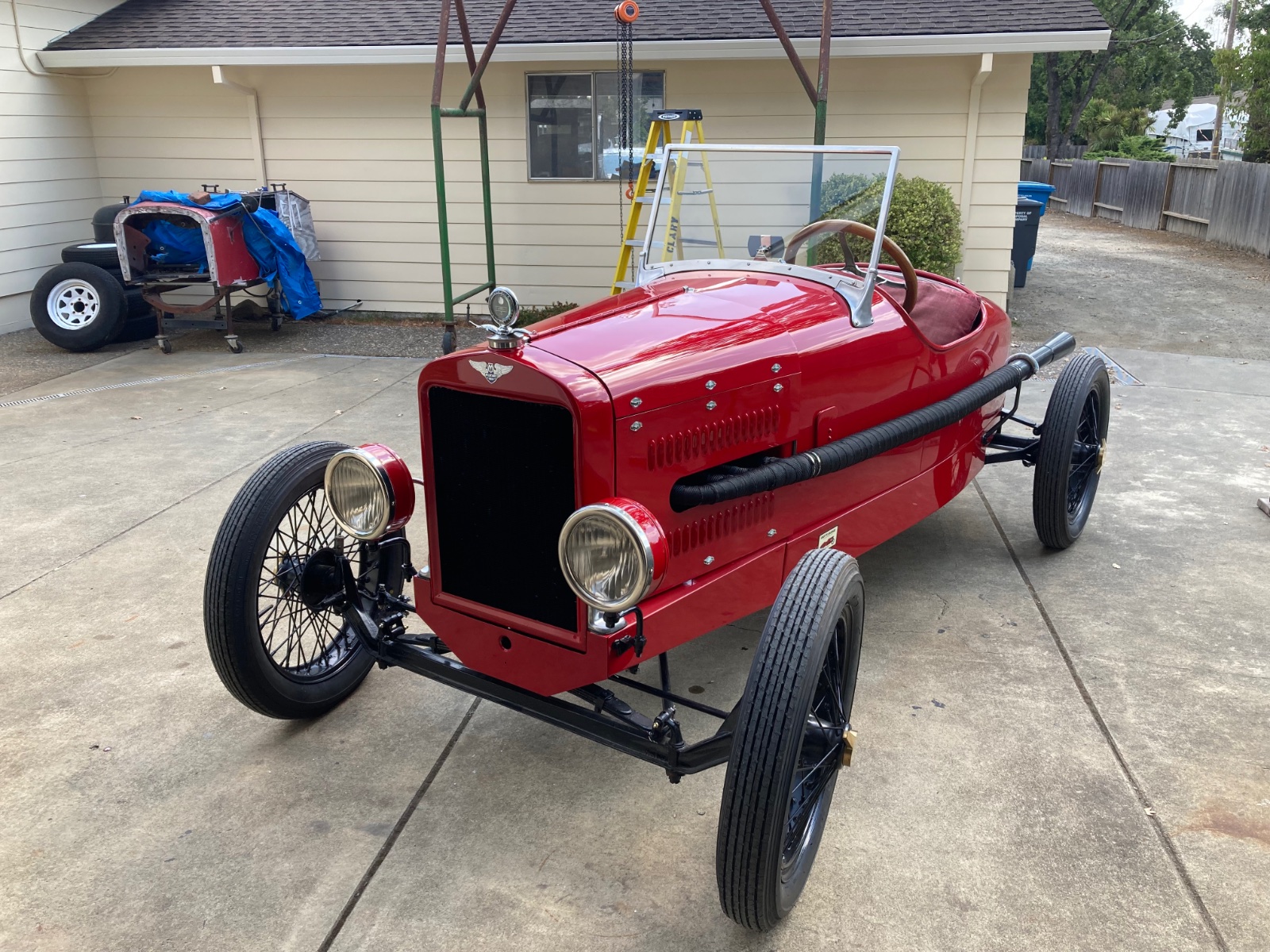

The purpose of asking this question is because I do want to make noise. It is for a speedster.
The tractor muffler FO-11 is very quiet even though it is a straight shot and you can see right thru it.
I have a friend who does not use a muffler, just a straight pipe and his car is not loud.
The speedster is red, so a cherry bomb muffler would look good on it.
It would be neat to have an exhaust like Humble Howard's Lucky 7, but that is not going to happen.

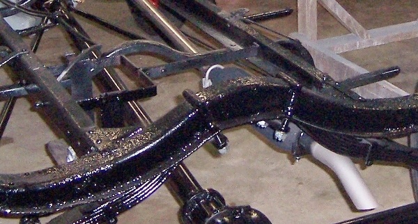

Put a straight thru resonator on once, these are short length, and both ends were 1.5" so no adapters needed.
Gave a nice low note, sounded hearty, with the tip down, on pavement you could hear the bounce sound, and on dirt roads would kick up dust from the turn down pipe!
