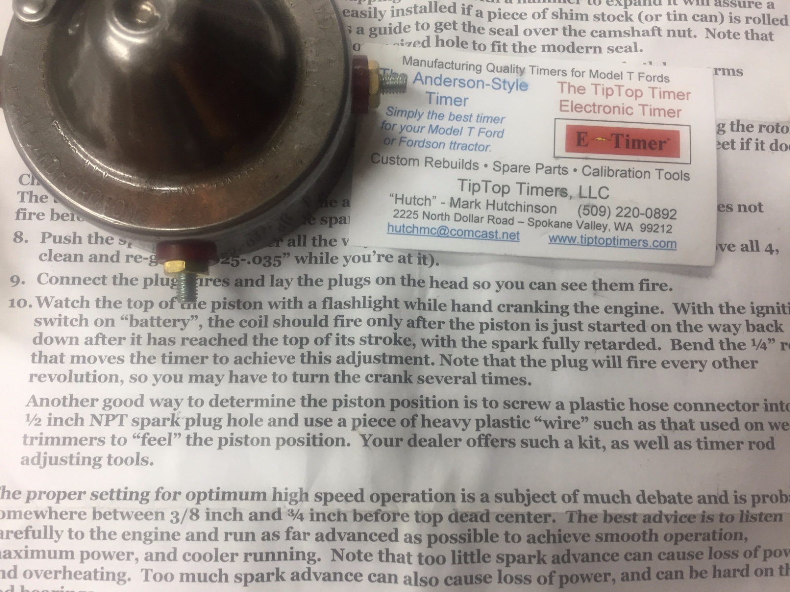

Post by jagiven » Fri Jun 14, 2019 3:48 pm
Steve, my technique was definitely different than yours. I just followed what the Anderson Timer paperwork said. It stated to set the spark when the cylinder was past TDC between 1/2" to 3/4". I thought it seemed like a long distance, but I will double check the paperwork, and readjust closer to 15o
I start the T on battery, with the spark fully retarded, then advance it once going.
I think I have only set the timing when I first got my T.
Posts: 4011
Re: Ignition Issues
Post by DanTreace » Fri Jun 14, 2019 4:22 pm
Need to re-read those instructions, the timer is set for initial timing of #1 cyl. when that piston is just PASS Top Dead Center. "...only after the piston is just started on the way back down after it has reached the top of its stroke" The best if you can hit it is 15 degrees past, tools can be used to do it, TRW has one, or the hint of the pin in the crank pulley, horizontal (9 - 3 o clock) is TDC, 15 degrees past is about 9:30-3:30 on the hands of a clock.
Those measures in the Tip Top Timer inst. for the Anderson are just comments on where the timing may occur at full speed, but that is advance, BEFORE the piston reaches TDC.
