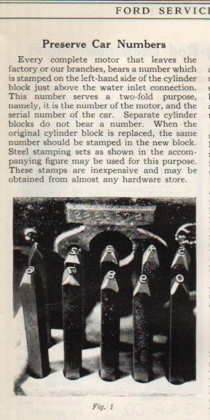

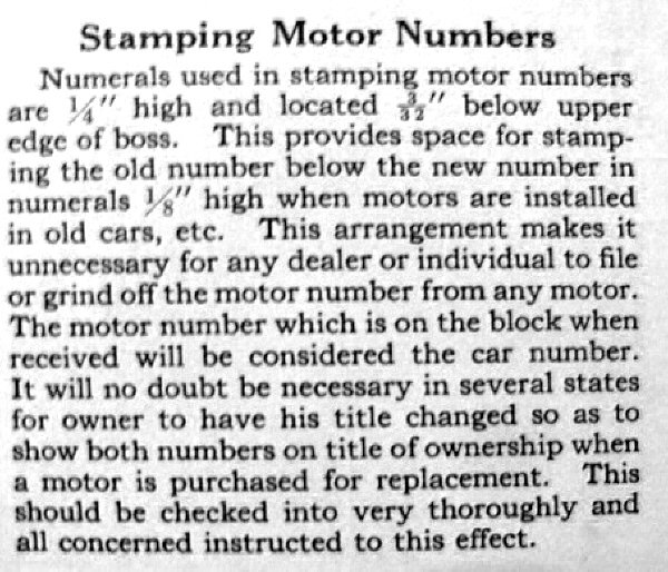

There is always some confusion when this question comes up. The serial number stamped on the side of the engine was always the car number, and was (or should have been) used on the registration/title. Beginning December 10, 1925, the SAME number was stamped on the frame. If those two numbers don't match, the car has a replacement engine. For registration/title purposes, I would go with the engine serial number. In such a case I would not confuse the bureaucracy by mentioning a different frame number.

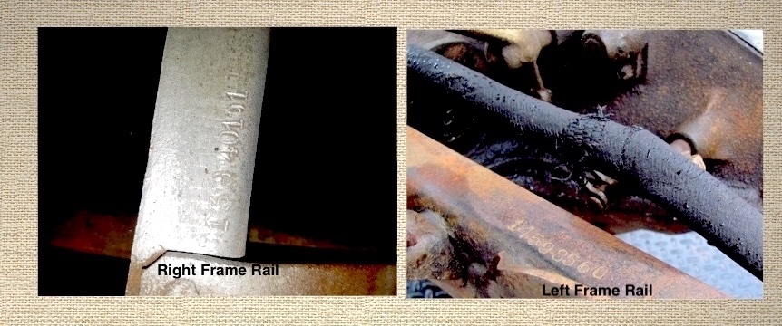

Have you checked the floor cossmember, just forward of the support rail for the seat? Most coupes I have seen have a body number stamped there. The body number was put in by the plant that built the body, and is unrelated to the engine/ frame number.

I have only seen frame #'s on the top of the right frame rail right under the big floorboard. Some claim the # could be in the same spot on the left side. You wont find a # 127.....

Post by DanTreace » Sun Sep 29, 2024 9:18 am
The car I have is a 19 26 coupe with an engine and frame number that match 137x7x24. The 127x6x39 number that is listed as the serial for my car by an apparent previous owner is not 1 number off. It is many numbers off. Hence why I asked where else there would be a serial number. It appears there is no other place unless it is on the crossbar.
Car is registered and I have title. This is not a registration or title issue just a sherlock holmes uncovering 'genealogy' issue
Your 13,7x7,x24 engine # is from late May 1926 production, and your frame # matches the engine #, and your title so all is very well.
Frame stamping first began on Dec. 12, 1925, and the frame stamp is usually on the right hand upper frame rail, just in front of the running board brace. Rarely it was stamped on the left upper frame rail.
Regarding any other document you may have, with the "other' #, 12,7x6,x39....that serial # is of an engine from mid-to late Nov. 1925. There would be no way this early engine stamping would be found on your 1926 Coupe.

An early Ford note.
Motor Number Stamps.jpg (96.23 KiB) Viewed 12817 times

Some states I have lived in years ago had both the Engine Number and Body Number on their titles.
Engine Number Stamp.jpg (48.49 KiB) Viewed 12815 times
J1MGOLDEN
Posts: 1322
Last Name: Golden
Location: Bowie, MD
Re: SERIAL NUMBER vs ENGINE and frame number
Post by J1MGOLDEN » Sun Sep 29, 2024 10:42 am
The problem this created was the dealers were not required to return the damaged block.
The block often went in storage for spare parts or in a scrap pile that was never sold.
During WW-1 and WW-2 and the great depression, many of those damaged blocks were repaired.
Several of those repaired engines went back in vehicles that later had to have a title.
Sometimes a title would not be issued, because a Model T in another state already had that number.
That has happened to a couple of my friends and one this year.
