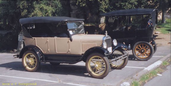

Post by Norman Kling » Sun Sep 29, 2024 7:51 pm
Powder coat works very good on the wheels, but you could use the Rustolium. Be sure to use the proper primer first and re-paint whenever they start to show wear. Easy to do with a spray can because the spokes are not as noticeable as smoother surfaces. Paint inside of rims where tires go also so they don't rust in that area. See pictures of mine. They were powder coated.

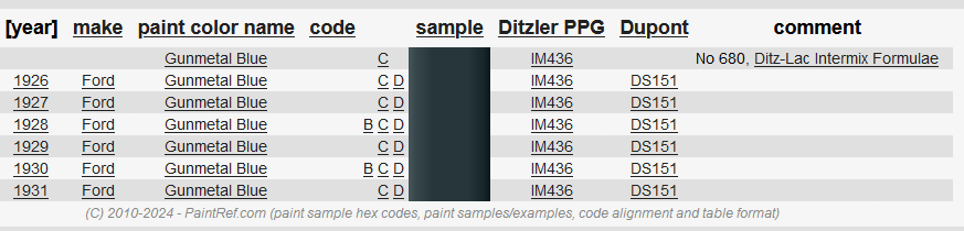

Post by TRDxB2 » Sun Sep 29, 2024 9:37 pm
Allan wrote:
Sun Sep 29, 2024 8:25 pm
Frank, I am not familiar with IM numbers. What are they? I agree computer images to show colours are mainly unreliable.
From https://paintref.com/cgi-bin/paintdetail.cgi?ppg=IM1246
IM1246 is a paint code for PPG (Pittsburgh Plate Glass) who has been providing automotive paints since 1924 (originally Ditzler Color Company subsidiary acquired in 1928). PPG/Ditzler codes starting with the letters "IM" indicate Ditz-Lac colored lacquers and polychromatics (fine aluminum powder added) and were used before 1940.
IM numbers are paint color codes https://paintref.com/cgi-bin/chipdisplay.cgi
In this chart it looks like they left off the I prefix and just M436

Post by Allan » Mon Sep 30, 2024 7:02 am
Thank you Frank. So they are paint colours as made by a particular manufacturer. So they have no relevance to describing colours made by alternate manufacturers.We have the same problem here.
I resort to Pantone numbers, universally adopted in the printing industry, to get reliable comparisons to real life colours.

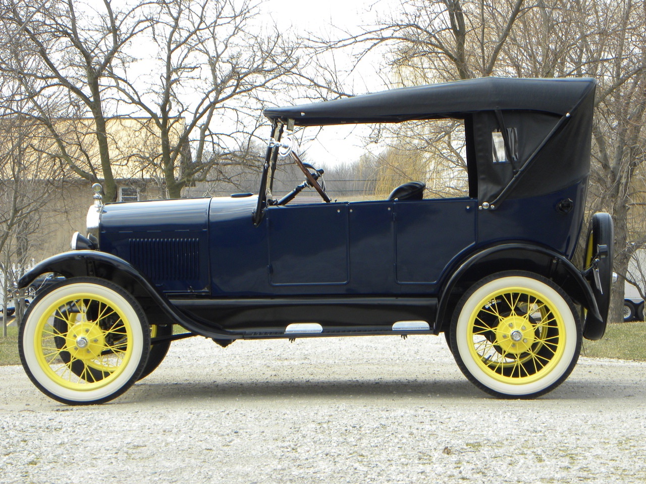

Post by jiminbartow » Mon Sep 30, 2024 10:33 am
Here is a 1926 dark blue bodied Model T touring with straw colored wire wheels. Normally, I think straw colored wire wheels look good with most colors, but not in his instance. I would recommend painting your wire wheels either the blue body color (if the blue is a dark blue), or black. If your blue is a light blue, I would recommend black only.

Post by ModelTWoods » Mon Sep 30, 2024 5:02 pm

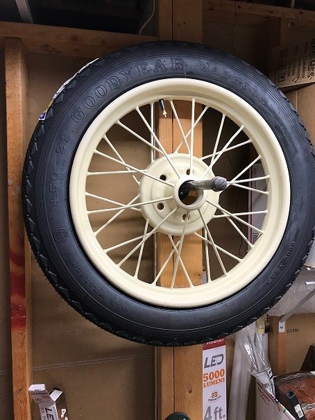

I wish that I had one of my wire wheels with me to photograph and post. They don't look as 'yellow' as the wheels on the blue touring that Jim posted. Prior to moving to the San Antonio area in 2018, I had lived in the Houston area, 70 years, and was a member of the Space City T's club. A club member, who was also a local Model A club member, offered to collect wheels and take them to Allied Powder Coating in Houston. Most members of the local A club used this company and Allied gave them a discounted price. I had my wheels done in the color the A members thought was the closest color match. I don't remember what code the straw powder coat color was. I wish that I did. After moving to San Antonio, I contacted a local powder coating company about doing more wheels for me. With one of my wheels in my hand, I looked at all the color samples this company had, and none matched the powder coat color of the wheel. Allied is still in business in Houston. Some day when I'm in Houston and have the time to go by their address, I'll take a wheel and try to get that code.

Post by Allan » Mon Sep 30, 2024 7:02 pm
I'm with you Terry. Those wheels are yellow rather than straw coloured. I believe straw coloured wheels should be cream coloured. Cream can be manipulated to be greenish, beige or lightly tan so you can make it compatible with different body colours.

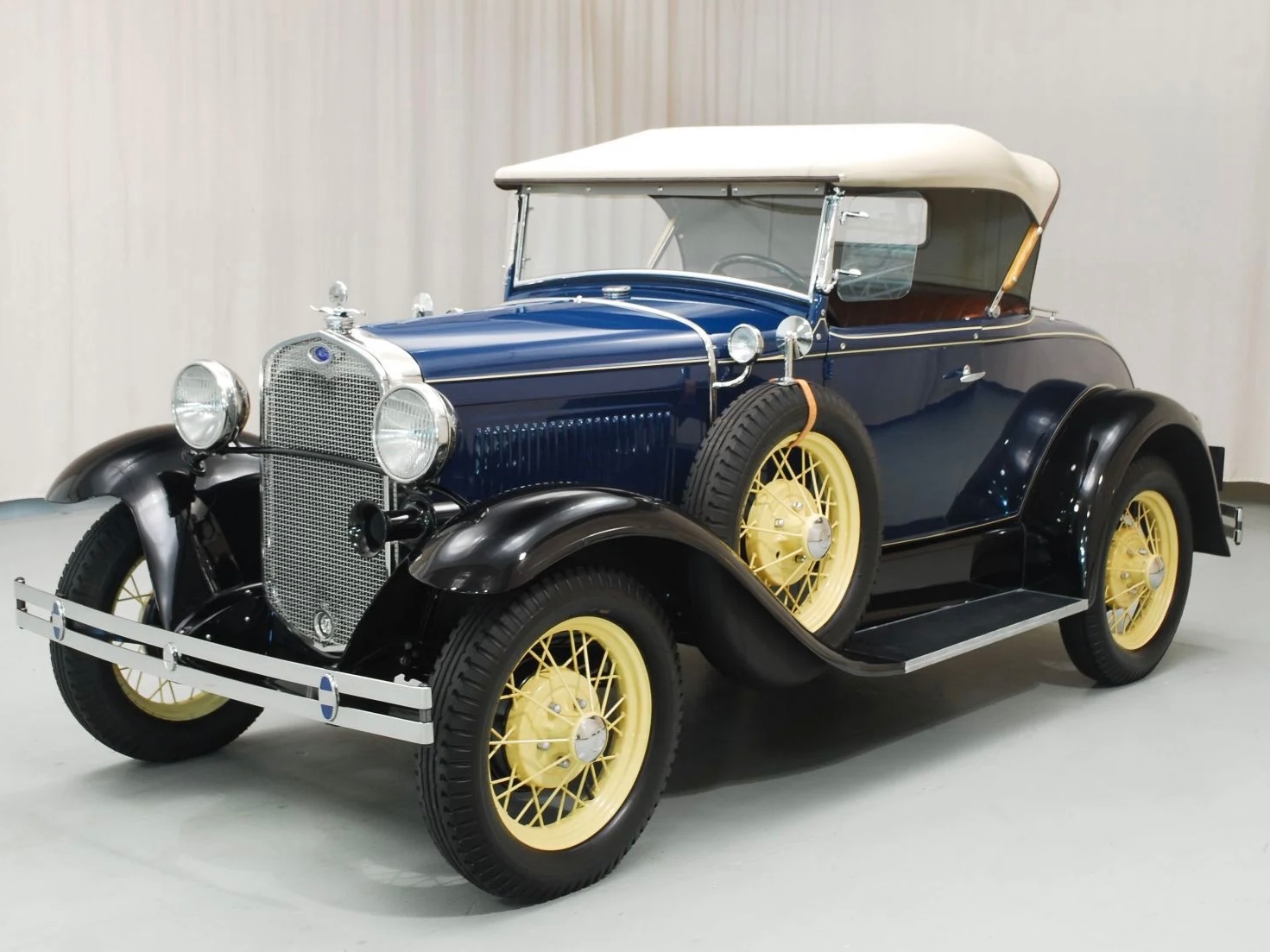

Post by Tadpole » Mon Sep 30, 2024 7:21 pm
Here is a very pretty blue Ford with “Wheat” or “Straw” wheels, very tasteful and period, especially with the matching pinstripe. I like it! Would look good on any 26-27 T!

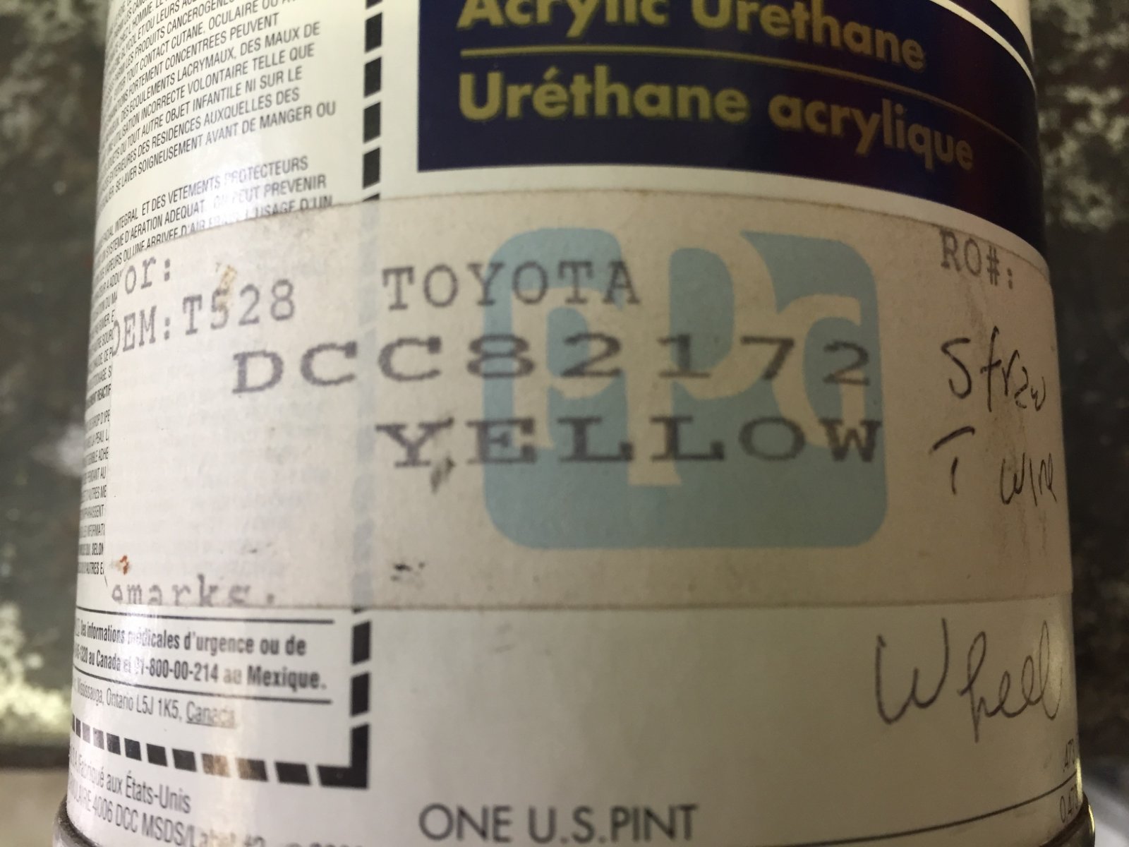

Post by rondupree » Mon Sep 30, 2024 11:14 pm
This is the straw wheel color as determined by PPG .
Note that it is a modern Toyota color

Post by TRDxB2 » Mon Sep 30, 2024 11:24 pm
The color, if the same as rendered, is what I have used on some wheels. Looks like the above.
It was labeled as International Harvester white (Rustoeleum Farm implement paint, no longer available see Krylon instead) . Looks a little like real butter.

Post by Wingnut » Tue Oct 01, 2024 9:08 am
Wow, never expected this in-depth response, very informative, I do like the creamy color. By the way, the blue touring is a carbon copy of our car, the wheels are a bit more yellow than I would like. Thanks to all, Wingnut
