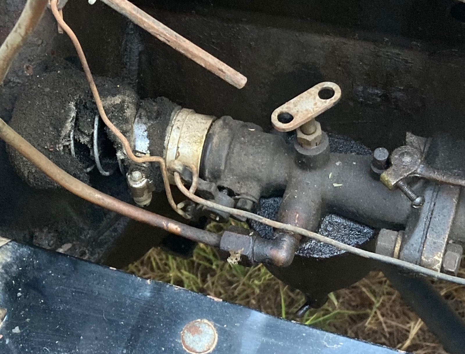

… I didn’t :oops: The foam crap needs to be replaced occasionally. I haven’t driven the roadster since the 2019 Covered Bridges tour where it performed flawlessly. So the other day I figured I’d wash off the dust. Air the tires and pour 2 gallons into the gas tank. Also serviced the radiator. Primed her 3 times with ignition off and she started strong on the 2nd ignition on crank. Had a ball driving several miles but wouldn’t start the next day…… This is what I found…the rest of the crap foam filter is in the carburetor. I’m realizing now that roads are infinitely less dusty than 100 years ago and Ford never offered an air filter so I’m gonna throw these remnants into the lake

Ford did have an air filter; Put your engine splash/dust pans back on. The radiator fins filter out anything too big.

Plus, the hot air tube from the exhaust manifold to the carburetor filters out a lot of crap.

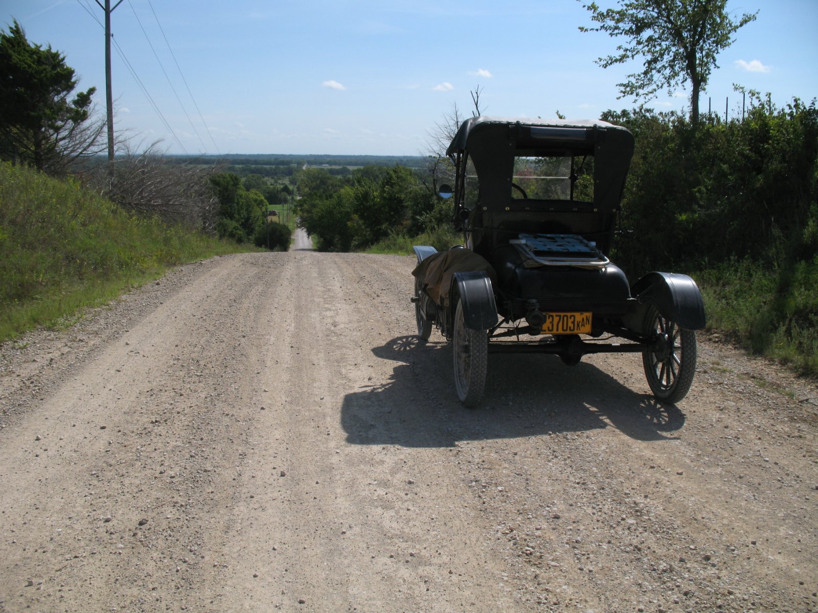

I’m realizing now that roads are infinitely less dusty than 100 years ago...
That depends on where you are.

I'd replace the filer with a new one. Dirt is everywhere, all the time. Engines wore out in a few thousand miles "back in the day", and lack of an air filter was a significant contributor to rapid ring and cylinder wear and valve troubles. Dust particles can stick to exhaust valve faces and cause them to run hotter. The valve is hot enough to fuse dust onto the valve face and the head of the valve, where it makes a pottery-like substance.
I've had several years-old old foam type filters disintegrate on lawn mowers and ATVs. They need replaced from time to time. Washing the foam in solvent may make it deteriorate faster, but after a few years, it needs replaced, regardless. The best filter is a dry element Donaldson type, and venting the carburetor bowl to the inlet pipe between the carburetor and the filter is a good idea.

A hot air pipe is a good thing to have in cold weather or cool, damp weather. Some kind of manifold heat AND an effective air filter is much better!
The best arrangement is an inlet air heater, air filter, and hot spot manifold, and compensated carburetor bowl vent.
