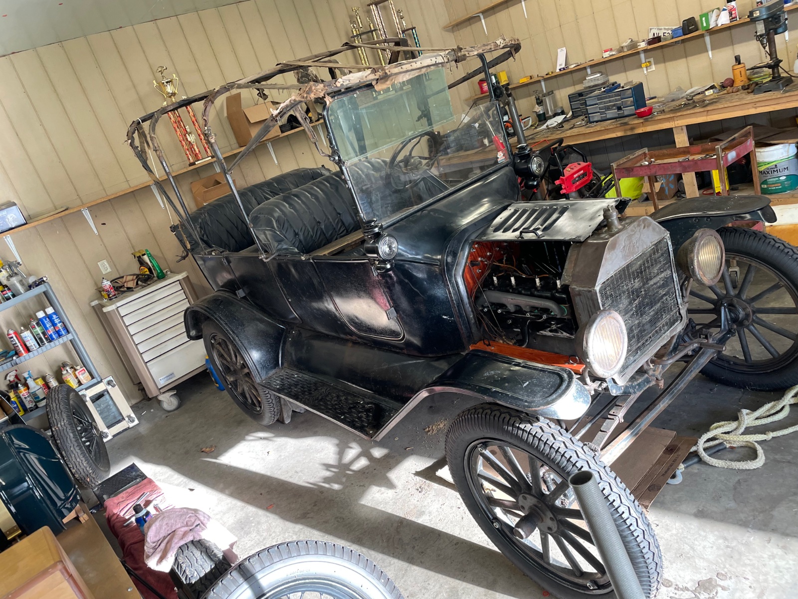

Greetings!
My name is Emerson Cobbs, and I am currently living in Osceola, Arkansas. It being the small town it is, a productive autumn project seemed like a good idea to keep busy, and I had always wanted a brass car. I found this vehicle on FB Marketplace in Sikeston (though the car was purchased new in the Bismark, MO area and spent its life in the same family), and now it is parked in my garage awaiting what will hopefully be a future filled with touring. However, I know very little about mechanics or minor body restoration (figured this might be a good way to learn), have never been around a model t before, and want to make sure everything is hooked up right before I even try to fire it up. I figured I would finally become a card carrying MTFCA member and send this post out to see who might be in the Memphis/Northeast Arkansas area who might be able to help ground me with a better sense of direction. I’ll attach some photos as well. Trying to get this car not concours-worthy, but correct enough for it being a 1915, and certainly ready to hit the road. Engine block # is 651477, though a Missouri identifier tag on the cowl lists the VIN at 707337, which leads to suspect an engine swap at some point(?) Thank you and looking forward to getting this bad boy correct looking, complete, and ready to roll.

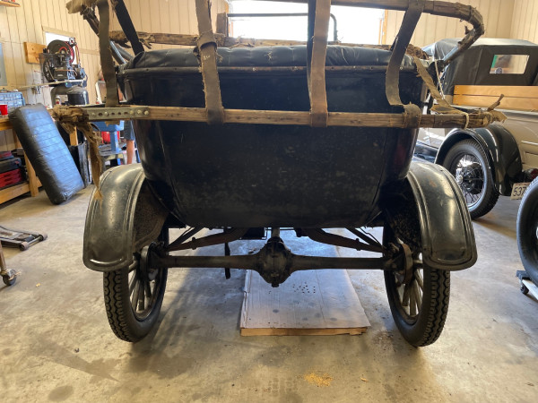

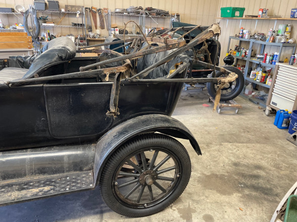

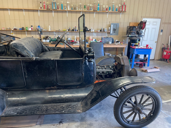

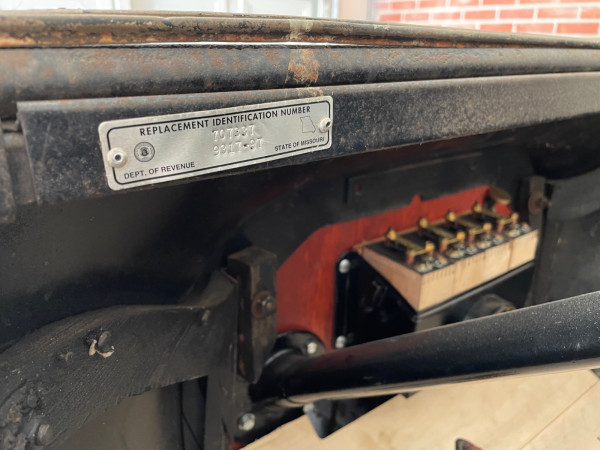

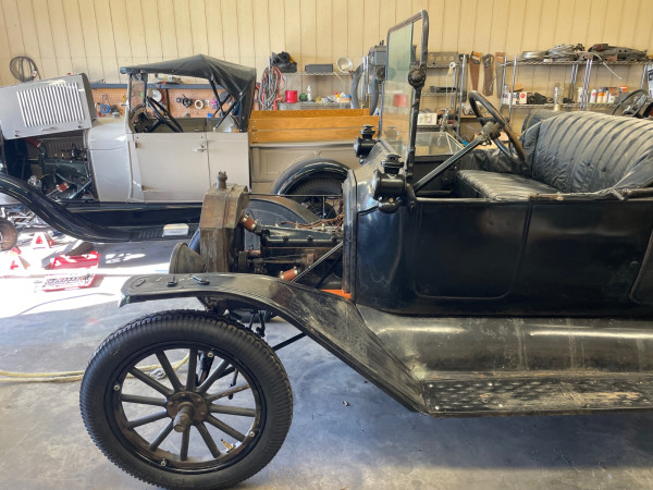

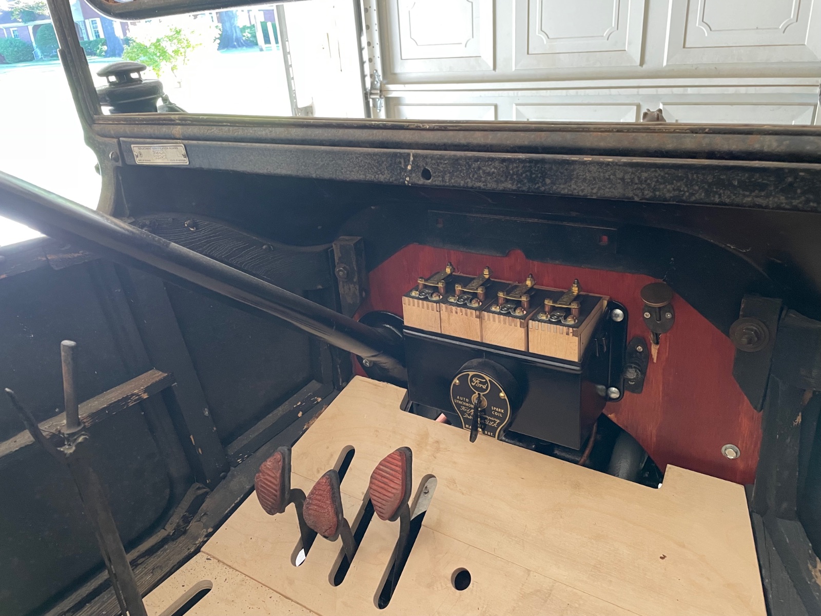

Here are the photographs…If someone would like additional photographs more can be readily made.

Emerson, your engine serial number translates to Wednesday, December 23, 1914. I suspect you're right about it being a replacement. If the cowl tag uses an engine serial number (taken from a title?) its date would be Monday, March 1, 1915. That's definitely in the 1915 model year. It seems the car has been updated with a few 1916 features. Just figuring out the ID is sometimes complicated enough to be a separate hobby. :)

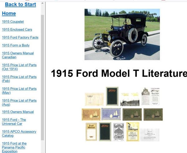

This web site has various manuals for all years that are downloadable https://www.cimorelli.com/mtdl/1915/default.htm - print off a parts list
This is what's available at that site

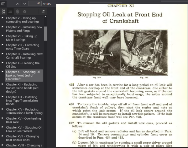

#1 get a copy of the T1 service manual. It covers any repairs & service you will need.

Th link to a PDF version is above - no cost. Print off what you need & don't worry about pages getting dirty

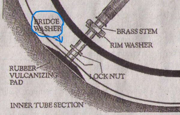

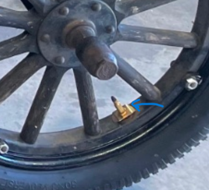

Something that will need to be fixed before any driving, the bridge washer is meant to be fitted inside the tire on the tube.

Welcome Emerson, your T looks like it's had some recent work done and will not require a lot to get it running and drivable. The closest chapter to you is probably the Tennessee T's in Humbolt. Tennesseets.weebly.com

I wish we lived closer together so I could see your car. I am not as well versed on the particular differences between the 1914-1916 models so will let others comment on those. If it were mine, I would first focus on the drive train. Get the engine running and try out the transmission and brakes. Check the spokes on the wheels. The spokes should not be loose and the wheels should not wobble. Get the front axle and steering parts tight and properly aligned. Check the diagonal measurements of the frame from same point on front to opposite rear and see if it is square. Then check for sag in frame. Many times it will sag on the right side at the crankcase mount because the torque of the engine and the brakes will all push down at that side. So get the frame as straight as you can. Check out the ears on the crankcase to be sure they are not cracked. So get the mechanical parts working as good as possible. Radiator should be clean and without sediment or rust particles from the head or block. Check for cracks in the block with water leaks. If you leave coolant in during freezing weather be sure to use antifreeze.
Concerning the body, All the cars until 1926 have a wood frame for the body panels which are nailed and screwed in place. So, especially if it was parked outdoors with a bad top, you will find damage from rot and termites and other wood boring insects. So thoroughly inspect the wood and if severely damaged, replace. Minor dents in the sheet metal can be pushed out from the perimeter of the dent to the center. Tap gently to get it as straight as possible. Rust out can be repaired with welding or brazing and sometimes welding in a section. Some of these body sheet metal parts can be purched at swap meets of reproductions can be had from the parts suppliers. All body panels should be primed on the inside as well as the outside so any water which gets inside will not cause rust out. Small drain holes should be in very bottom of body panels so that any water that does get inside will drain out.These holes will be at bottom so will not show from outside of car. File or sand out very small dimples or imperfections from the body after the dents are as smooth as you can get them and finally use sanding primer to fill very fine imperfections. If bondo or other filler is used, try to minimize the use because it can crack later on and a big chunk of paint will chip off with it. Remember if you want a smooth finish all imperfections must be sanded out before the final coats of paint are applied. The final coats will not fill in pits or dents.
You definatly need a new top. You can buy a kit from most suppliers or have a to company make one for you. The top bows need some work before installing a top.

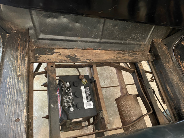

Do I see a battery??

Your car has a 1917-22 windshield as someone else pointed out. What they didn't point out is that it is mounted backwards. The top pane should fold towards the driver. You can turn the windshield around or swap the hinges from side to side. The side curtain clips on it indicate that is from a 1919-22 or your car started out as a 1919 -22.
Rear fenders are 1917 and later as someone pointed out.
The top irons are 1918-22.
Looks like your car has a later fron end, due to the wishbone.
If you take photos of the interior of the cowl and/or you find the body number and date on the floor riser, it would be easier to determinte the date of the body.

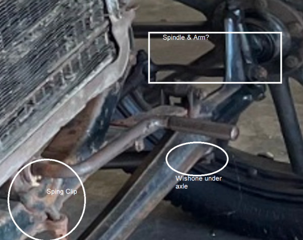

Post by TRDxB2 » Sun Oct 06, 2024 2:21 pm

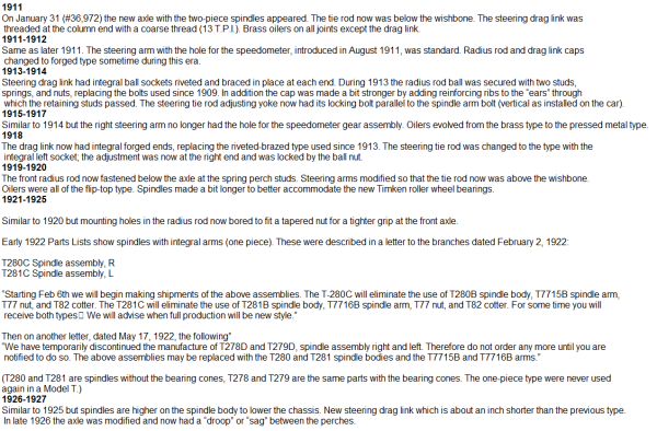

Don't feel overwhelmed by the inconsistencies of parts to be a 1915. There are many reasons for this to have happened over the last hundred years or just in the last 15. You may want to print (computer file) off some of the differences & correct items and file them so you know what you have, and what you might want to do about it
To begin with, many parts are upward/downward compatible, so its not unusual to see later year parts on an earlier car. So don't gt to bothered by that. Other things like a windshield mounted backwards should be corrected
For example on your front axle, as pointed out the wishbone (radius rod) is the later under axle style. The front spring clip (front engine mount) is also a later style. My guess is that the spindles are a later style and the front hubs use tapered roller bearings. Since you are not interested in a perfect 1915 these differences are using the better design of the parts as changes were made. If there was something to change, would be the most obvious out of place item, the front spring clip. Other inconsistencies take a keen eye & knowledge - and if it doesn't bother you keep it that way, its your car or fun!

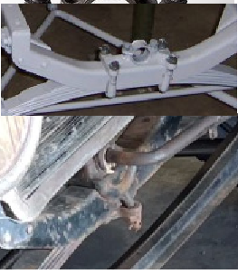

front engine mount.png (92.66 KiB) Viewed 11898 times
The spindle differences are about making removal of the inner bearings easier with the flats. So what you have is what you want because replacing them means special tools to fit new bushings. So when you need new spindle bolts or bushings you can make a decision then if necessary.
This is from the MTFCA Encyclopedia and points out the evolution of the front axle over the years

There have been many later model Fords, that have been converted to so called 1915's. I hope yours is not one of them. There are a number of posts that indicate yours may be one of them.

Lots of things may have happened to your car in it's life that required parts replacement - many times that meant going with what was available or simply "the right price." Don't be discouraged by that. Owners would also modify or update their cars to suit their whims or needs. This forum is a great resource and hopefully someone will speak up that lives close enough to you to be of help.

Strangely, the rear axle is early 15 or earlier. Wouldnt expect that in the typical made up 15.

Emerson glad to have a young fellow involved, we need more of you! Lots of good advice & help with information you can download. The best so far is starting with your focus on the drive train. Take your time, be patient, read & ask questions. Many of the folks here have solid decades of experience. You seem well grounded in what you want to accomplish and remember it’s not a sprint but a marathon. A major goal you should consider is to end up with a safe, reliable driver. What you may be unaware is a strange occurrence will likely happen when you open the garage door & find another model T with no idea how it got there. That’s what I’ve told my young bride, that’s my story & I’m sticking to it. Recruit some of your young friends to help you may have a friend or two that just helping you they’ll may get hooked too. Nothing better than several friends getting together for a day drive on a weekend. Best of luck! John
John, rear axle could be a late 12- 14. I think I see rivets around the differential housing.

I say possibly early 15 because I have seen a few with the 14 & earlier style riveted rear end as this one has.
Yes normally considered 12-14 style.
My early 15 wide track roadster has a 13 casting rear end with a 2 piece DS.
Due to the rarity & last in first out inventory, I believe it came in my T originally.
Who's to say for sure?

Actually the newer style wishbone mounted under the axle (the earlier one was over the axle) is stronger. A problem with the wishbone above the axle is when you hit a curb pothole hard you can bend the spring perch and change the castor of the wheels which can make the steering suddenly pull to one side or the other and much harder to steer. So unless you are going to have the car judged, it is safer to leave alone. In fact many cars have reinforced the wishbone with an aftermarket brace to mount under the axle.

In my earlier post I forgot to mention as others have pointed out some of the parts on your car may be from other years. That’s the thing about T’s! Ford built them in such a way that lots of parts may not look the same but would work on Model T’s from 1914-25 and maybe in the improved 26-27 T’s. That’s why down through the years folks would car to an auto wrecking yard to find T parts that would keep them T going. Ford made over 15,000,000 Model T’s and used parts were pretty common. Yours is like so many others in that respect and that’s OK. After you get your car running and serviceable you can then start figuring out what parts if you want to change to get your car in the 1915 range. Take your time in doing that and really get to know about your new T hobby!

You need to get a copy of Bruce’s book. It will tell you more than you want to know. 15 is a very interesting year, lots of changes going on.
I think it is one of the hardest to get right.
One thing to note is what Larry said. Many later straight windshield cars were made into 15 cars. Some say so people could tour with the HCCA. They have 15 or older rule.
None the less still looks like a solid car. Good luck with it. Don’t know how close you are but I’m in Birmingham Al.

I appreciate the wealth of response and information guides, and will try and connect with the folks that are fairly close!
I will try and get some better photos of the interior tomorrow…me and my buddy spent some time removing the mice and squirrel(?) nests this afternoon, and chasing the moths away.
As with many vehicles which have spent their entire life in the Ozarks, especially knowing my great grandfather’s stories of the same, it does not surprise me that the parts on this vehicle cover a diversity of eras. What sold me (and at least convinced my novice mind it is at its root a 15) was the family documentation of this vehicle going back to when it was first purchased, along with registrations and title transfers: the oldest I received being from 1948. It seems this car was kept on the road regularly for a very long time, and repaired as it could be in rural Missouri. I will try and look for a date tag on the body!

Here are photos of the “interior.” Yes there is a battery bracket! This has added to my confusion

Emerson, that is a seriously home made battery mounting on your car. This may mean that the chassis is a true 1915 item rather than a later one made to accept the factory battery bracket. You will have fun finding out all this stuff as you learn more about your T.

The body of your car is much later than 1915, indicated by the notch in the cowl just above the coilbox, the horizontal strap/brace above the coilbox and the angle iron brackets attached to the body and the firewall (they are somewhat obscured by the wood blocks). I would say the body is approximately 1919 or later.
Look for a body number stamped directly on the passenger side floor riser or stamped on a metal tank nailed to the floor riser.

It appears the body number stamp/plate is either gone, or I haven’t found it yet…somebody seems to have gone through it at one point with a power washer, and the wood is quite surfaced

“It” being the passenger floor side riser

You might want an umbrella because it looks like your sun roof is stuck open. :)

Based on the photos of the front axle, I would suggest that you start squirreling some money away for a new radiator, or if it's possible - a recore ( I don't know all that much about brass Ts). Welcome to the affliction!

You’re showing some other antique cars in the back ground of your photos. If you can work on those you can work and LEARN on the T you bought. When you buy a T you can learn by working on them. Most of the folks on this forum did just that. DONT get discouraged by reading the other comments! Some on the forum are what’s called in the hobby PURISTS meaning everything on a T has to be totally correct and they will spend years trying to find the correct part. That’s OK if they want to do it that way.
Others like myself and MANY others aren’t and want their cars to be good drivers mechanically, look authentic and have fun with. My cars are around 90-95% correct and look pretty good in my mind and that’s what’s important in the long run. I don’t try to please everybody on the forum.
If you were to ask the average folks about your T and is it right they wouldn’t know the difference other than it’s a ModelT.
You don’t have to get a full workshop to at least get it running! Do that first.
Try to get your car started and see how it runs at the very least. Have a positive attitude and try to get it running. When you do revaluate your car and time and then decide what to do with it. GOOD LUCK AND HAVE FUN AND LEARN BY DOING IT!!!
