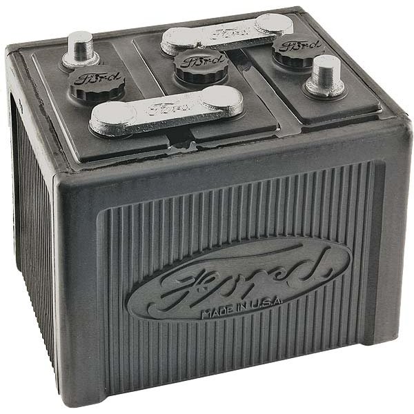

Eckler's used to sell a repro 6 volt FORD battery whose dimensions were 9-1/4" long x 7-3/8" wide x 9" high. Height is measured to Top of posts & 550 cold cranking amps. I some further searching and found that the BCI (Battery Council International) Group Size is 1. This battery size will best fit the physical dimensions, terminal locations and type required for your vehicle. A 19L may be too big to fit in the space available. Check it out

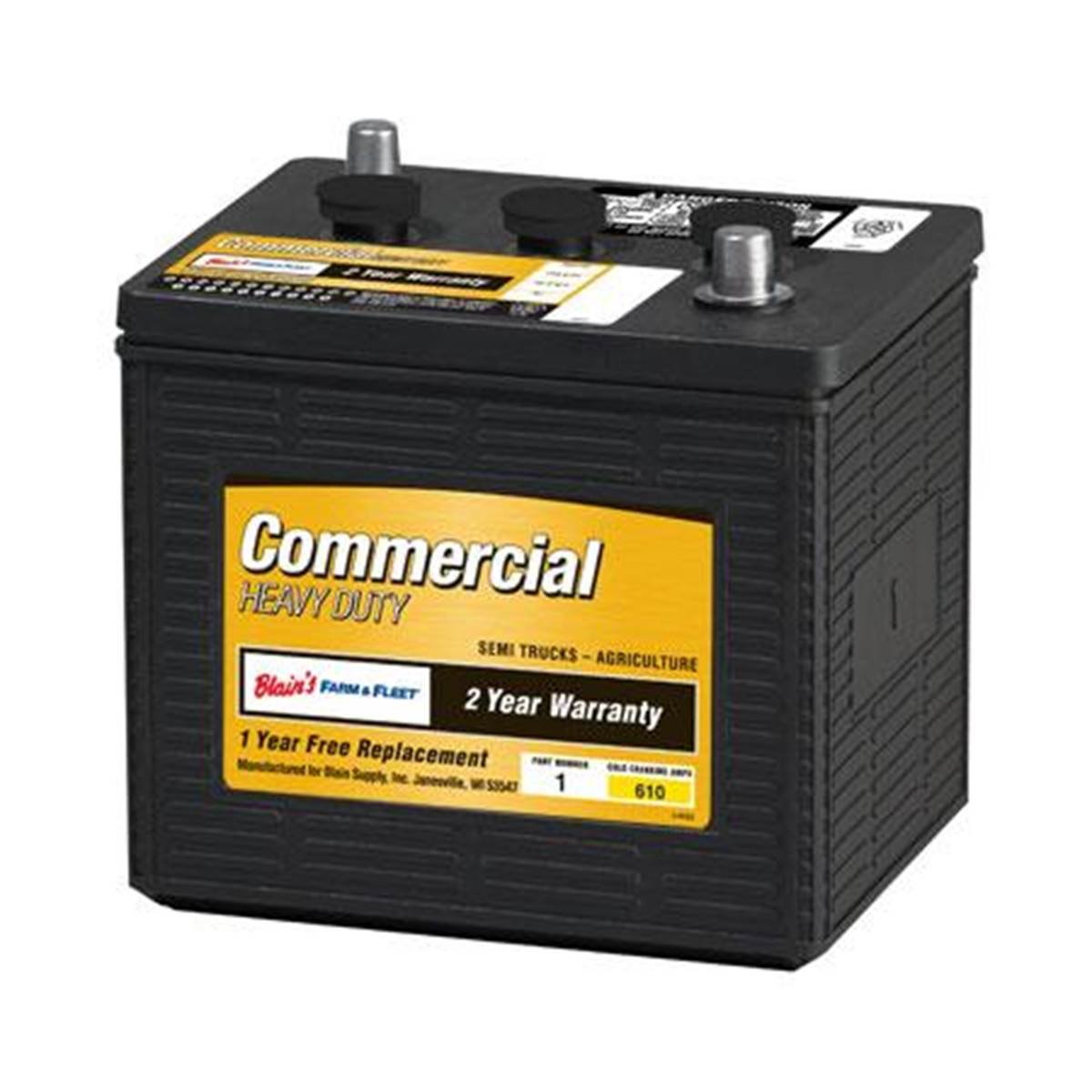

Just one more thing -- Blain's Farm & Fleet $59.99 after $10 exchange Dimensions:9" X 6-7/8" X 8-3/4" Group Size: 1 Power: 640 CCA
