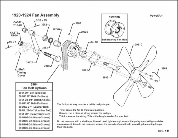

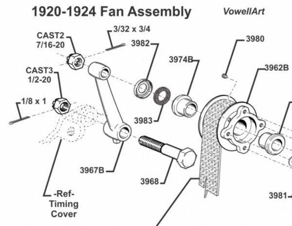

Here is an exploded view..

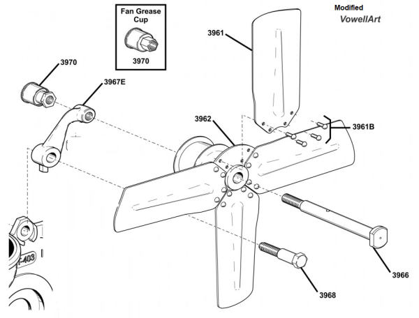

Hi Jonathan,
If your 1919 has has the correct fan ( brass hub W/ riveted fan blades ) The bolt/shaft 3966 should a hole in the center for grease & the 3970
grease cap acts like a lock nut to stop the shaft from turning so you can set the shaft so it is not tight on the fan bushing. If you have the later aluminum hub w/the screws holding the fan there is a plug for a grease zerk between the fan & the belt. I grease mine every trip.
Craig.

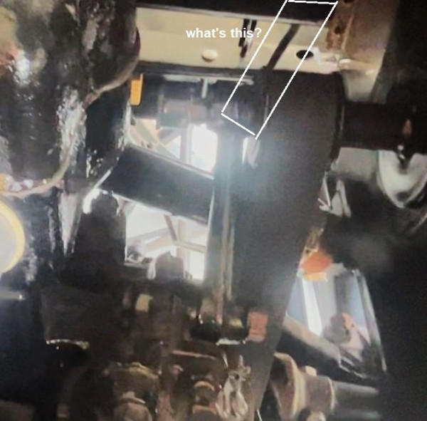

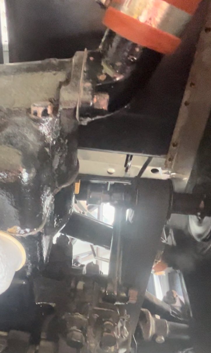

It looks like you have a mix of parts. The fan assembly T-3962 and a FAN SHAFT Part # T-3966 with a fan shaft 3967B.
So the question is is the fan shaft threading into the fan support arm your using ?

TRDxB2 wrote:
Tue Oct 08, 2024 1:19 pm
The boxed in black thing that you questioned is a headlight wire, I am bad at managing the wires
