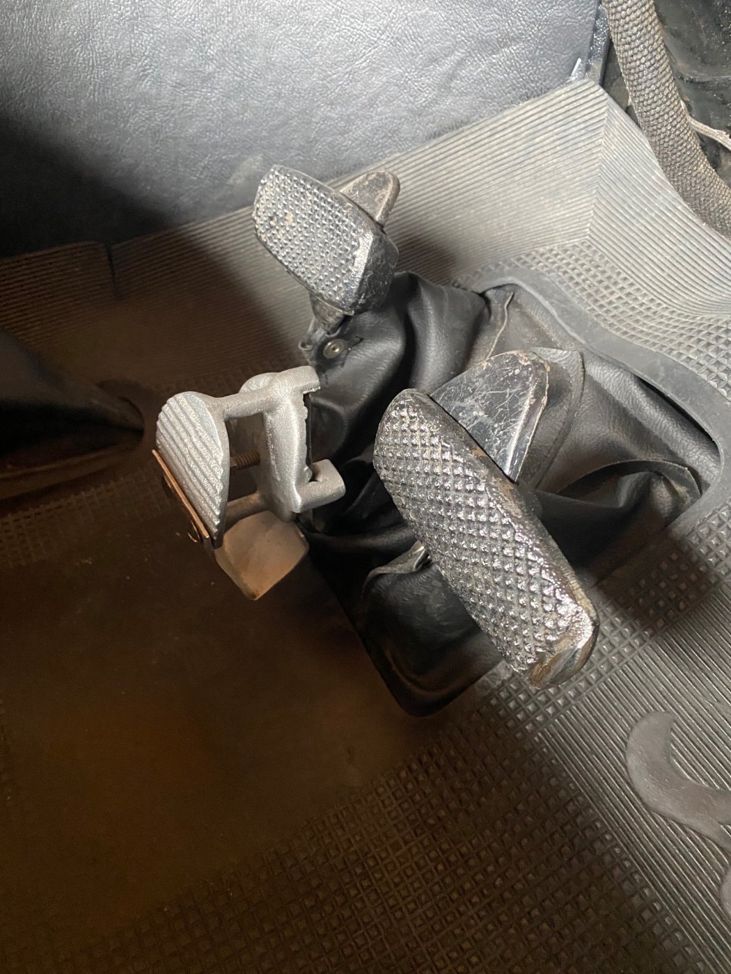

I have huge feet - 14 extra wide. I use extenders on all pedals.

Ot- Oldavi8tor, I like your pedal grommeting that you have. Did you make it yourself?
