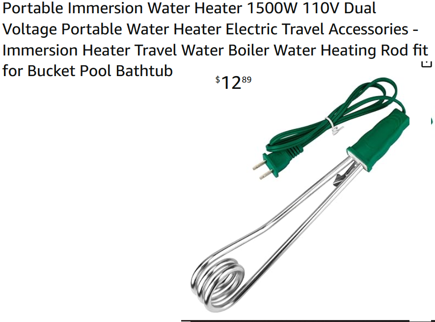

During the summer when I was in collage I worked for a mechanic that was in the Luftwaffe during WW2 (prisoner-of-war somewhere in Iowa & an escapee from East Germany). To degrease parts he'd fill a metal bucket with water, place the parts in it and the heat it with a immersion heater similar to the one pictured and let them soak for a while in near boiling water. His secret ingredient was a cup of oil dry, some how it soaked up the oils that floated to the top.
Heat melts the grease. Dawn & similar products use "surfactants", chemicals that reduce the surface tension of water, allowing it to penetrate and lift away grease, and soap that breaks down the grease into smaller drops so it can mix with water.

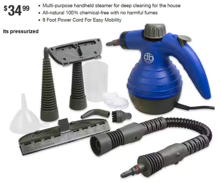

I also have a steam cleaner that works very well after you scrap of the layers of "barn cement" (grease/oil mixed with mud & fine dust)

TRDxB2:
Who makes that nifty steam cleaner, and how can we order one? Thanks!

Post by John kuehn » Sat Oct 12, 2024 8:49 am
Amazon has budget friendly steam cleaners along with Harbour Freight tools. Not bad for the prices either.

That one is sold by Home Depot. In looking at the one that Harbor Freight sells I'd say its the same tools & function just a different housing. They only use about a cup of water but generate lots of working time. I scrapped all as much as I can then steam it off. Place a large Rubbermade storage container under the item to capture the mess.
Separate process to be environmentally proactive. I pure all my water based toxic wast into a 5gal plastic bucket. The liquid evaporates and at some point I'll take the bucket to the recycling center.
Instead of using a power washer and the contaminating the area - I'll take the item to the self service car wash & used their power washer, soap cycle & drain :o
