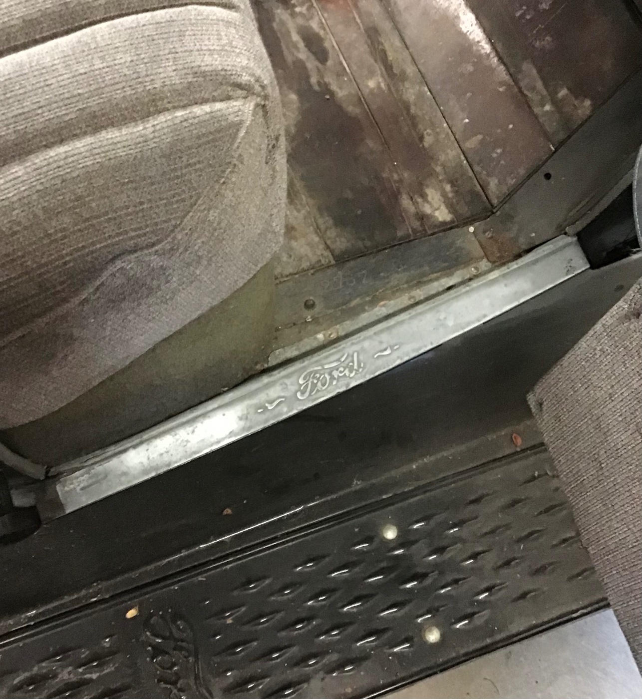

Post by John kuehn » Mon Oct 14, 2024 6:29 pm
Here’s a picture of the sill plates in my 24 Coupe. I’m pretty sure they are original to the car. Yes I think they must be zinc as Allan noted. They seemed a little different than aluminum. The 24-25 Coupes are pretty much alike until the 25 had steel framed doors instead of the wood framed doors. The floorboards are original to the car also. I started to replace them but decided not to since this was my Grandfather’s Model T.
