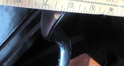

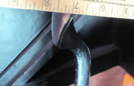

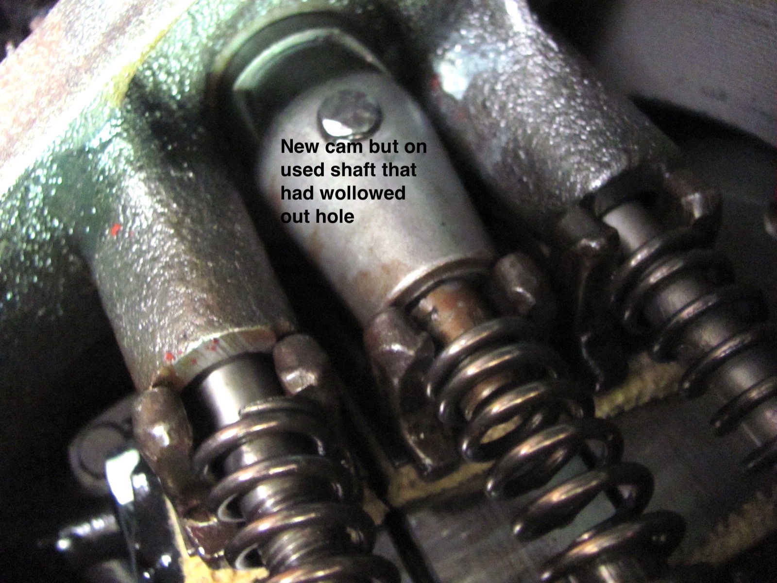

Had similar occurrence, engine was rebuilt, however the low pedal used was original, and installed with a new slow speed notch.
The shaft likely had its hole wallowed out when removing a used notch, and the new rivet seemed to secure the shaft, but no.
When adjusting the low pedal band, the pedal kept moving, at least an inch, back and forth by hand.
Did the proper fix, pulled the hogshead, replaced that used pedal shaft with new shaft, and re-riveted the pedal and slow speed notch.
