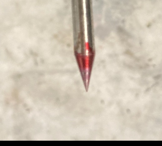

I got the nut to go in more so I ended up with at least one more turn in of the spray needle. I marked up the needle tip and ran it down all of the way to see witness of it closing. Does this look good for a bottomed needle? The picture shows that the first half of the needle bottoms out in the spray nozzle seat.
- Attachments
- IMG_3504.jpeg (47.21 KiB) Viewed 2658 times
- Posts: 5263
Re: Engine flooding, running rich, black smoke
Does it run with the needle closed? Is there an adjustable range where you can get the idle to stumble when closed & @ a point when unscrewed several turns?
