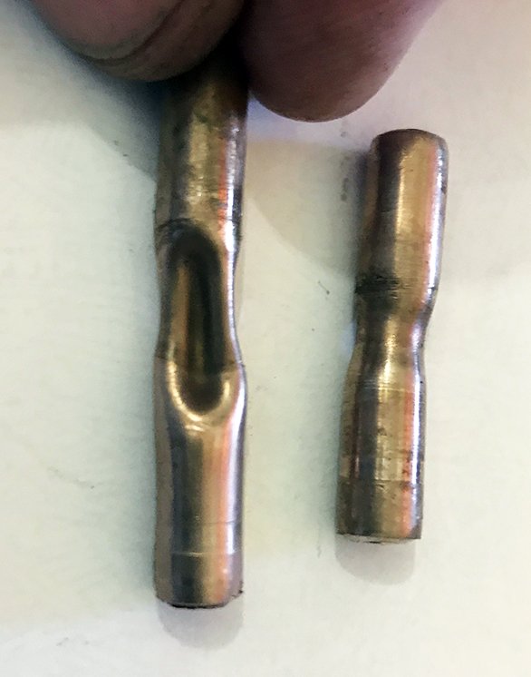

I used Nickel - copper line at first, now I use steel brake line. The Ni-Cu started leaking....when I removed it I found that both ends (sediment bowl & Carb on/off valve) were deformed. I used neoprene packing on both ends.

I put on the fitting and rubber before I flare the line, then when I tighten it everything is squished together for a nice seal. Aviator, it looks like it stretched on you?
- Posts: 2340
- Last Name: Juhl
- Location: Thumb of Michigan
Re: gas line
I installed it without flaring - simply compressed the neoprene by tightening the fitting. The left pix was the end in the gascolator - it never leaked. The other was in the shut-off, it did leak. I removed the Ni-Cu line after 3300 miles of use so it took awhile to deform.

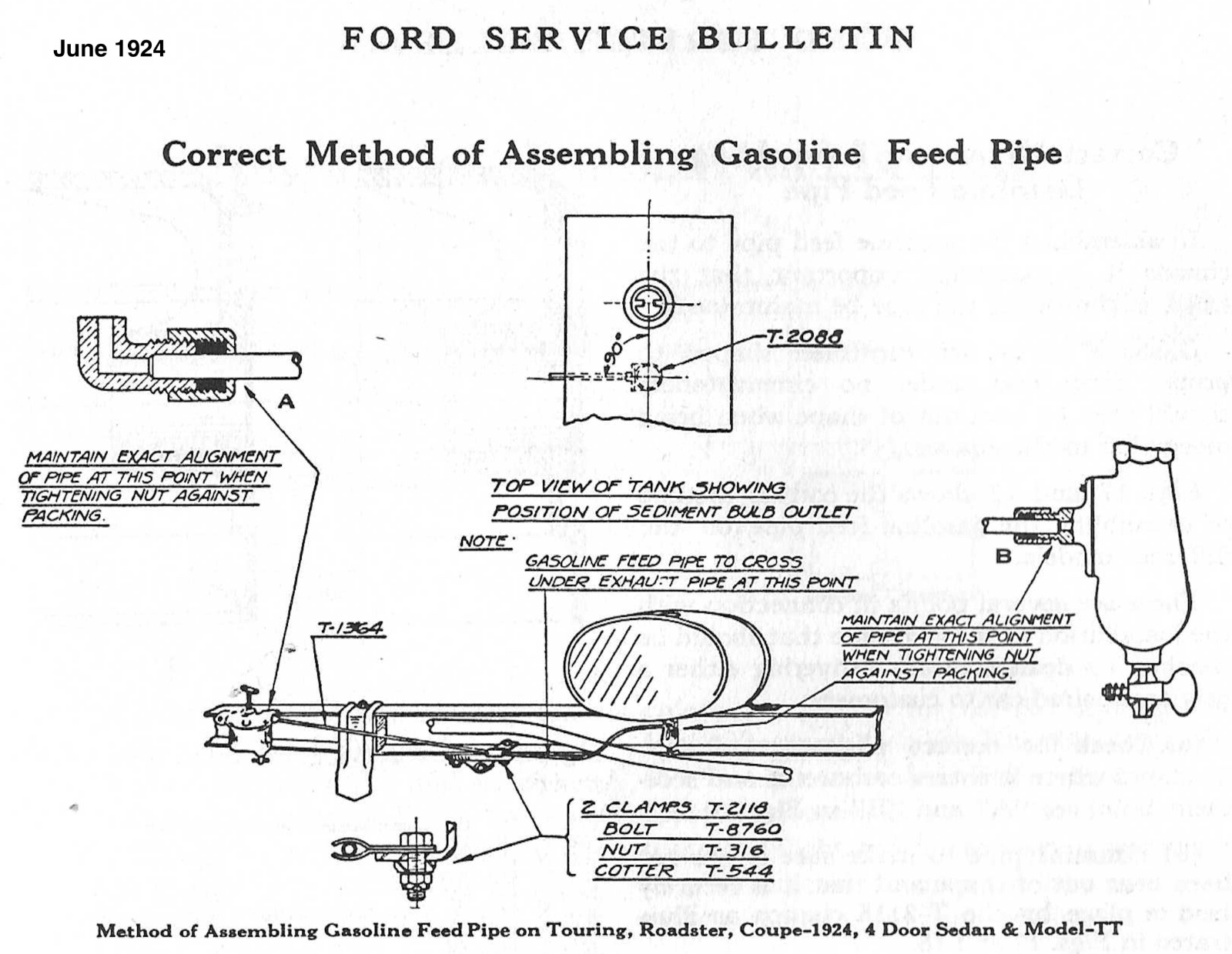

I understand the fuel lines were always brass. What puzzles me is did they zinc plate the tubing?
- Posts: 4114
Re: gas line
Believe the sweating of added material was done on the seamed made tubing, that was rolled together to make a tube, and sweated the entire length was done to seal the seam.

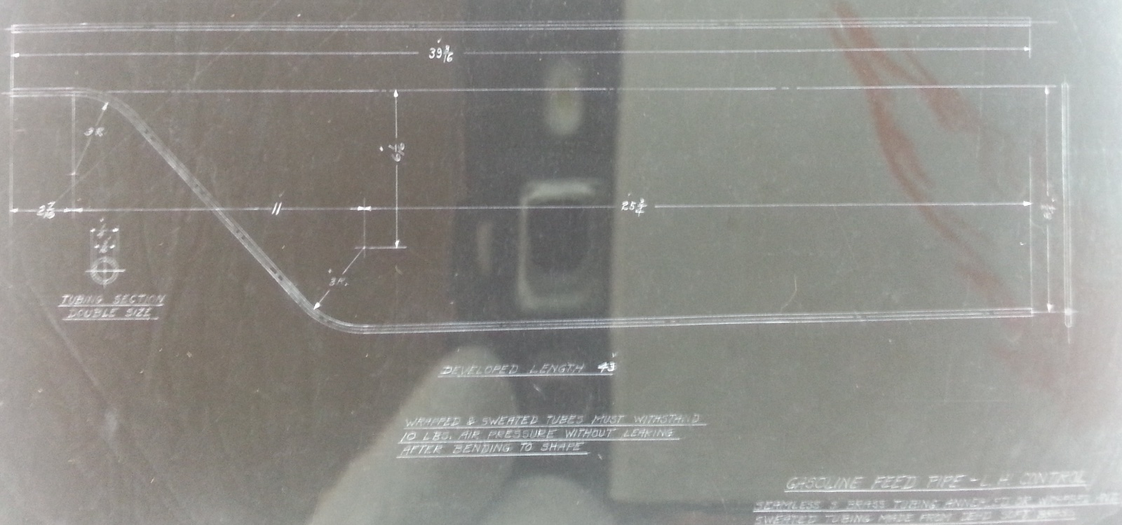

Here is factory print, note the center comment on finishing the seam tubing. The print in lower right also calls for seamless tubing, under that is the seamed, button be hard to read this print. Print is from the webpage of Benson Ford Center, where one can find a few of the Model T and Model lA parts prints displayed.
Seamed made from brass , dead soft. Seamless from brass tubing annealed.
click on image to enlarge

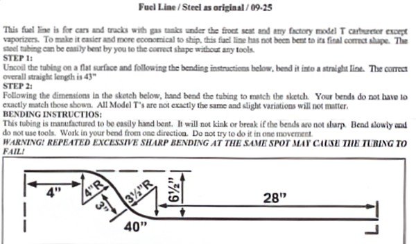

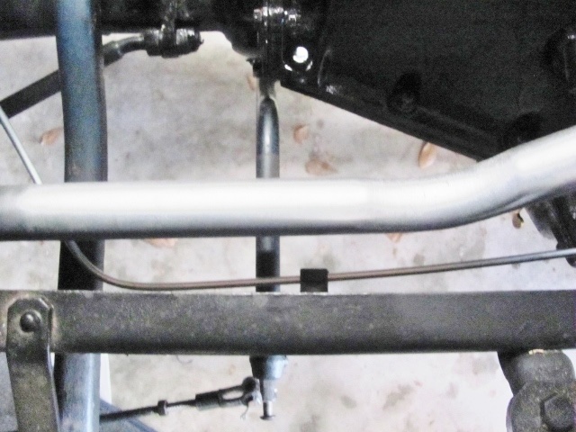

The gas line being sold by dealers is steel and 5/16th in diameter with no seam and comes with the bend photo above.
More important is for it to come forward and go in front of the exhaust pipe at about the angle in the paper above.
Then 2 or 3 inches has to be cut off after the line is in the sweet potato.
- Posts: 4114
Re: gas line
Gas lines sold by at least Lang's are avail in both steel (item #2909) and brass (item # 2909BR. ...for about 4x the price of steel) , all are 1/4" dia. tubing., 43" straight length. Bending the gentle curves by hand is easy with steel tubing.
Like to use the later '24 Ford instruction on lacing the line, that is simple as the line goes not under the wood block, but between the frame and hogshead direct to the carb.
The bend under the gas tank should be so there is about 2" clearance for eliminating issues of heat transfer.

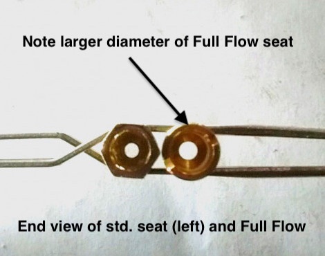

As for the diameter, using anything larger than 1/4" tubing gains nothing.......the line goes to the carb, the carb float needle seat controls the volume of flow, not the fuel line size. If you want the best performance, use Scott Conger's Full Flow Needle and Seat, that is the correct Ford size, all the other repro seat diameters are smaller than factory.
Full Flow

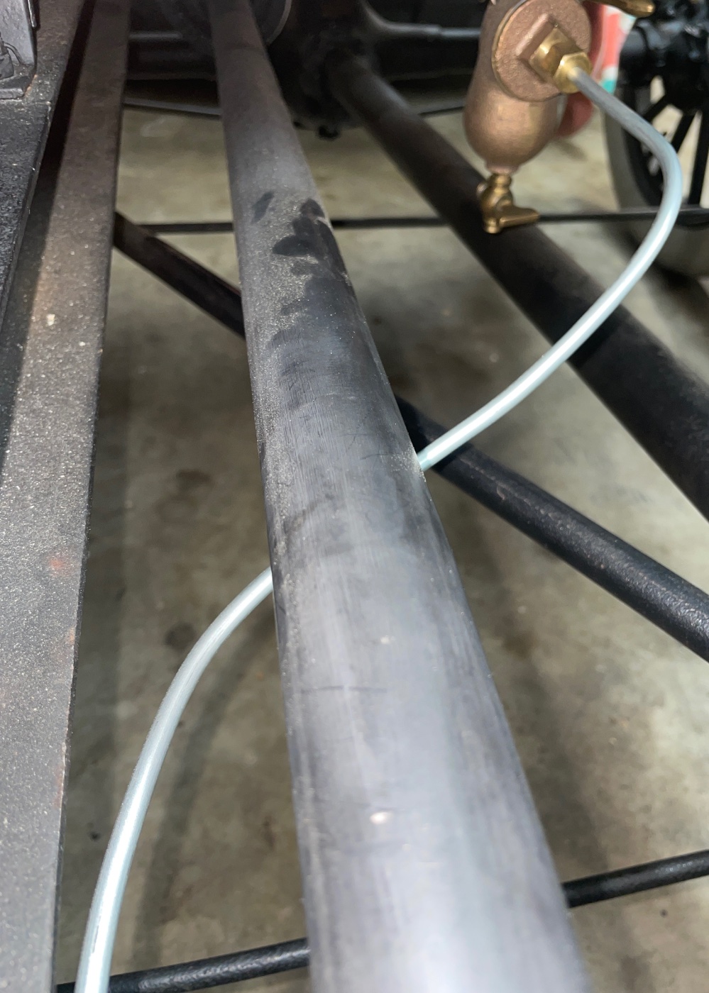

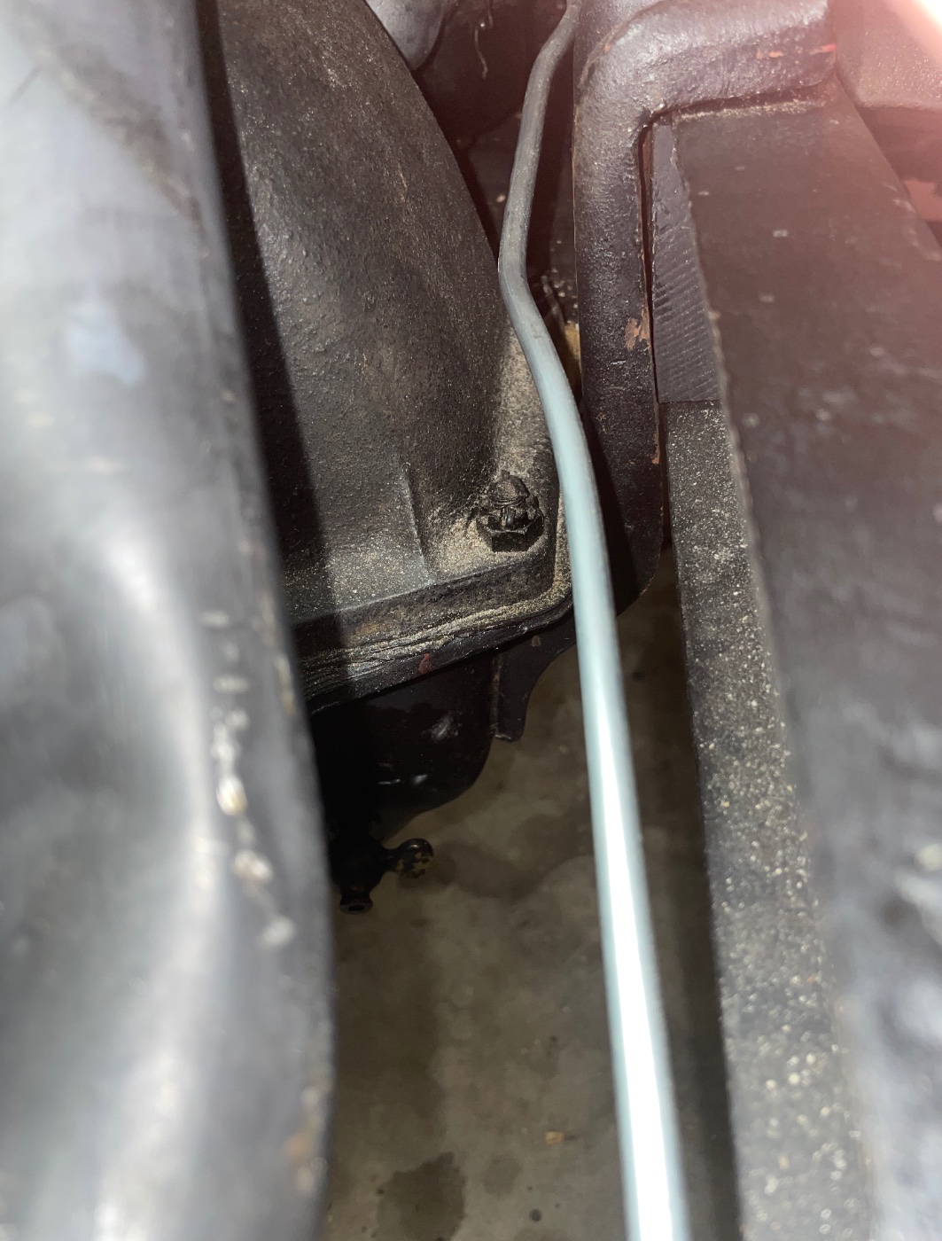

With my experience with our vendors, fuel lines do not come pre-bent ..... They do include instructions. Here's a copy from one of the vendors.
- Attachments
- 669638~2.jpg (43.86 KiB) Viewed 6600 times

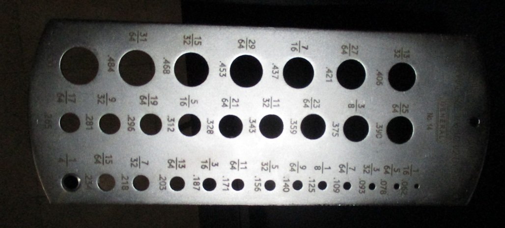

Well, I was wrong again!
The size depends on whether it is a tubing or a pipe!
My measurement was 1/4th for the outside diameter or 5/16th for the inside diameter.
The gas line will fit in the 1/4th hole, but will not slide through it with my General gauge.
The inside matches the 5/16th hole.
