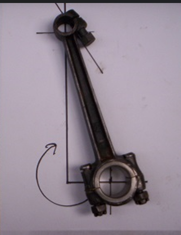

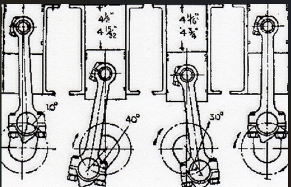

To put it simple, rods fitted with the bolt facing the cam will have the pressure points of thrust pushing on the strongest part of the rod clamp.

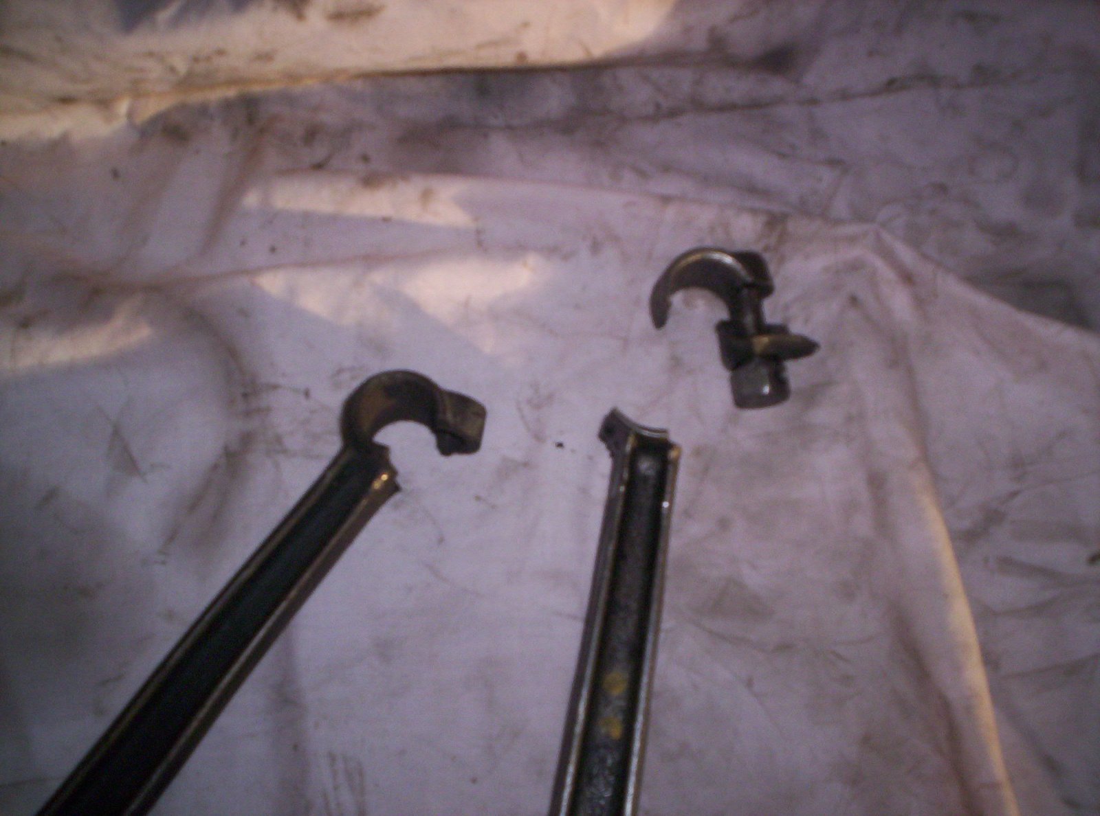

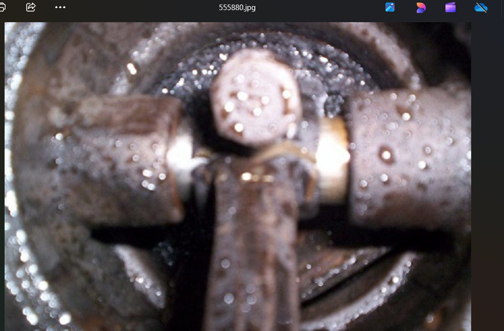

A rod fitted in reverse will have the pressure points pushing on the weakest point of the claw, the power stroke thrusts the piston to the cam shaft side of the bore and then reverses on the up stroke putting the pressure on the bolt, either stretching the clamp bolt, breaking the head off the bolt and even breaking the rod clamp itself.

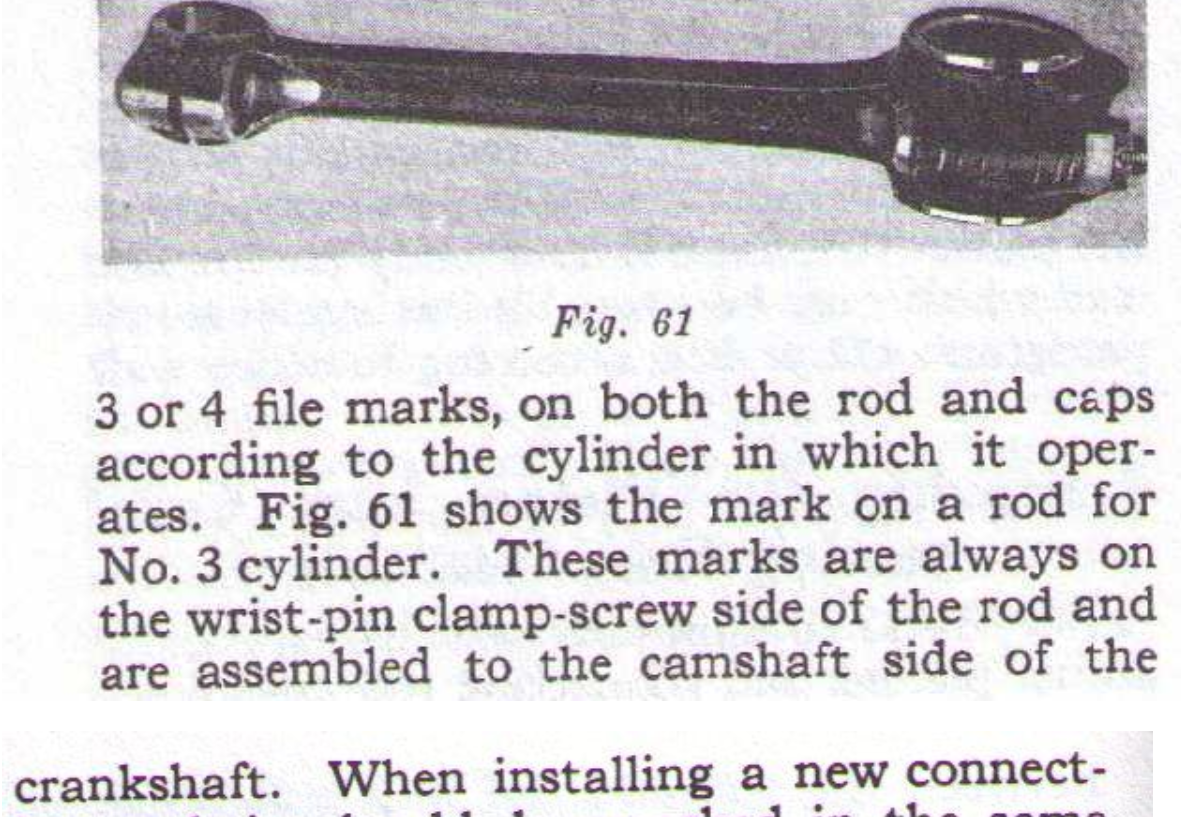

The service book page 98 has after marking a rod, the markings on the rod and cap should be on the same side as the rod clamp screw. Then in the service bulletin volume 1 page 71, Assembling pistons and rods in the motor, the number markings face the camshaft side of the motor.

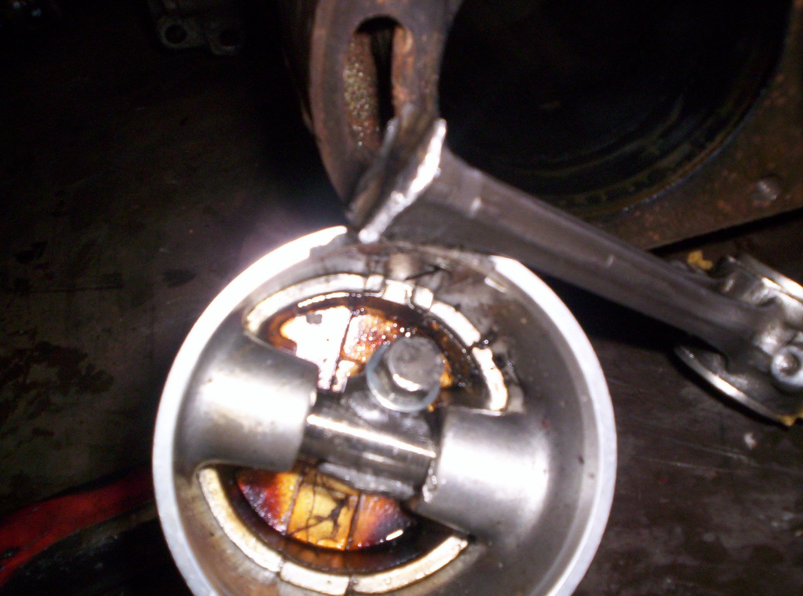

Regardless on which way the rod is fitted, it is 100% reliant on the bolt, it just so happens it is more likely to fail when fitted away from the cam side. Ford even has in the service bulletin that if the bolt tension is compromised, the claw clamp will fail.

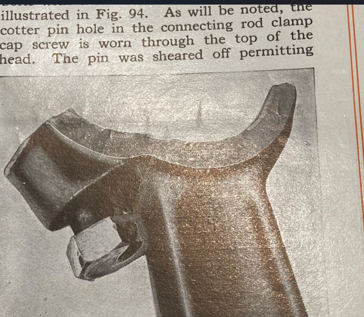

Unfortunately, thoughts and opinions could be costly, Ford states which way a rod is to be fitted just like which way a head gasket is to be fitted, imagine how thick a service book would be if going to explain all the science of the engineering, but Ford just kept it simple to have a correct assembled trouble-free engine.

Thanks for finding and posting that!
