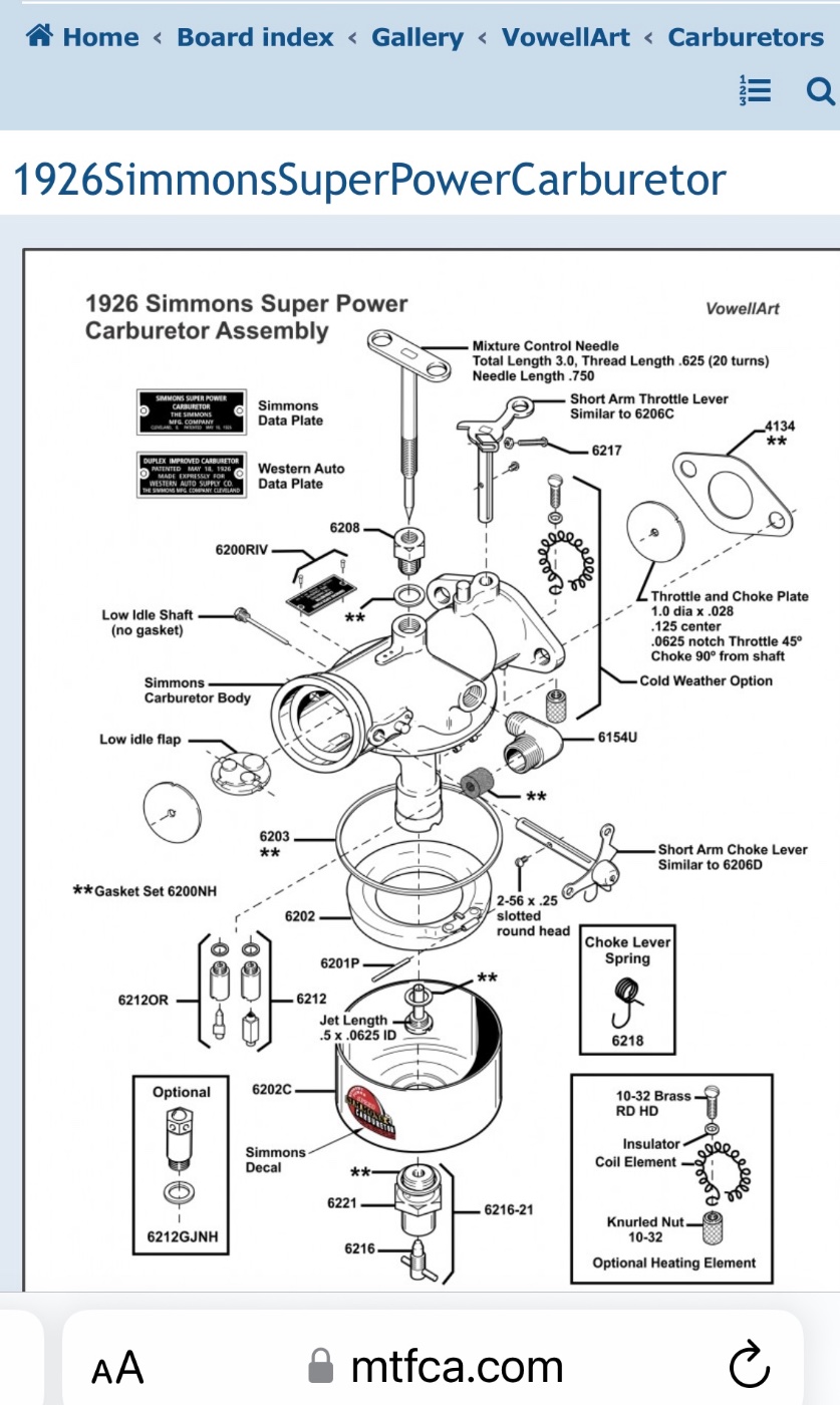

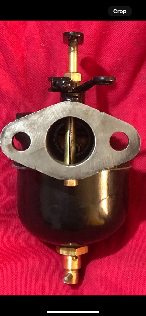

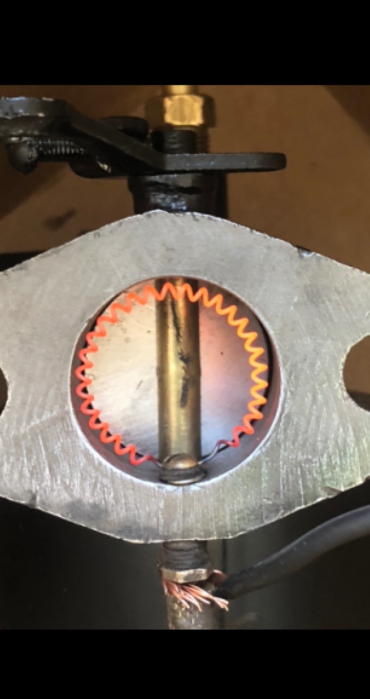

Photo courtesy of Corey Walker.
Drawing from the MTFCA Forum Gallery

Someone did for Dan's photo.
There is no smoke or fire.

Re: Wanted Info. On Simmons Carb.
Jim
That Simmons is a test photo, was away from any gasoline, and wasn’t mounted under the hood
I’ll be wary of one with hot coil on a T

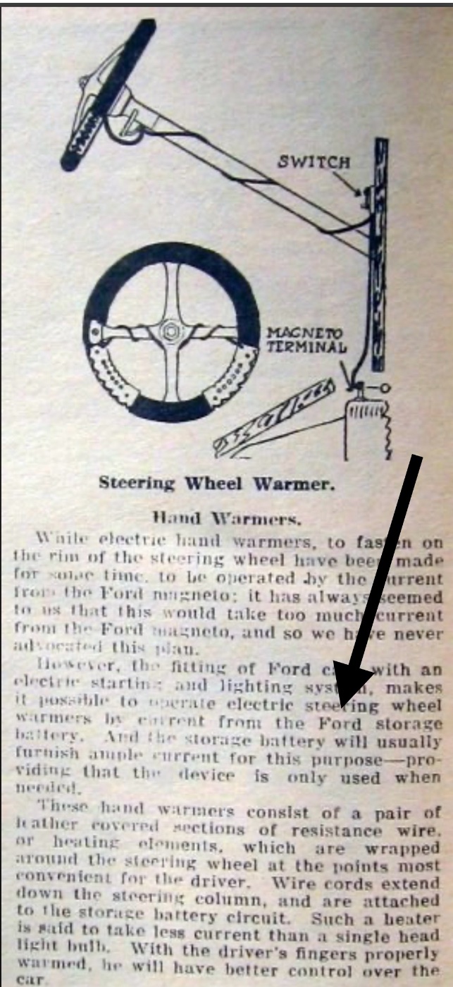

Brendan
Wiring would be simple to the coil terminal. Run wire from + terminal to an on-off toggle or push-pull switch. Then from switch to the Simmons coil terminal. Switch on to energize the coil for heat prior to starting. After engine warms, switch off the coil.
Purpose was to preheat the old time gas to help starts.
Wiring diagram similar to heated steering wheel wraps, sketch shows AC magneto for +, but storage DC battery is best.

I’m not sure I’d use the element, I just wanted to try it out. When you remove it the hole is already the right size for a 10-32 tap and then I put a screw there to plug the hole.
