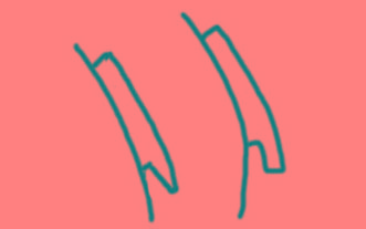

I did this over 40 years ago to my 1911 aluminium HH I have both button and blade type bands (two sets one of each which I replace with another if needed.)
The blade type work OK in my RHD though on the brake band I had trouble getting the lower blade hook into it's slot due to the tight gap between the drum and HH, so I modified it by opening the slots as per the diagram.
On a LHD HH cutting of the low speed pedal shaft is the only modification needed.
One could just replace the pedal with another one and keep the original if needed.
None of the pedals are supported on their ends, the reverse and brake both have nothing touching them for support. They are threaded and slotted for the washer and its matching adjusting nut.
The low speed pedal has clearance, its length only locates the band ear, that's why the later ones were modified to have a reduced end instead of being hollow.
All the loads have always been taken by the bushing on the left side of the HH.
On the RHD HH the controls are opposites. Only the low speed pedal has the inside adjustment and the reverse and the brake need to be cut shorter.
