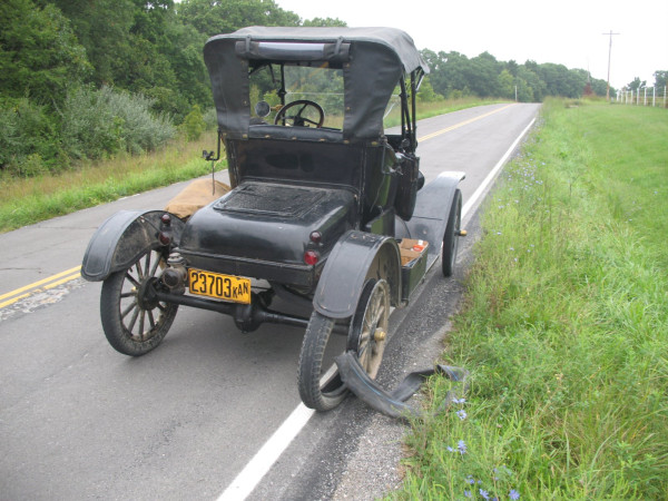

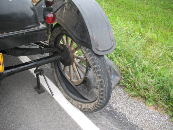

Re: DVD - Clincher tires
Greg, sounds like you want a video on this kind of situation. I recommend not letting your tires get this worn.
Believe it or not, I would much rather change a tire in this situation than with the wheel or rim off the car.

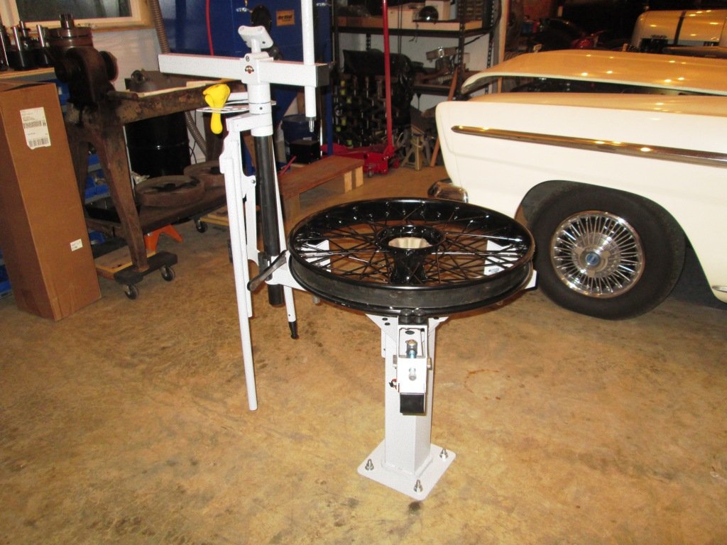

- Posts: 5490
Thus my reason for purchasing this manual machine - old knees don't appreciate the floor anymore !
