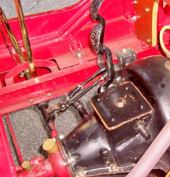

The initial 1909 Model T, up to about serial # 550, used a two-pedal arrangement for gears, the drums inside are similar to much later years, but the two pedal used a long handlever to engage reverse, so two levers, the other lever for emergency brake/clutch. Low pedal worked like later and brake pedal too. (Also up to about serial #2500 the motor was equipped with a water pump and gear driven fan)
Early Two-Lever, Two-Pedal

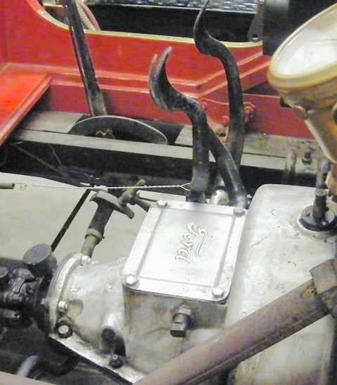

The after #550 or so, the change was made to use 3 pedals, and one hand lever, which continued til end of production.
Later Three pedal, One Lever
