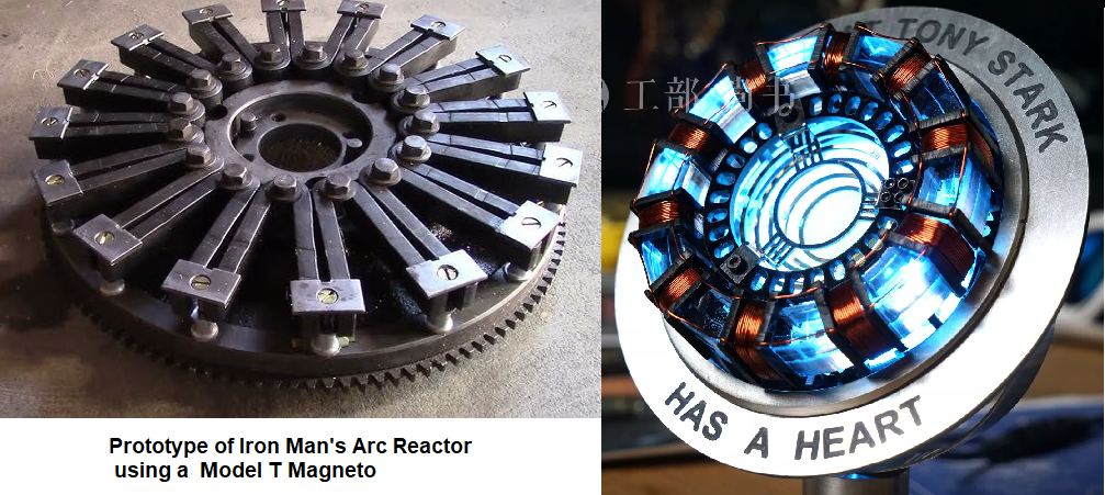

In response to a USB/Bluetooth question. You can show a picture of this and explain that Tony Stark's (Iron Man) first prototype for an "arc reactor". It was not nuclear based but used a smaller version of a Model T Magneto to act as a magnetic shield to repel the shrapnel in his body from entering his vital organs and blood stream. :lol:
