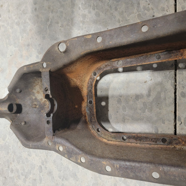

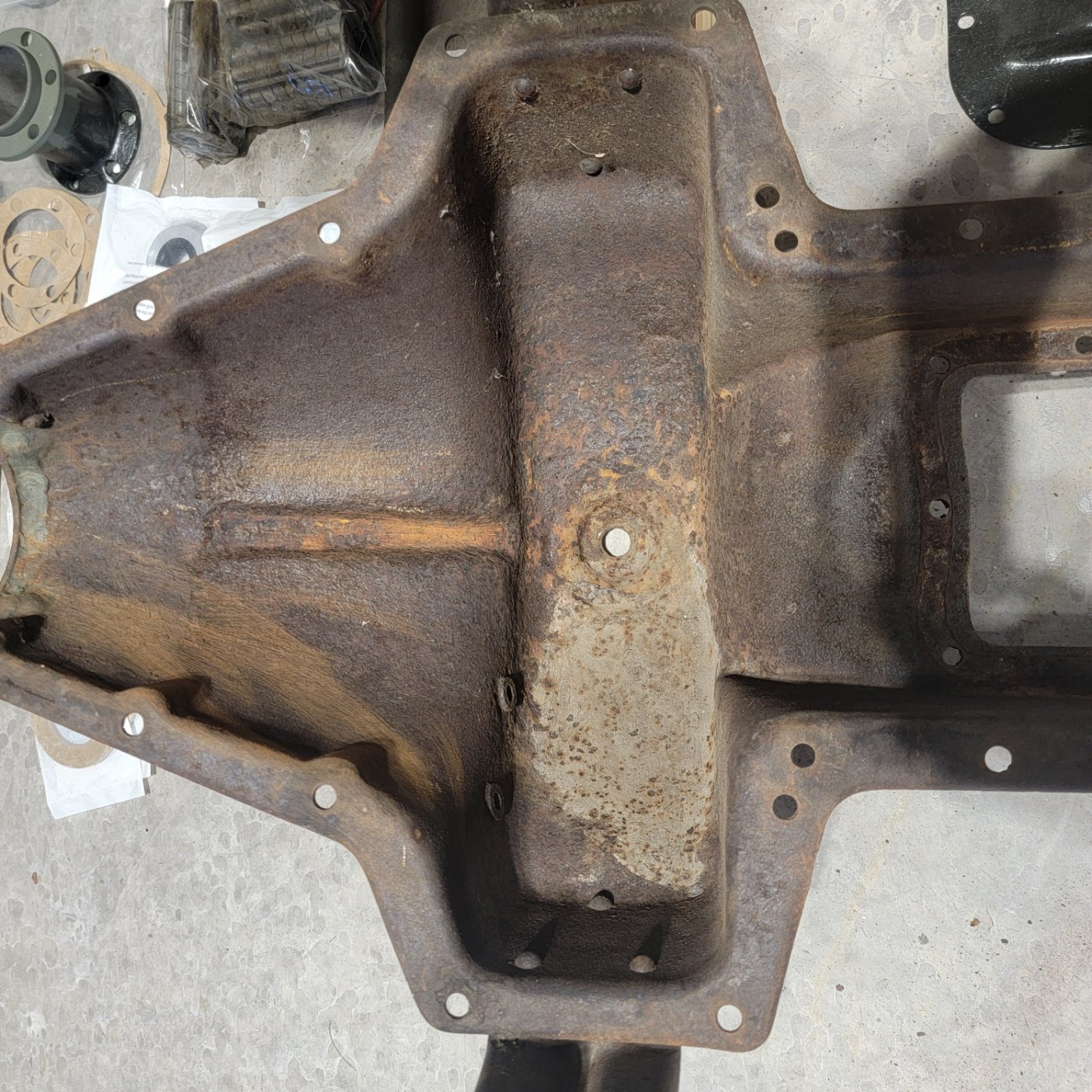

Here are two telling pictures of the pan.

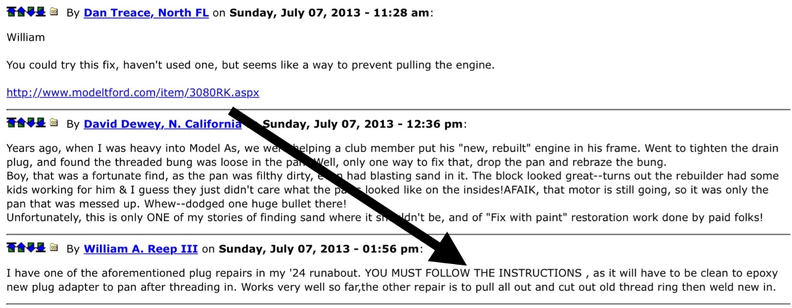

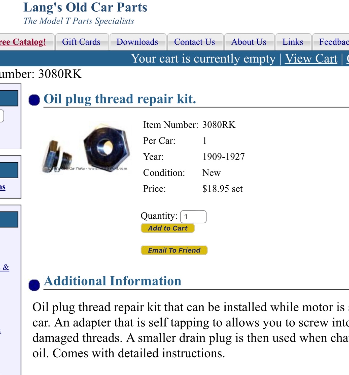

Lang’s makes this adaptor to go into bad threads in the pan drain.

These adapters confuse me a bit. If the threads are bad enough that they can't be used to hold the original drain plug, how will they hold this adapter any better? I understand that the adapter has the ability to recut damaged threads, but if the threads are stripped, no amount of recutting will replace them. Do they maybe recut to some oversize thread?

That pan looks too far gone to salvage. There is one deep rust spot near the flange. By the time the rust was removed there wouldnt be anything left of it. Rust would leach out into the oil and the oil would be seeping out everywhere due to porisity.

Jerry. Haven’t used that plug insert, believe it self taps, but has instructions that are followed. Another member has used it, seems you use epoxy to seal the piece to the pan too.
Thank you Dan. That clears things up a bit.
As to the pan in question, it does look pretty far gone. Before I'd put any time or expense into it, I'd stab at some of those deep pits with an awl to see just how much steel is left. If you can poke a hole in it, there's no sense going any further.
