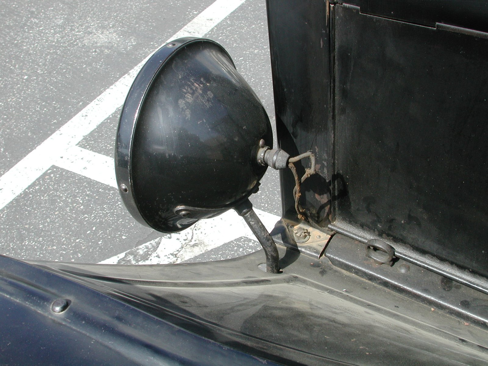

This worked for me, and I think it's "approximately correct". The wire on the right brings magneto current that has passed through the right headlamp and feeds it to the left headlamp. The wire on the left brings current from the left headlamp to ground at the radiator stud.

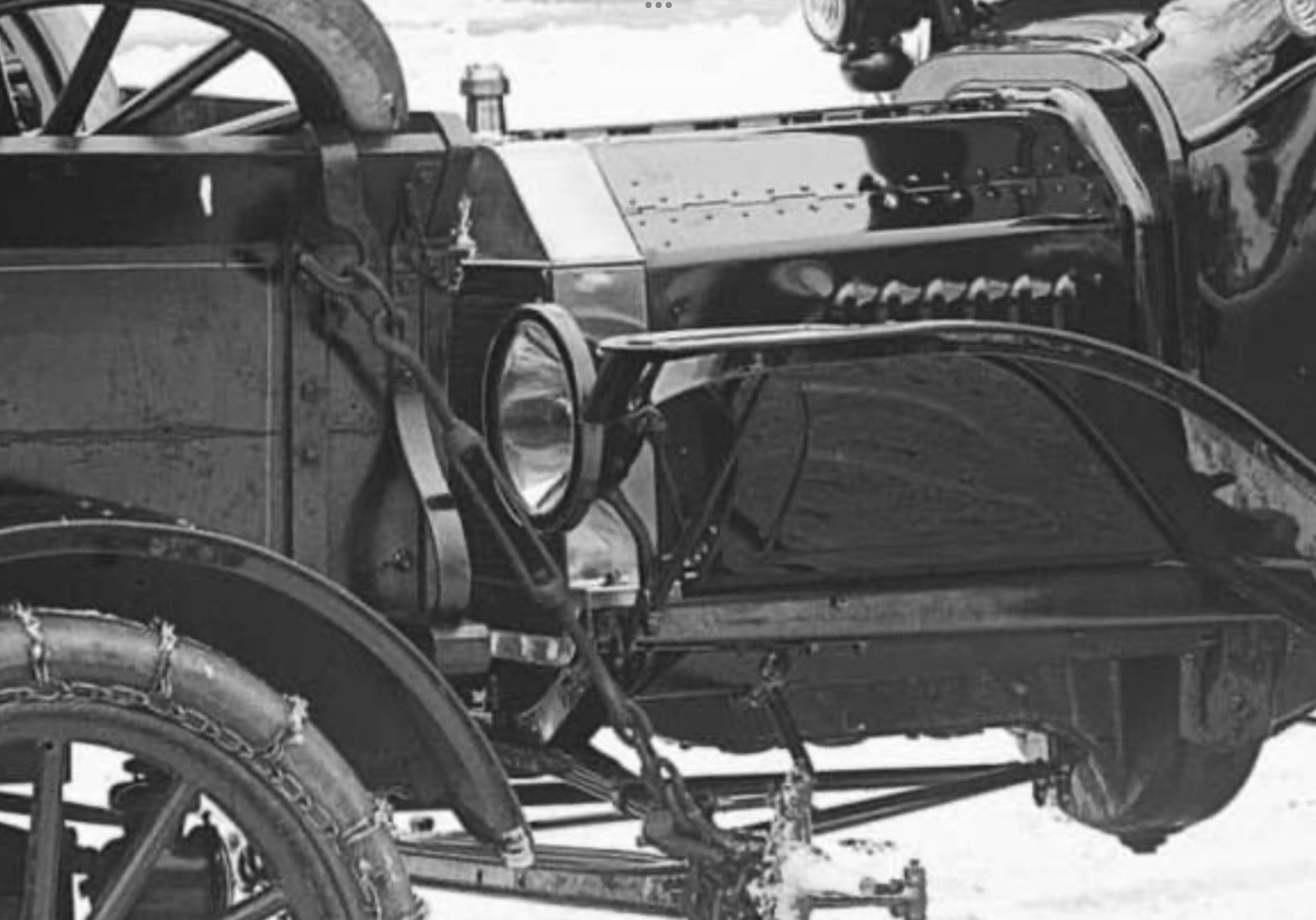

Re: Ground Connection

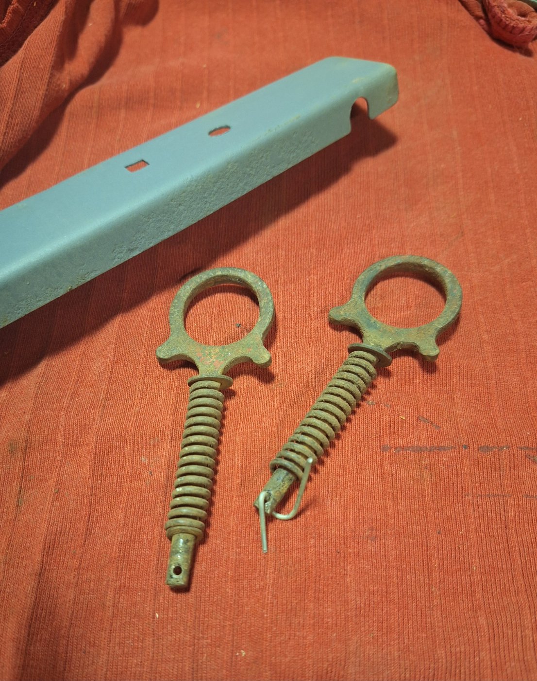

The ground on the Ghost connects to one of the engine pan bolts on the forward frame. I've never questioned it but don't know if it's right. I looked for examples of ground wires to radiator studs but found none.
Here's a 1915-16 Ford factory photo showing a method of towing. The ground is somewhere else on the car, not on the radiator stud.

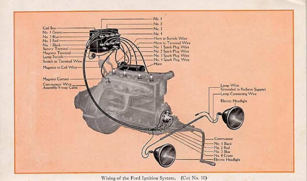

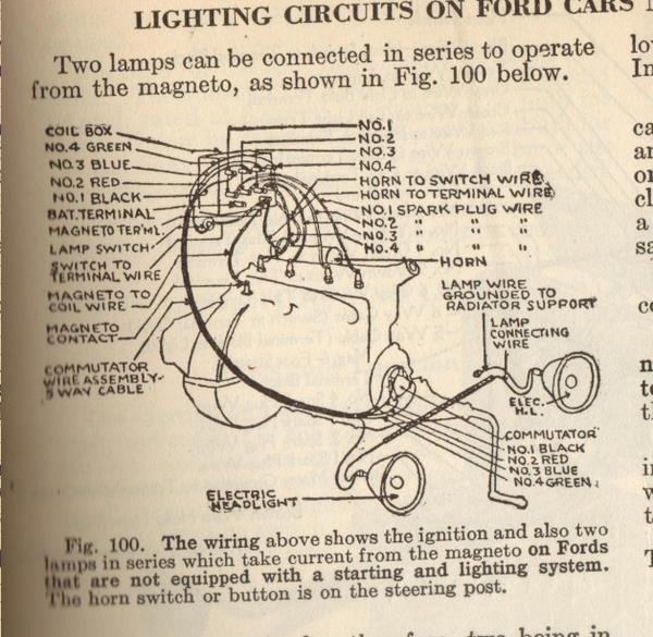

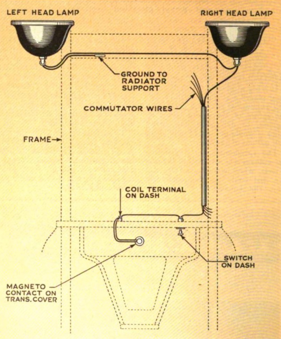

The connection of either the headlight adjusting screw and/or the lamp socket to the headlight bucket should be checked.Original Smith wrote: ↑Mon Oct 21, 2024 1:02 pmI'm trying to assist a friend with a 1915. Is there a separate ground connection for the headlights, or is one of the fender bracket bolts used?
One question: Is the wiring for the lamps in series as the diagram says
Corrected the diagram Ground wire connected to radiator support
- Attachments
- 83807.jpg (89.81 KiB) Viewed 4961 times

Your diagram does not apply to a stock 1915 Ford.
- Posts: 6579
Woops wrong diagram thanks for noticing add the correct one aboveErik Johnson wrote: ↑Tue Oct 22, 2024 2:25 pmFrank:

No questions bout it: The 1921 diagram says the Head Lights are grounded through the lamps.
Larry asked about 1915, not 1921 or later. They're not all the same.
1915 headlamps are wired in series, like old time Christmas tree lights. Both headlamps are powered by the fifth wire in the commutator cable. The current comes directly from the magneto through the light switch on the firewall.

I'm with Erik. My photo above doesn't show it, but the ground wire ends in a ring terminal under the nut that fits the stud. This ALWAYS worked, and NEVER gave me any trouble at all. How many fairies can dance on the head of a pin?

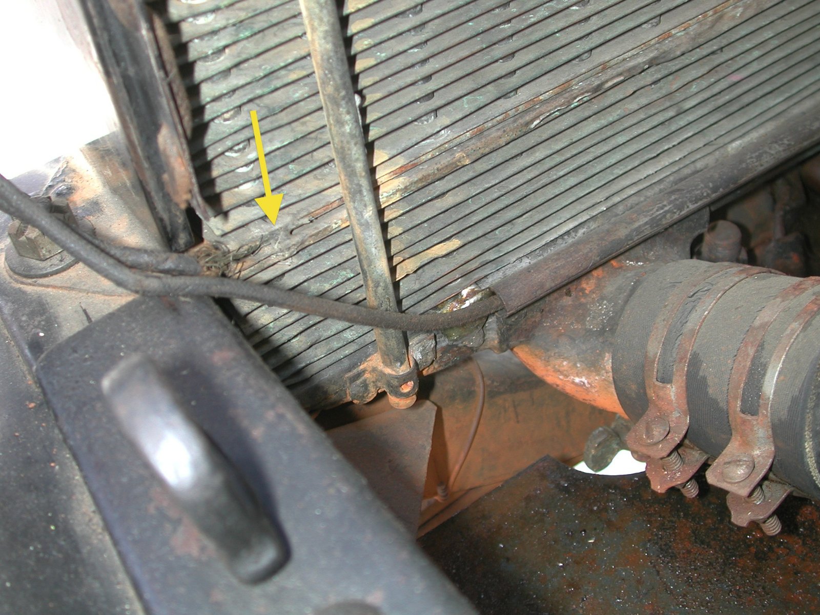

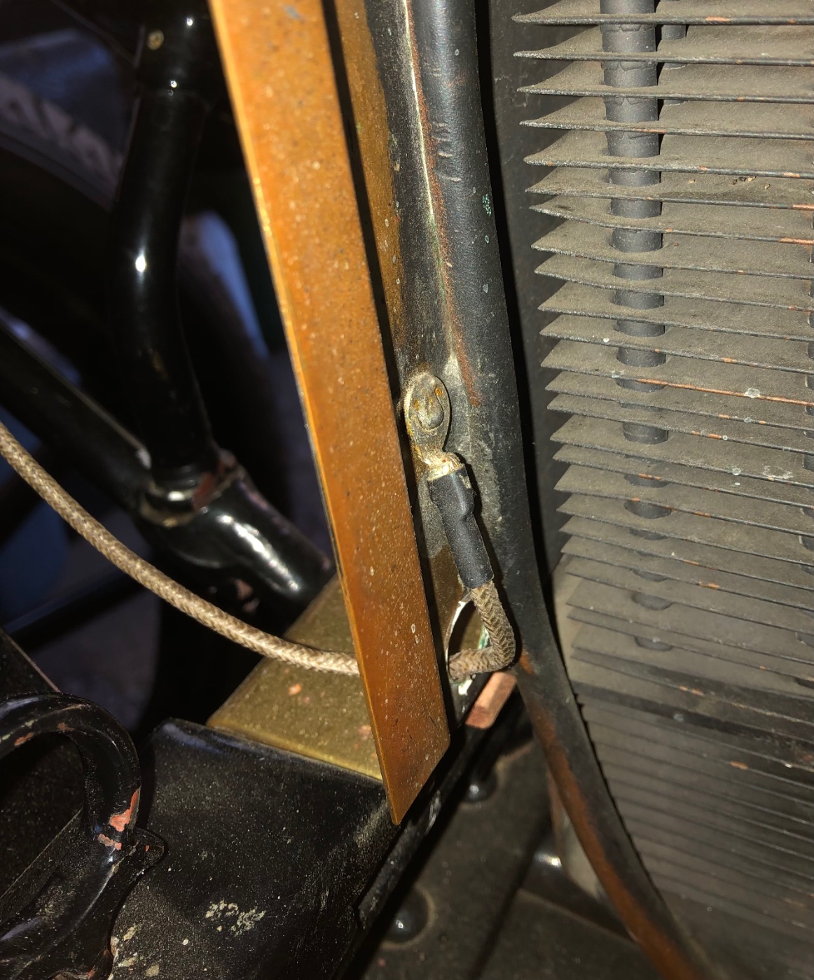

Here are photos of the "Rip Van Winkle" 1917 touring - click on photos to enlarge. This car has a June 1917 motor number and was most likely assembled in the downtown Minneapolis plant.
The wire is grounded to the radiator support strap. The yellow arrow points to solder blob which actually extends downward past the support strap and onto two or three fins below.
Why Ford Motor Company engineers decided that the headlight should be grounded in this manner is a mystery.
- Posts: 5585
Boy, if that's not the best documentation ever !!! Thanks for posting that photo, Erik.

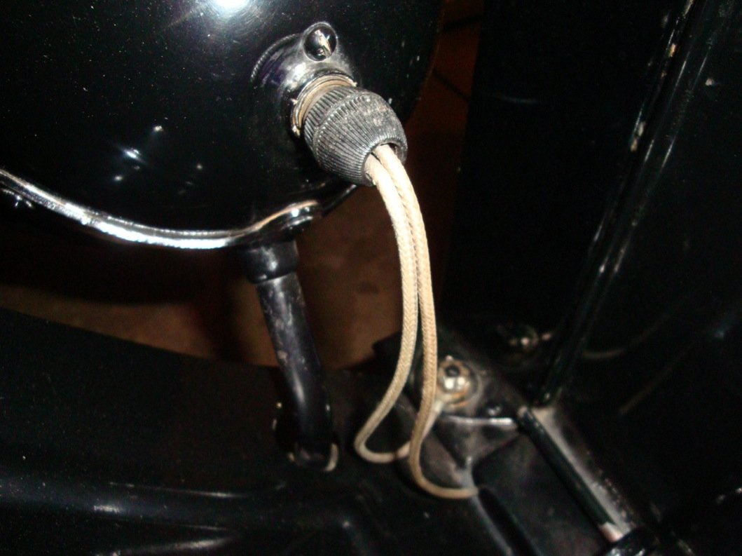

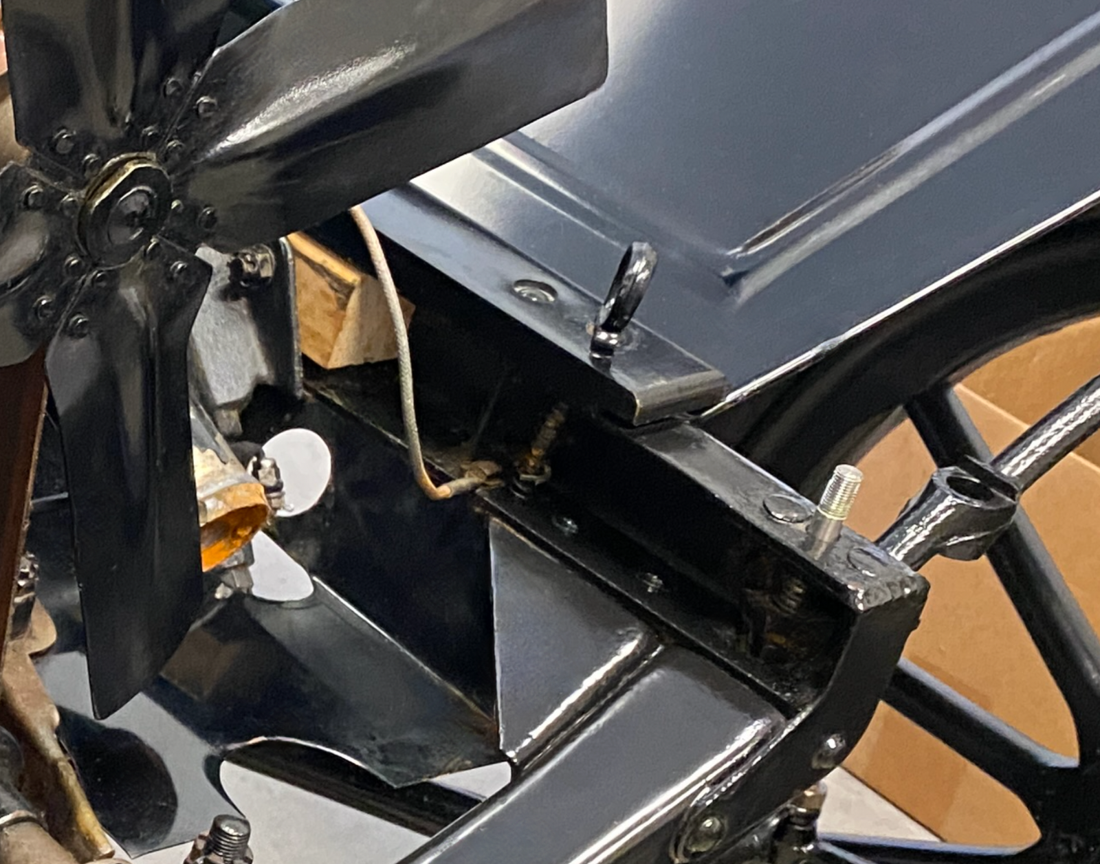

My 1915 Touring headlight ground wire. Note: cross tube and wire not shown. Needs to be repaired. I don’t know this to be original. For your reference.

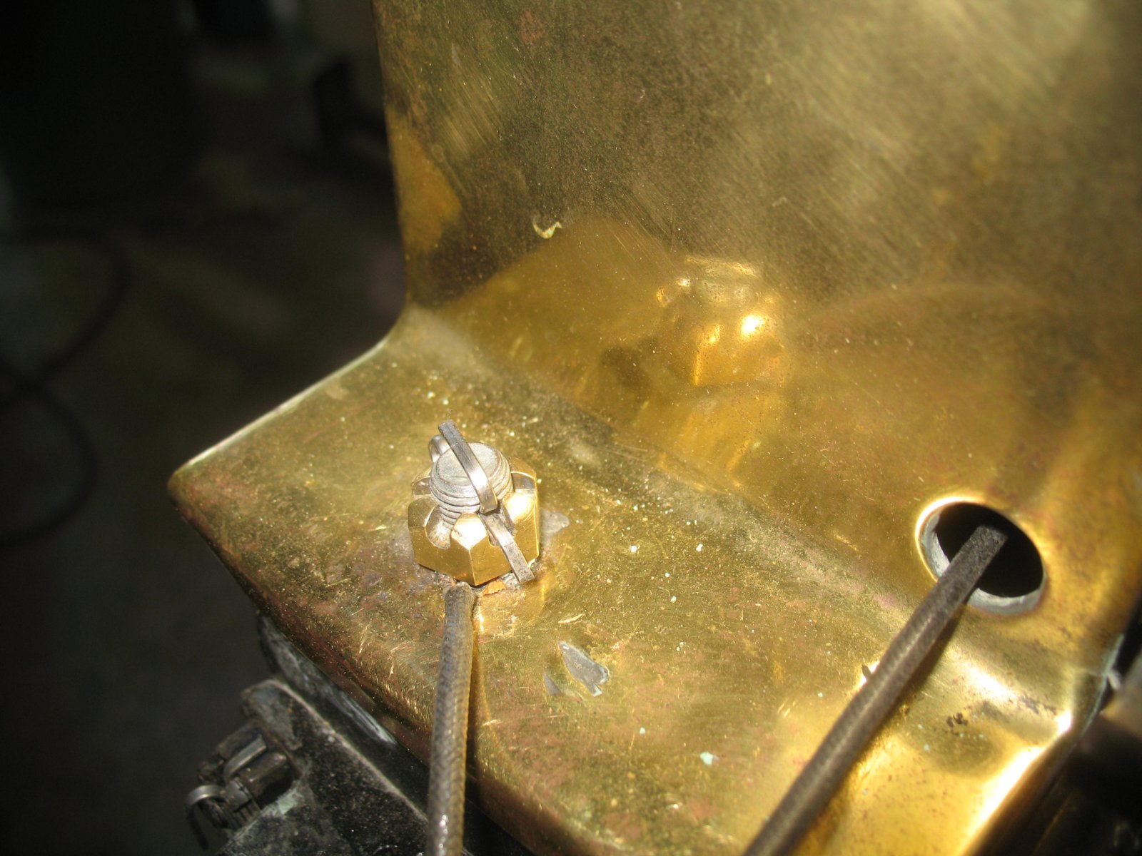

George Mills
- Posts: 646
- Last Name: Mills
The family ‘15 has always been thought to be mostly original so I had the current steward the youngest son take a look. None of the above, whatever…no solder stains anywhere on the brass…the ‘ground’ wire comes back thru the clash strip grommet, runs under the clash strip and pops out by the hood former where the wire seats under the nut holding the body bracket. Just sayin…while it has probably changed from as built according to the above post this one was parked and locked in the back of a Bell Tel shop in the late teens, was untouched until the mid 50’s, and was pretty much used as static display from when it was until I bought in 95. As my son said ‘option 6??’
