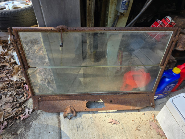

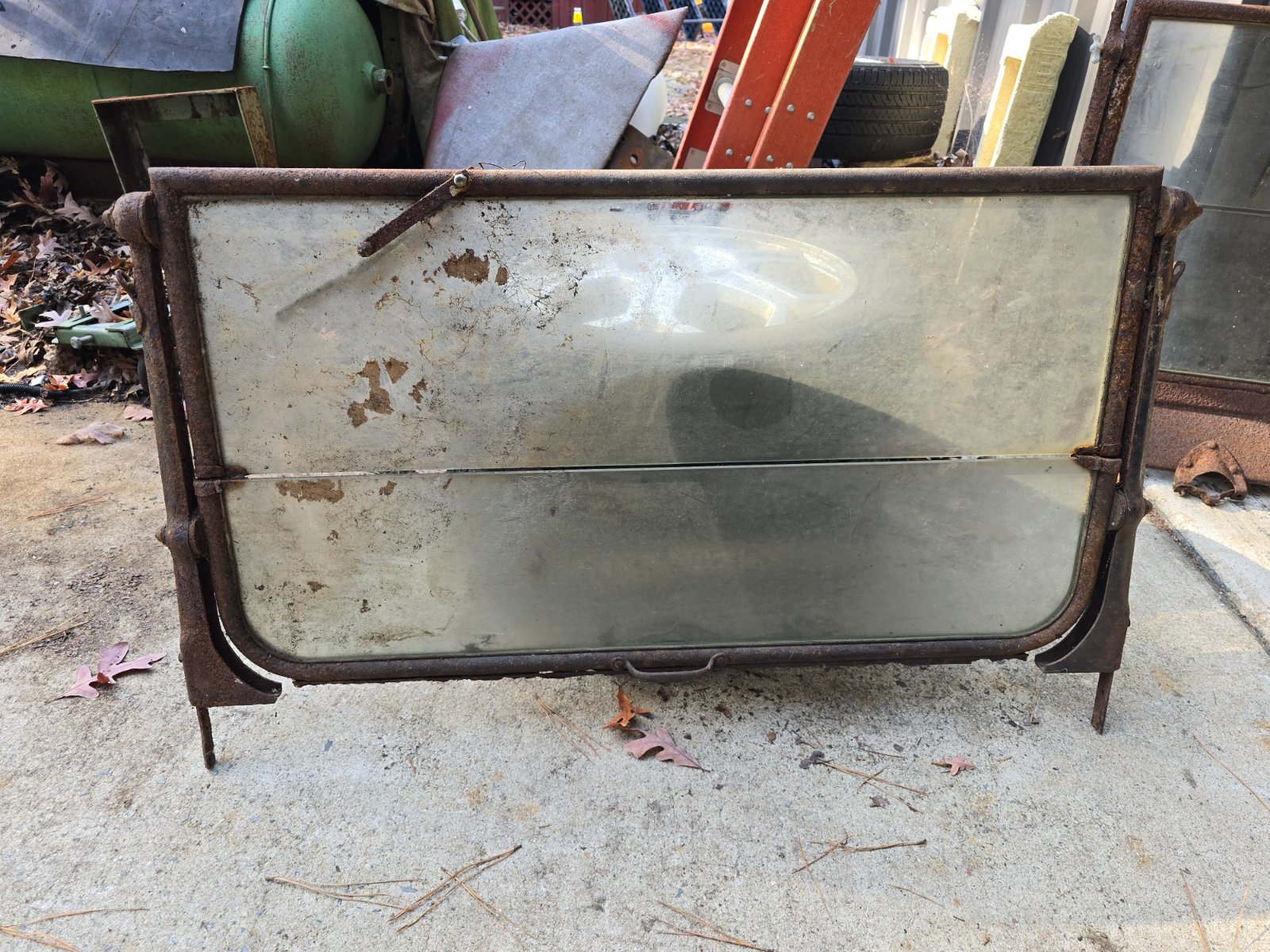

Can someone tell me the years of these windshields

Bottom picture Looks similar to 23-25 touring or roadster

…and that upper frame could use a little bondo :lol:

Bottom picture. Steering column support bracket started in 24. Windshield wiper and rear view mirror available starting in September 24. I'm leaning to its a 25.
