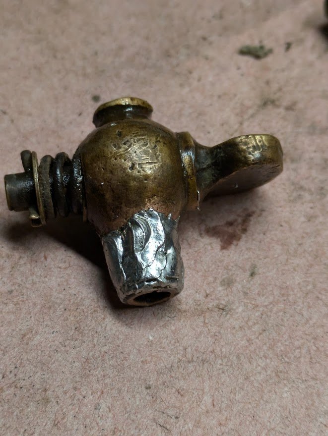

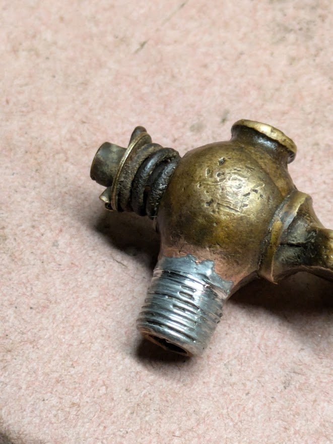

Again thanks for the suggestions. I fixed the problem by soldering the petcock. Three times. First time first level of solder wasn't thick enough.
The petcock spun.
Second time, layer of solder was too thick
The third time worked since I removed some solder. I fitted the petcock and it was tight, but I decided that a little JB Weld was extra insurance.

Posts: 4481
Re: radiator drain petcock is loose FIXED!
Post by Jerry VanOoteghem » Wed Oct 30, 2024 11:50 am
NY John T wrote:
Wed Oct 30, 2024 9:44 am
Hi all,
The petcock spun.
John
Nice work! Thanks for the update!
